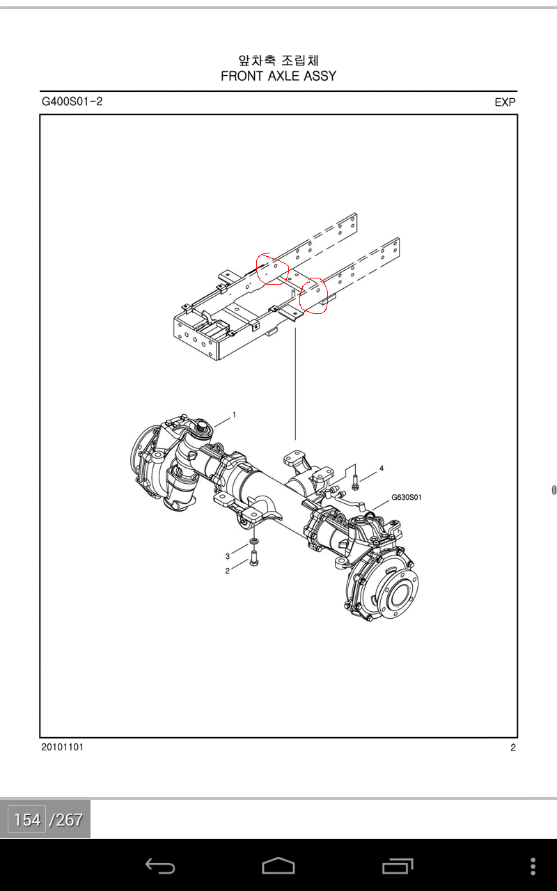

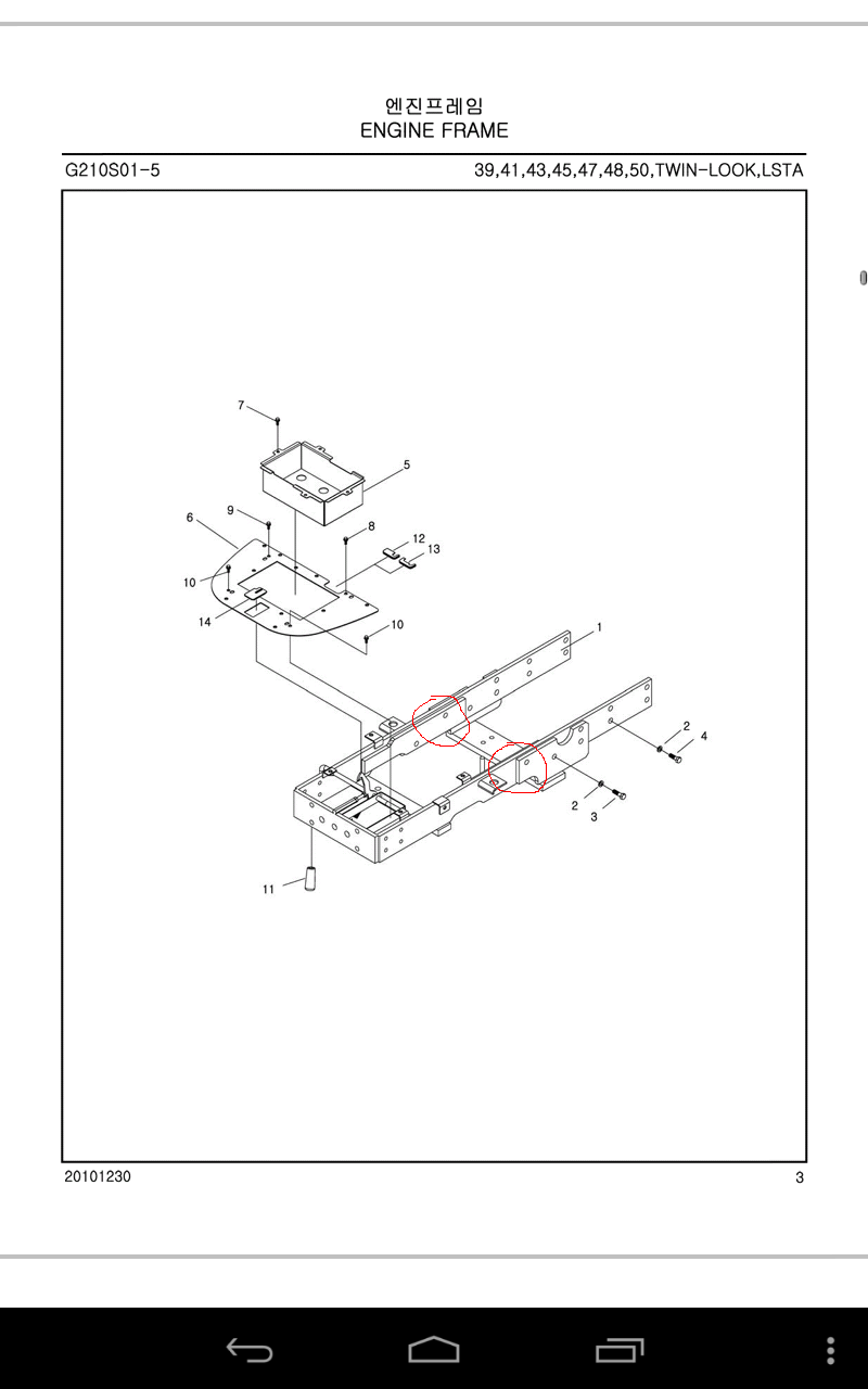

   / LS Frame Issue Video #103
Here is a visual of the differences.
This is the R3039 subframe:
This the the R4041 subframe (same as R4047):
   / LS Frame Issue Video #104
Great Post!!!!
Wow, 2 pictures are worth a thousand words. I hope LS stands up and reinforces all the 3039 frames, it clearly is a design defect which shouldn't be the responsibility of the current owners, no matter how old the tractors are. :)

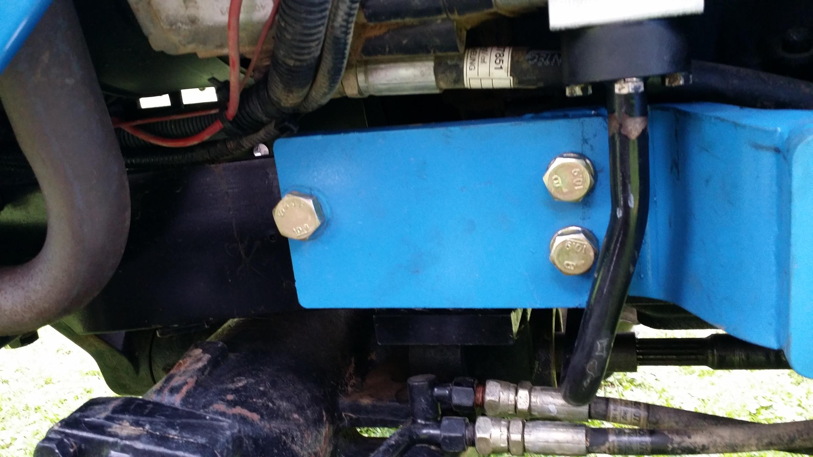

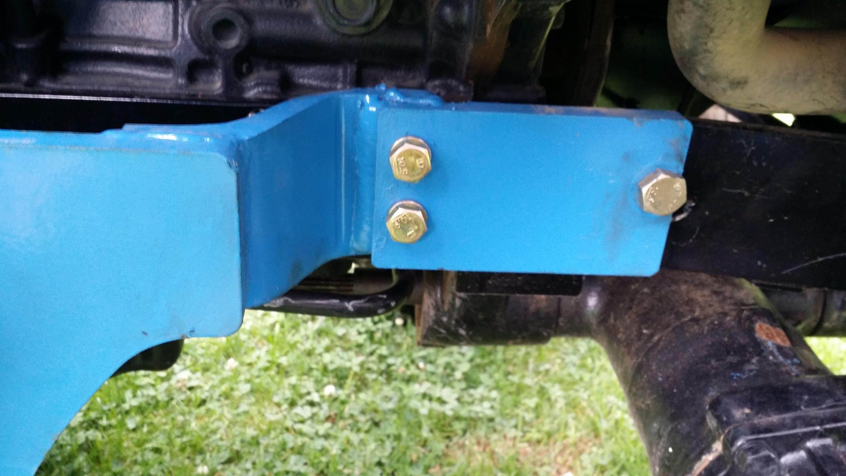

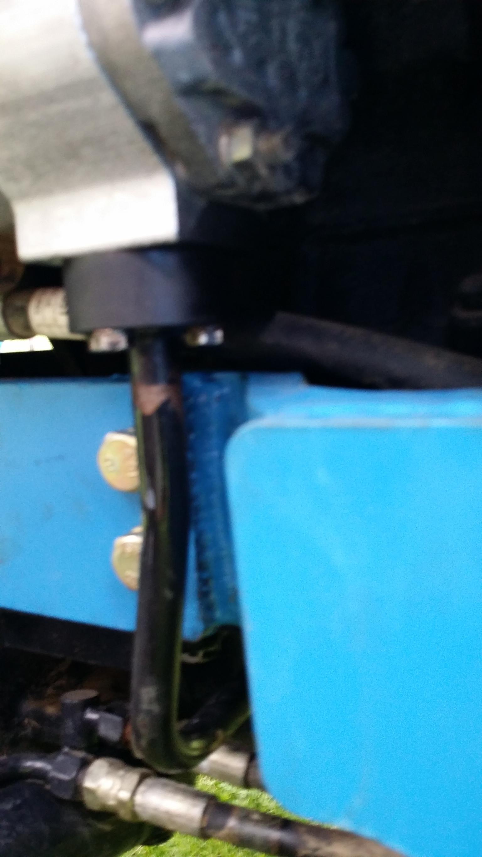

   / LS Frame Issue Video #108
Verdict is in....
They picked up my tractor early yestarday - sadly it sat on their lot all day, and didnt go in the shop until this morning :confused2: bummed, since I could have used it!
Anyway, they delivered it back tonight about 4:30!
When I stopped in yesterday afternoon to check on it, I was able to skim some more info. Seems my tractor had the latest frame design upgrade already. Not good since I managed to break it! But he said the new loader brackets should solve the issue. He said (and is evident from what I see now) that they bolt the new brackets in place, then tack weld them to the existing loader frame. Remove entire loader frame, and weld it properly. (see pictures).
Now - my service guy agrees with my concept, that its likely there was something metallurgical wrong with the original frame. Something that was maybe a 'bad batch' issue. He said he has only see one other 'new' frame broken, and it was exactly the same as mine, crack starting right at the edge of the weld like that. From what I understood, the older frames exhibited a different break....
