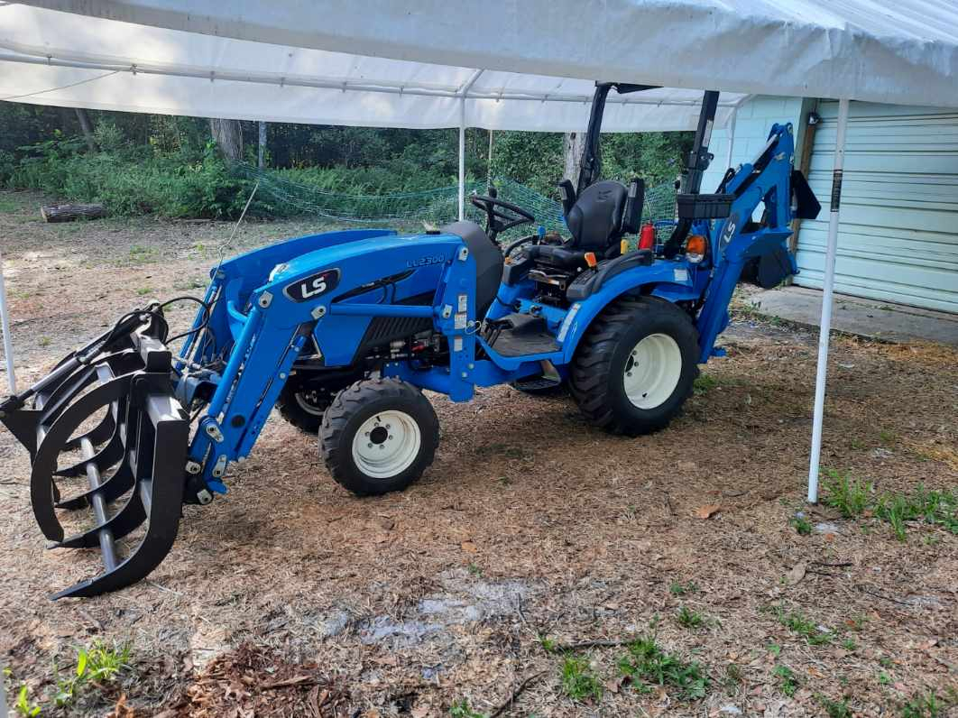

/ LS Grapple #23
I had the dealer install my 60" grapple with the 3rd function kit I paid just under $1500.00 It has been great moving logs and cut up down tree trash and ripping up roots.

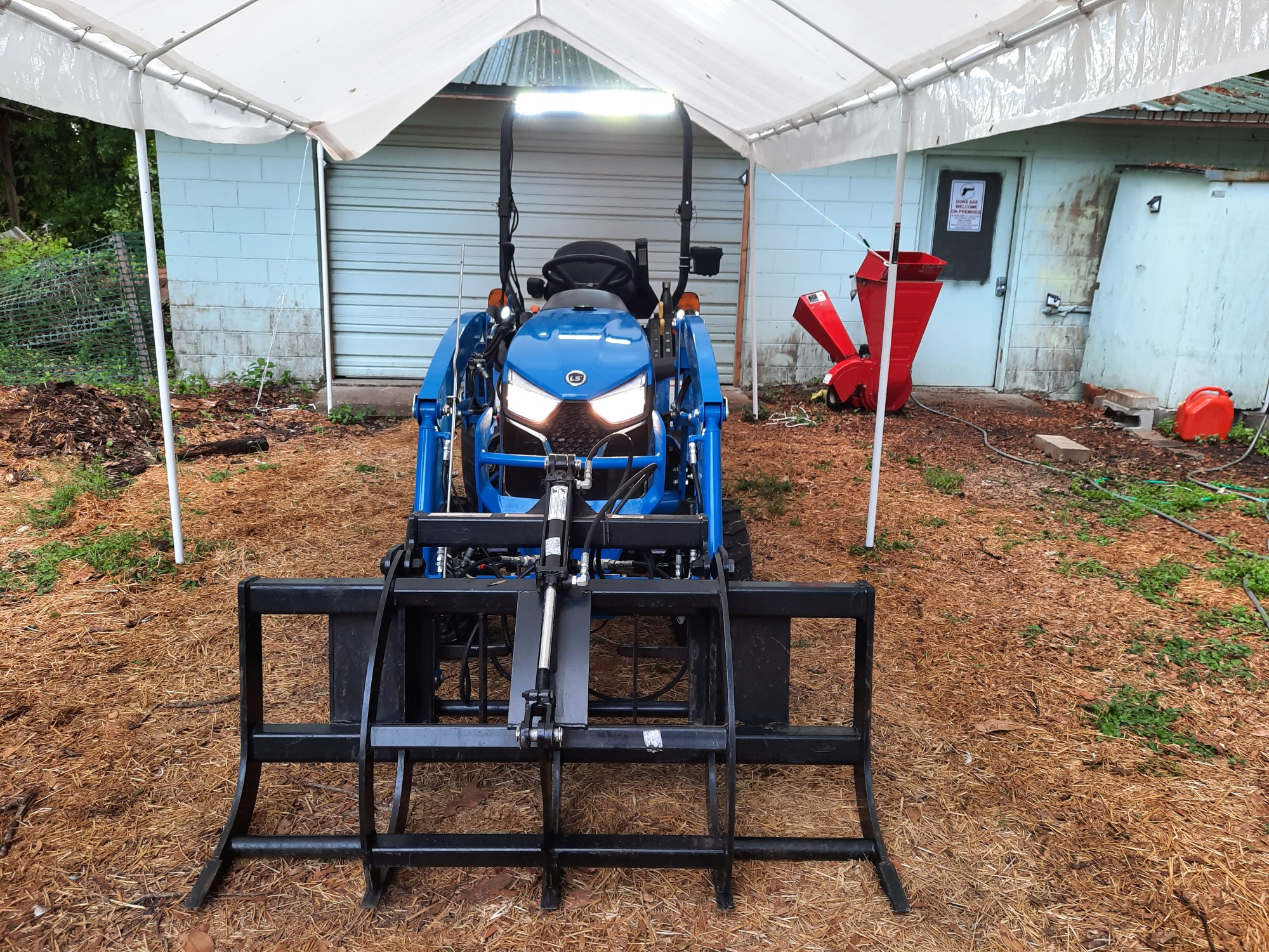

/ LS Grapple #25
I picked the Yitamotor 32" LED light bars, IP68 rated (Devices backed by an international standard rating of IP68 are deemed fit enough to withstand dust, dirt and sand, and are resistant to submersion up to a maximum depth of 1.5m underwater for up to thirty minutes ) with switch & harness. It has a 3 year Warranty. The only thing I had to do is extend the harness a few feet to mount on the ropes.
The price was great too. 32INCH 180W Led Light Bar Spot Flood Combo Boat Ford Offroad Truck UTE ATV 34'' | eBay
It makes the night look like day time using the backhoe in the rear or bucket or grapple in the front. Hope this helps.
/ LS Grapple #26
Thanks, how did the mount work out around the ROPS?

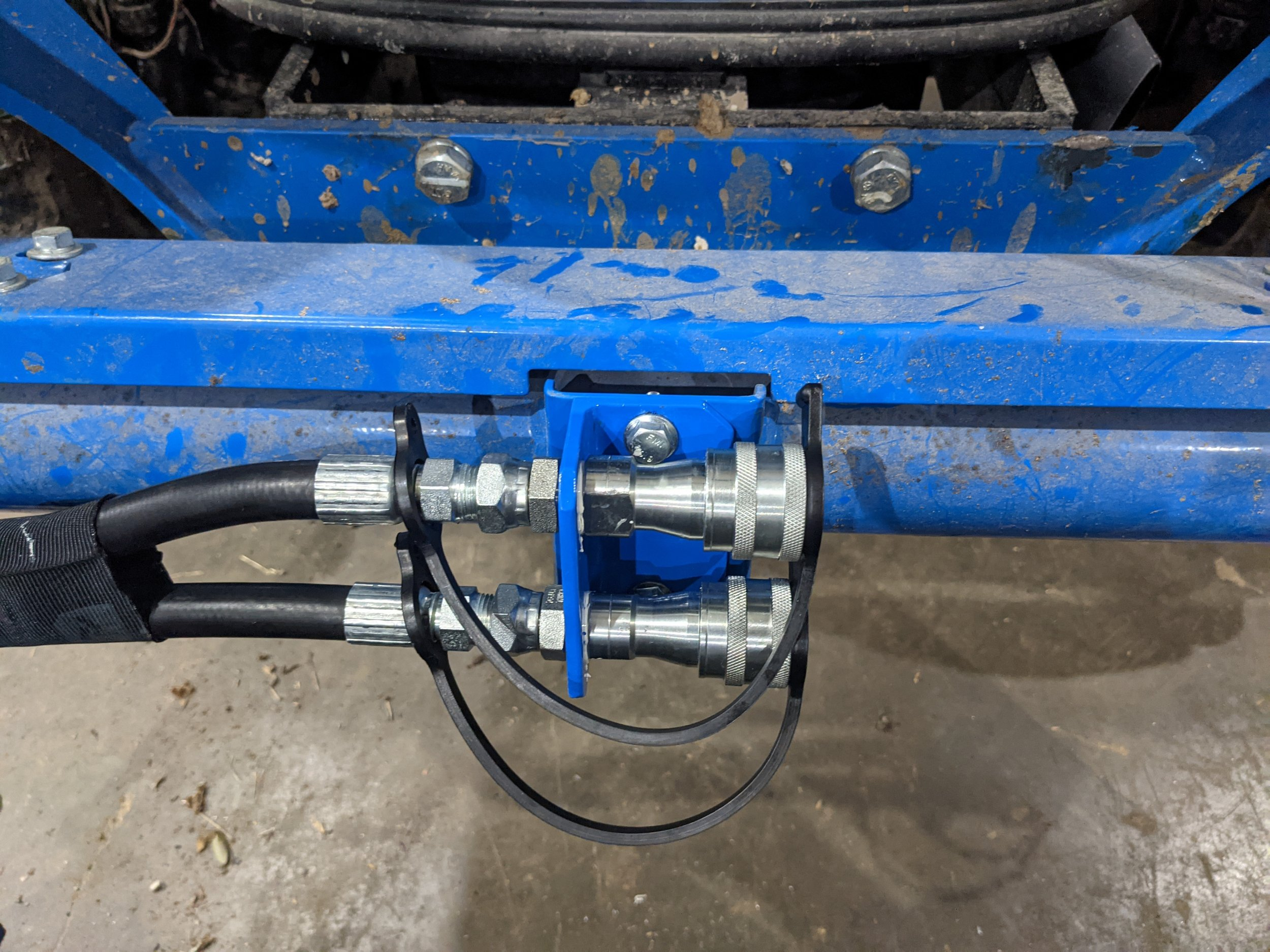

/ LS Grapple #30
Made my own third function using one of my remotes for the circuits. It works extremely well. Built the brackets for the hoses to make it look as factory as possible.
/ LS Grapple #31
All looks hood but have you hooked up to this yet? You may find it's too close to center and needs to be offset back some so that the connecting hoses can have a better arc.
/ LS Grapple #32
Been using it like this for 6 months. Works great with no problems of hoses getting in the way.

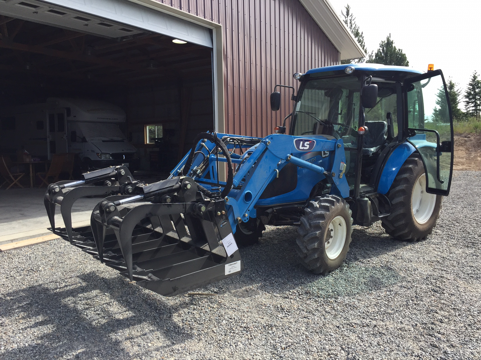

/ LS Grapple #39
I know that this will cause some negative commentary regarding quality of steel, etc. but I’m going to go ahead and put it out there- I bought a package pallet fork/ dual lid grapple from Titan. Iirc it was around $1800 w/ free shipping to Spokane.
Have found the Titan more than satisfactory in terms of strength and quality of construction (welds, pins, hydraulics, lube points) for my needs. Have moved around some pretty stout logs and such. Yes, it is heavier than many of similar size ( likely because of the use of a lower strength steel) but that hasn’t been a limiting factor to date.View attachment 690671
I live in Deer Park and considering the Titan grapple for a JD3033 but am going back and forth because of stuff I see on line. Price is WAAY better than others. Still happy with yours?
/ LS Grapple #40
Yes-still plenty happy with it. Does everything ask of it.
