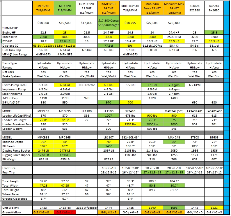

Are you buying it with plans to sell it after your target projects are finished? If so, the Kubota resell should be considered heavily.
If your buying it to keep, I sure would be hard pressed to buy the Kubota over the LS that out performs the Kubota and does it at a lower cost.
My researching SCUT units tells me that the LS and Massey Ferguson GC17XX are the most popular "non big three" units out there, but then New Holland is considered one of the big three in the SCUT/CUT category... and LS is the New Holland, New Holland Boomers and such are re-branded LS units.
My opinion, if it's a keeper.... save $2000 and buy the LS that will perform better than the Kubota. If it's not a keeper, you need to weigh that out and do what you think makes sense.

Great research.
I am on the fence about either situations. I want to say keep but what if I want to upgrade in 8years from know what would the LS resale look like.
I know the 8year old bx23 Kubota are around 10k. That's 8k in depreciation. How about the LS 8 years from now?
