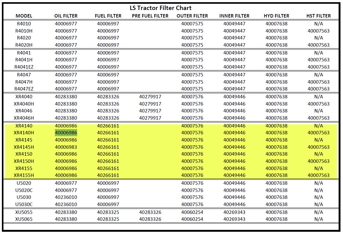

Ok..... So for us that have the newer XR4100 series engines, I've done a ton for searching and cross referencing online. The LS part number for the newer 3cyl turbo engines is 40006986. That cross references to a Case # of MT40006986 which we can get at Messick's for $17 which is for the Boomer 40 (2017 version with the same engine as our XR4100 series)

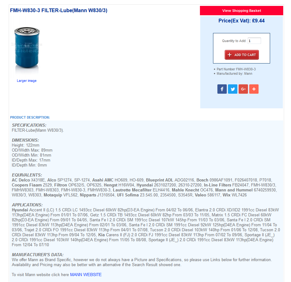

That same number cross references to a bunch of other part numbers mostly for Kia's and Hyundai's with a MANN Filter part Number W830/3 Olejovy filtr MANN-FILTER W 83�/3 Autodily PEMA
That number in turn cross references to a NAPA Gold part number of 107426 Oil Filter (Gold) FIL 1�7426 | Buy Online - NAPA Auto Parts

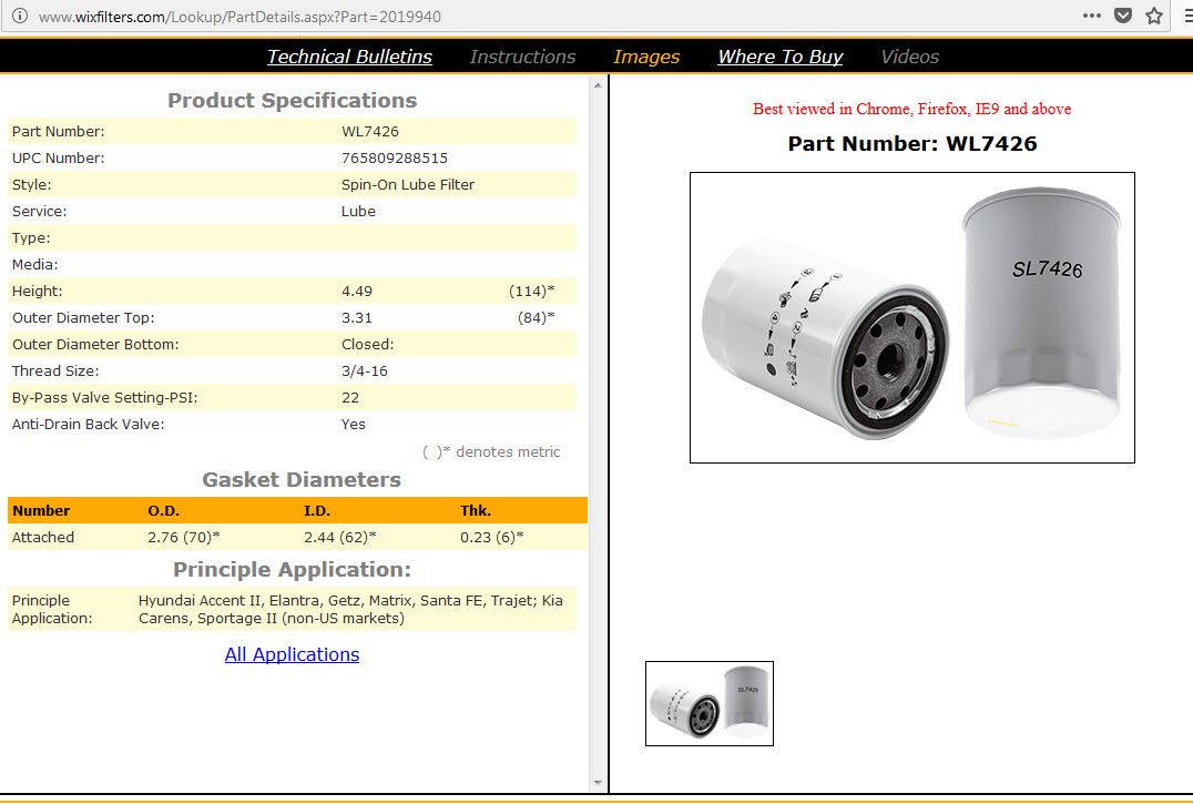

which in turn goes to a Wix part number of WL7426
which I was able to find at Rockauto for $6.40 WIX WL7426 Oil Filter | RockAuto
2017-12-12_15-05-14.jpg2017-12-12_15-30-24.jpg2017-12-12_14-49-50.png2017-12-12_14-58-05.jpg
Your Welcome.
