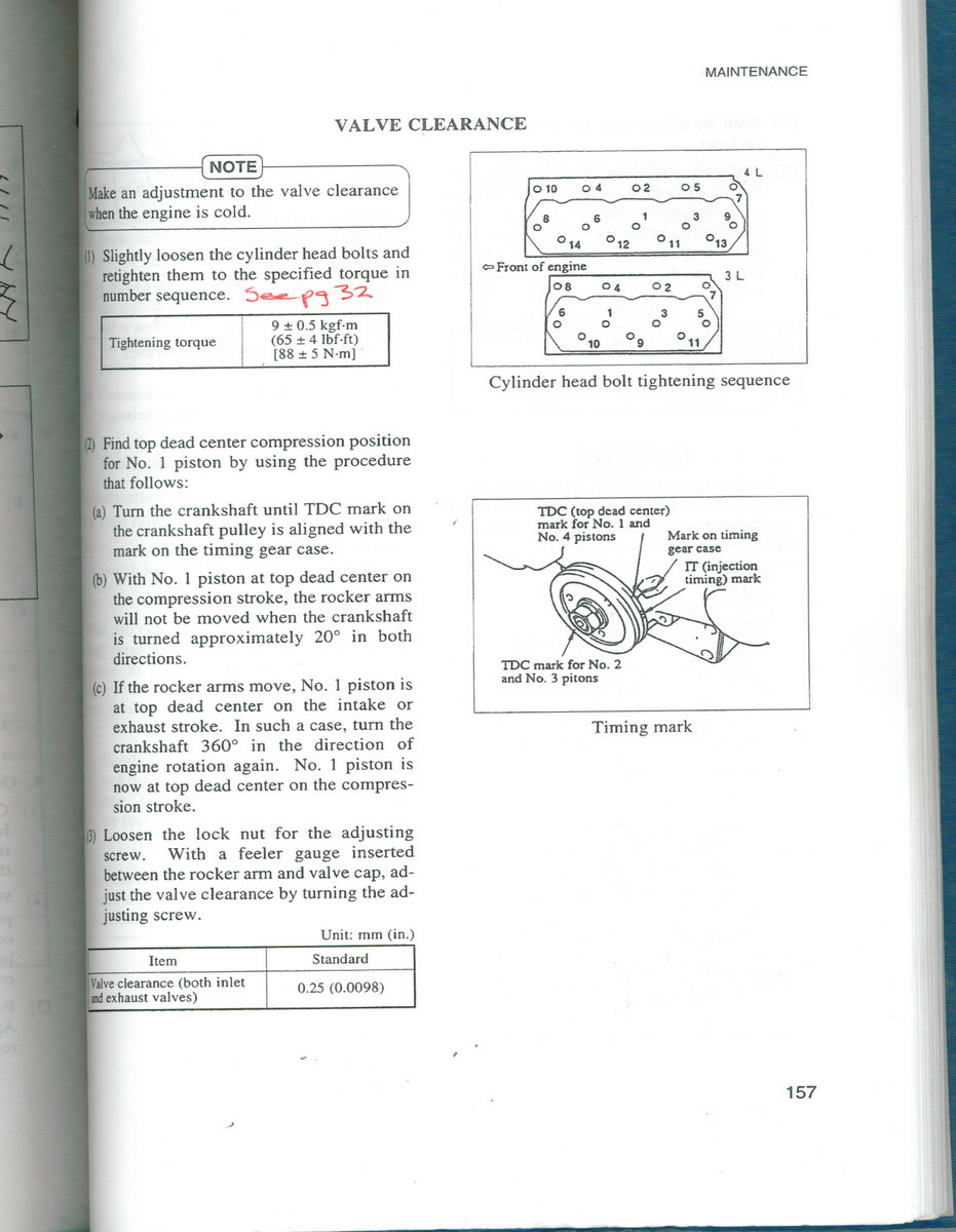

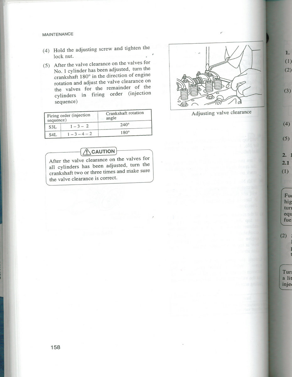

According to my manual the valves are supposed to adjusted on the S3010 as part of the 50 hour service. Here are the instructions from the service manual if you are a DIYer:
I really like the "wrench in the sleeve" 3rd-hand trick on the second page.:laughing:
