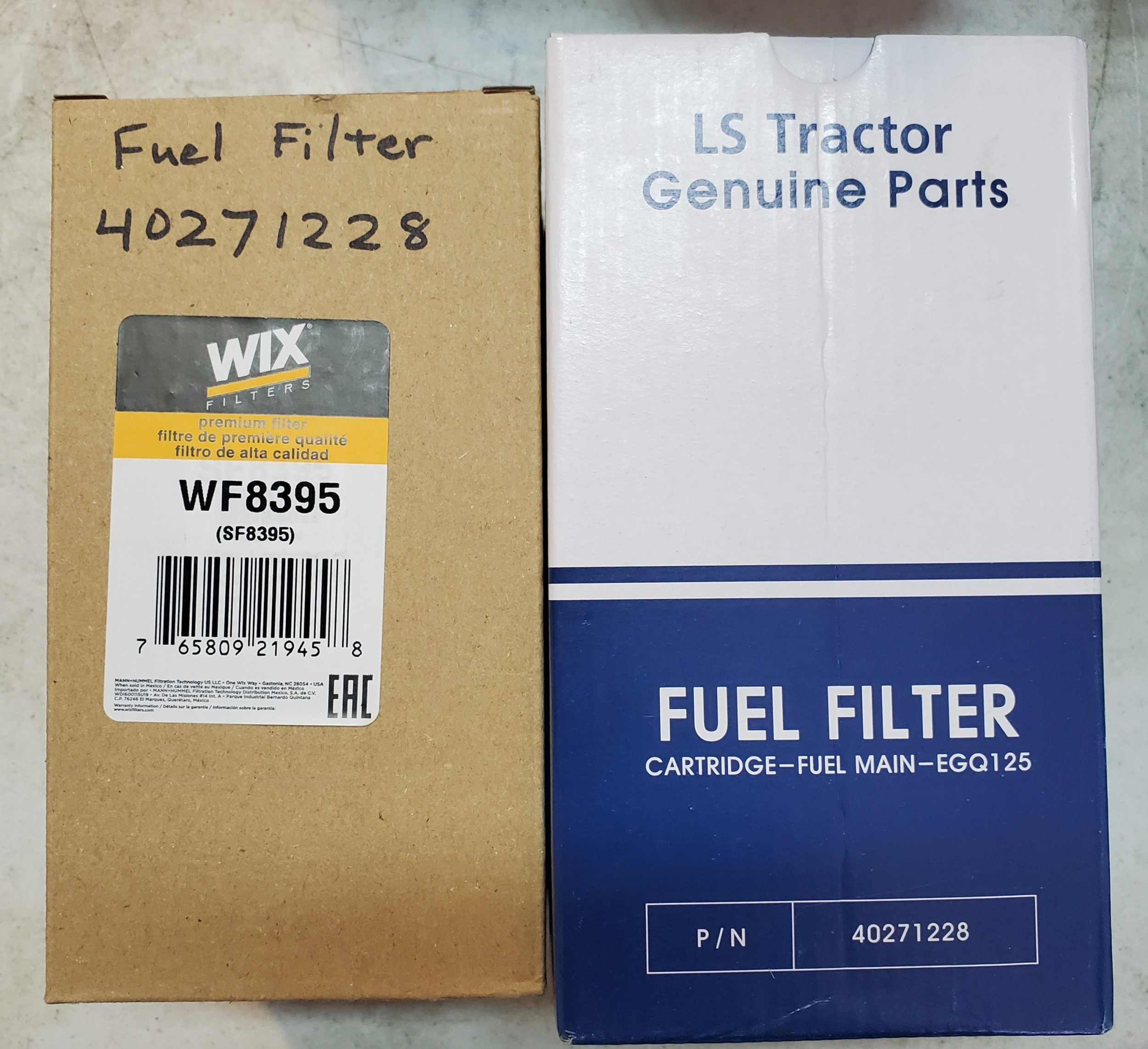

might be a dumb comment, but how does the plug come out of the replacement filter? Maybe fiddle with that one, not the live one, if you haven't though of that. And I'm interested as mine is coming due and might replace it anyway to see if it helps the regen issue.
Dealer want's "The price is $77.48. PN# 40271228" and a WIX WF8395 is $19.42 on Amazon and $13.99 at the local O'Reilly auto parts store, so I'm interested if it fits lol
   / LS Tractor Oil, Gas, & Air Filter Information #403
The LS Fuel Filter 40271228 water-in-fuel-sensor at the bottom of the fuel filter is threaded in.
The WIX version comes with a black screw in plug/drainer as seen below. It did screw right into the LS filter perfectly. The top side of the WIX looks to be a thread match as well.
The LS filter does feel heavier.
   / LS Tractor Oil, Gas, & Air Filter Information #404
It is a photo illusion or is the wix filter diameter a good bit smaller? The main body seems the same, but the mating surface looks a lot smaller in the picture, might be because the stock is closer to the lens.
Defiantly shorter which could account for the weight difference.

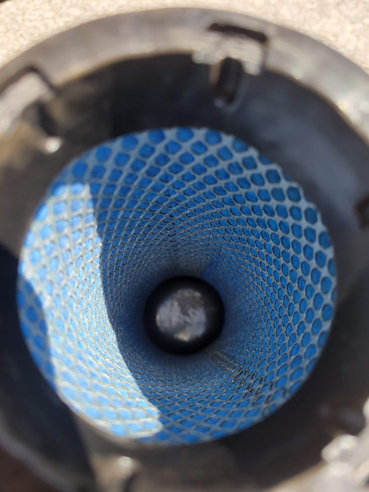

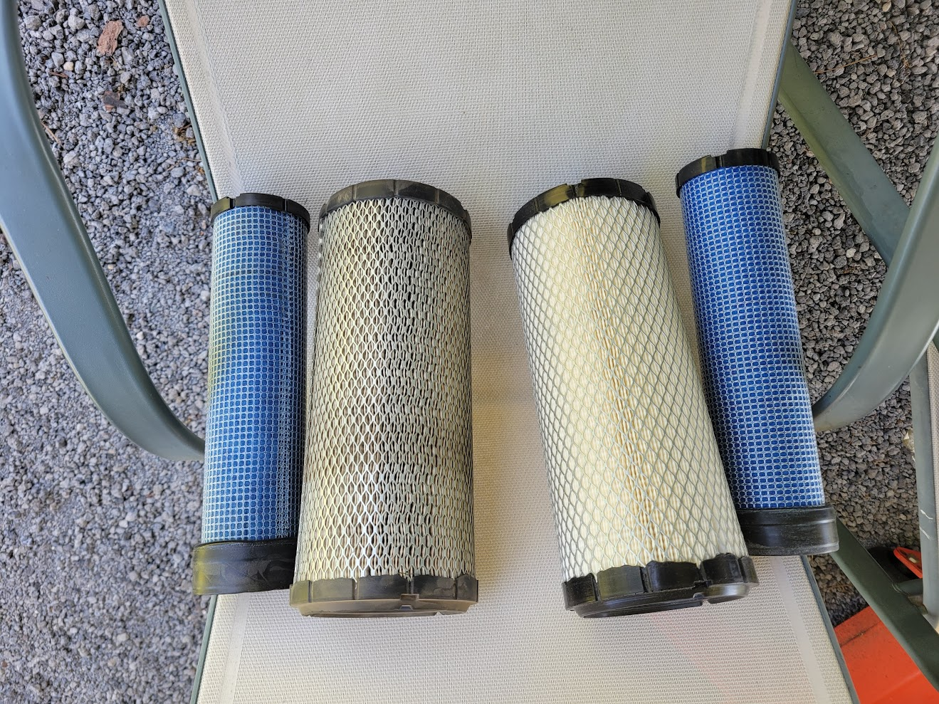

508 hours and still pretty decent. I blow out the outer one regularly from inside out.
Replaced with same Donaldson P822768 & P822769 Air Filter Set as stock.
https://www.amazon.com/dp/B01IFB4JMA was $58 when I ordered them.
Pics inside old filters
