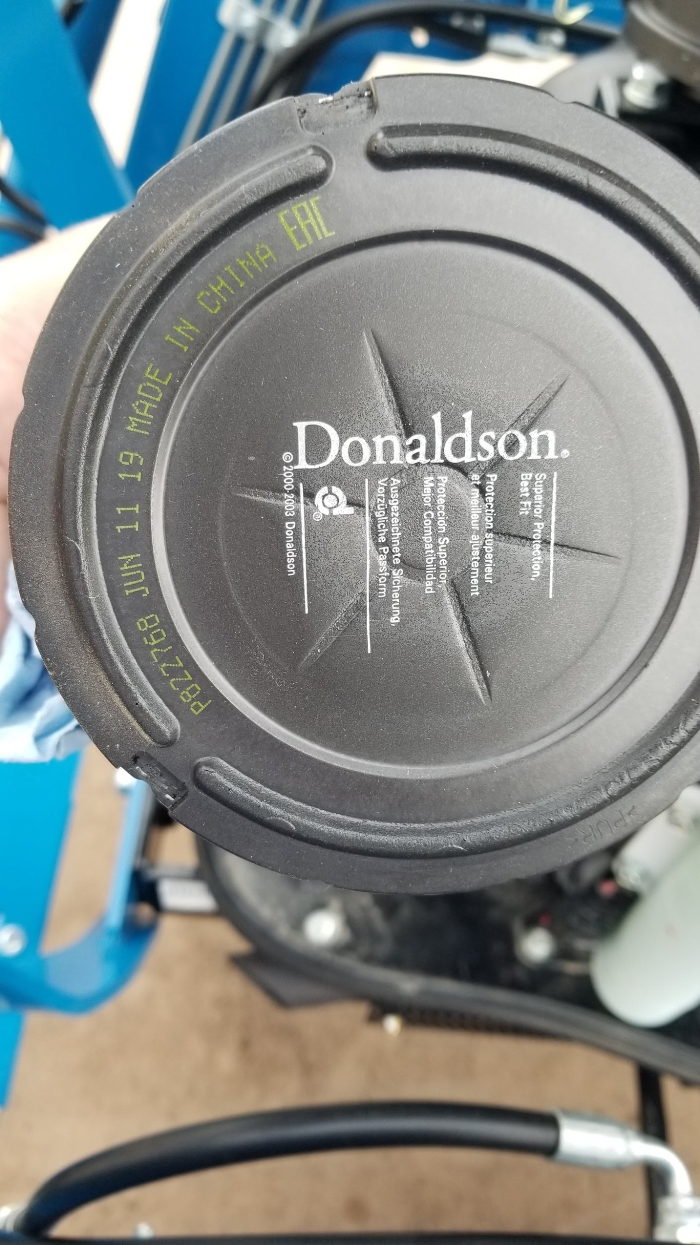

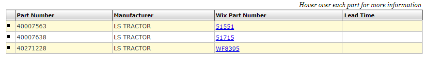

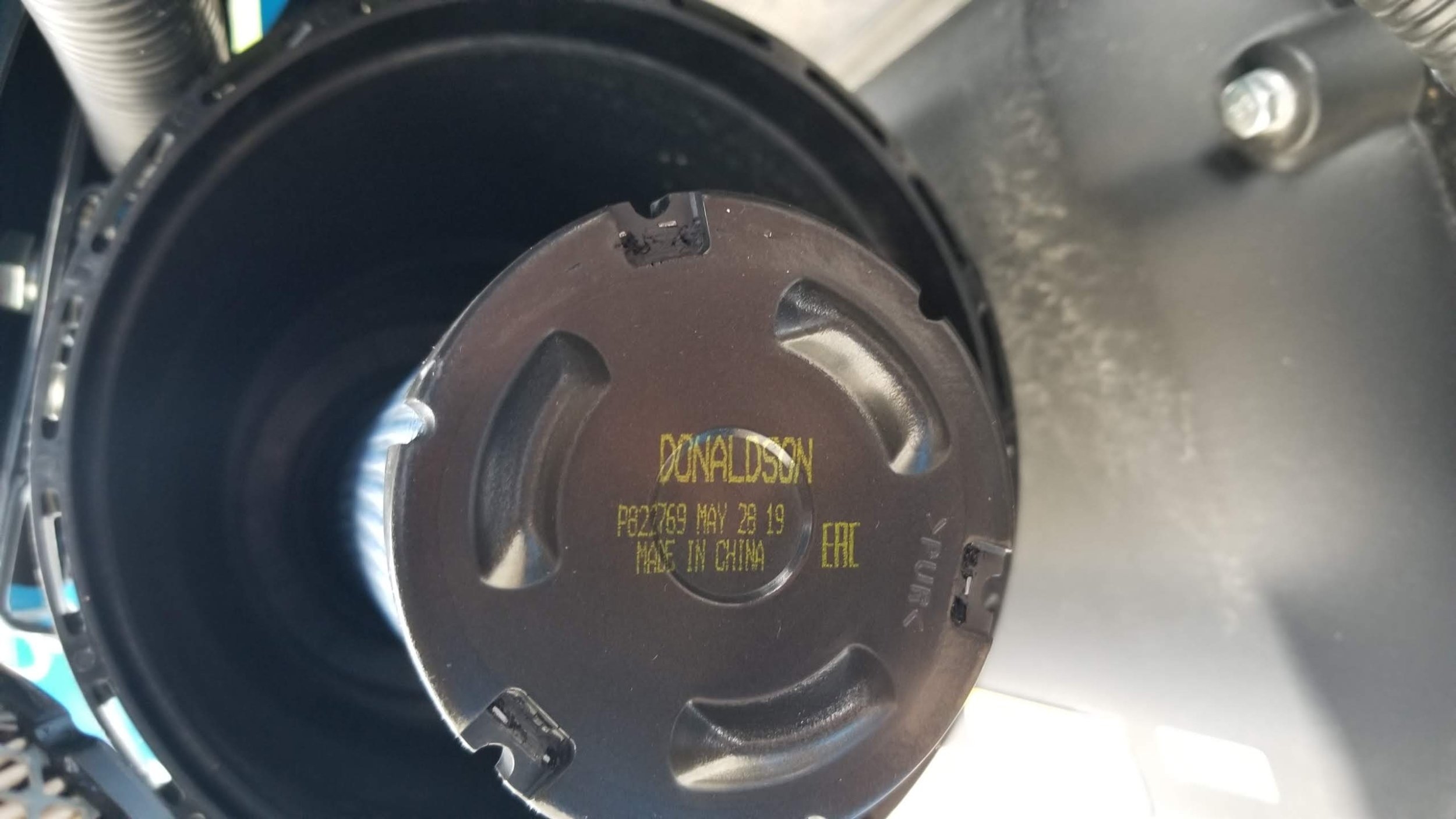

I ordered these Wix and Donaldson filters all through Amazon for much less than listed above.
Oil filter / OEM # 40409065 / Wix WL7426 $19.81
Fuel filter / OEM # 40271228 / Wix WF8395 $18.51
Hydraulic Filter / OEM # 40007638 / NAPA # 1715 / WIX 51715 $43.00
Hydro Transmission Filter / OEM # 40007563 / NAPA # 1551 / WIX # 51551 $11.17
Outer Air Filter / OEM # Donaldson P822768 / 40007576
Inner Air Filter / OEM # Donaldson P822769 / 40049446 $64.00 for the set
If the Oil and Fuel filter don't fit, I can return or I'm not out much money.
Any issues with the aftermarket fuel and air filter sets?
   / LS Tractor Oil, Gas, & Air Filter Information #394
Haven't installed the fuel filter yet.
The Air filter set is actually what came on mine and not really aftermarket, they have Donaldson and those part numbers printed on them.

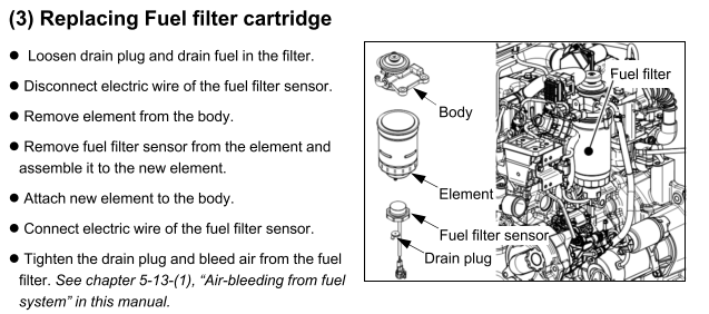

Question on the "Water-in-Fuel" Sensor. How does it come off the bottom? Unscrew or just pull off?
I have spun it about 1/2 turn and can't really tell if it unscrews or not. My next move is to unplug the connector then try unscrewing it several turns.
Neither the owners manual or the service manual actually provide this information.
   / LS Tractor Oil, Gas, & Air Filter Information #399
Mine is a screw in. I'd assume yours is too. But I am not familiar with your model.
   / LS Tractor Oil, Gas, & Air Filter Information #400
I think mine is a plug. My tractor is am MT3 52 tho... looks about the same in your pic. Where did you get your service manual??
