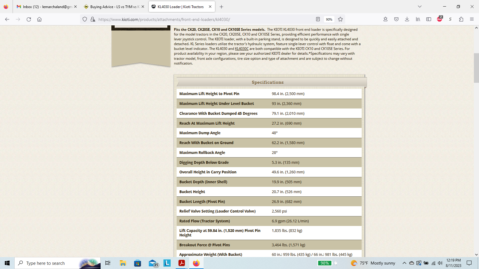

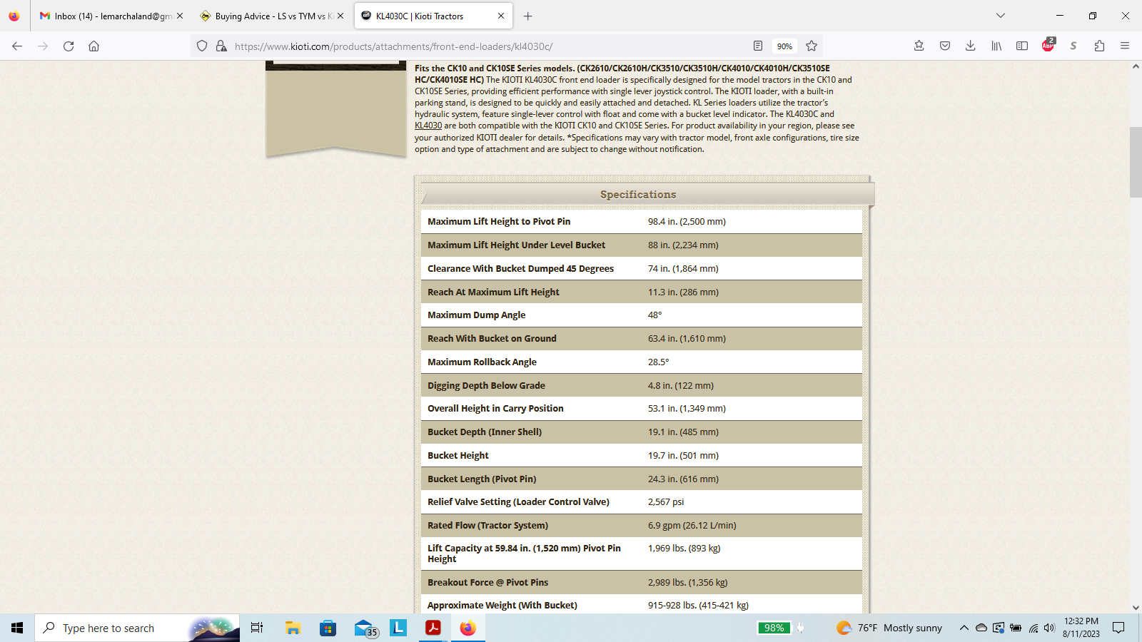

Absolutely false in this case. These are the loader specs for the kl4030 that goes on the CK2610 HST.
Things are not making sense here in the least.
First, 3 point hitch capacity has always been substantially more than fel capacity as hydraulic flow is much more robust in this area.
Secondly, their rollback force is weaker than its boom lift as demonstrated here. That's tough to believe.
Thirdly, I questioned this myself and pressed the Kioti site a bit deeper. It was there that I discovered that their purported lift capacity was aimed at the 3 point.
So I question "absolutely false". Lots of mistakes on web copy can be found.
I am wondering if this loader with an appropriate pump can reach those capacities and if the smaller CK's use a smaller hydraulic pump.

The CK's use the same pump throughout the 3 (6 if you count the SE as separate) models.
Now that said, Kioti's numbers are at the pin, so that's to be taken with a grain of salt.

The Kioti CK20SE series tractor which will spec out the same as the non SE models and the older CK10 series will spec out the same in hydraulic flow and pressure through out the series.
From the CK2620 to the CK4020 which is 11.33 gallon per minute flow, the tractors all have the same 3 point capacity of 1621 pounds at 24" from the hitch.
Kioti tractors and loaders for the CK 2620; break out at ground 3464 pound, Lift Capacity at 59.84 in. (1,520 mm) Pivot Pin Height 1,835 lbs. (832 kg)
So two possible loaders for the CK 10 or 20 series tractors which are used on all the tractors in that line regardless of engine HP, so lift and carrying capacities are the same through the CK series of tractor on both loaders and 3 point. And the loaders do have more capacity then the 3 points do.
Well I'm surprised.
First I've heard where loaders out lifted the 3 pt. But here again is how capacities are measured. If their 3 pt were measured at the pin points, I wonder if it would approach 2500#?
My own brand or the current Mahindra 1626 built by Mitsu, has a lift of 1550 at fel and about 2400 at 3 pt which could be at the pins as well..
The 25 and 26 series Mahindra's built by TYM, used to have a 2000# fel capacity advertised about 8-10 yrs ago.
Now those have been reduced to 1650# or what my current 3016 has been advertised as.
I wish the industry would standardize these figures.
I have lifted about 1800# at about 4' with my fel and would never in a million yrs lift that at full height even if it could.
Tractor is way too small for that stunt.
