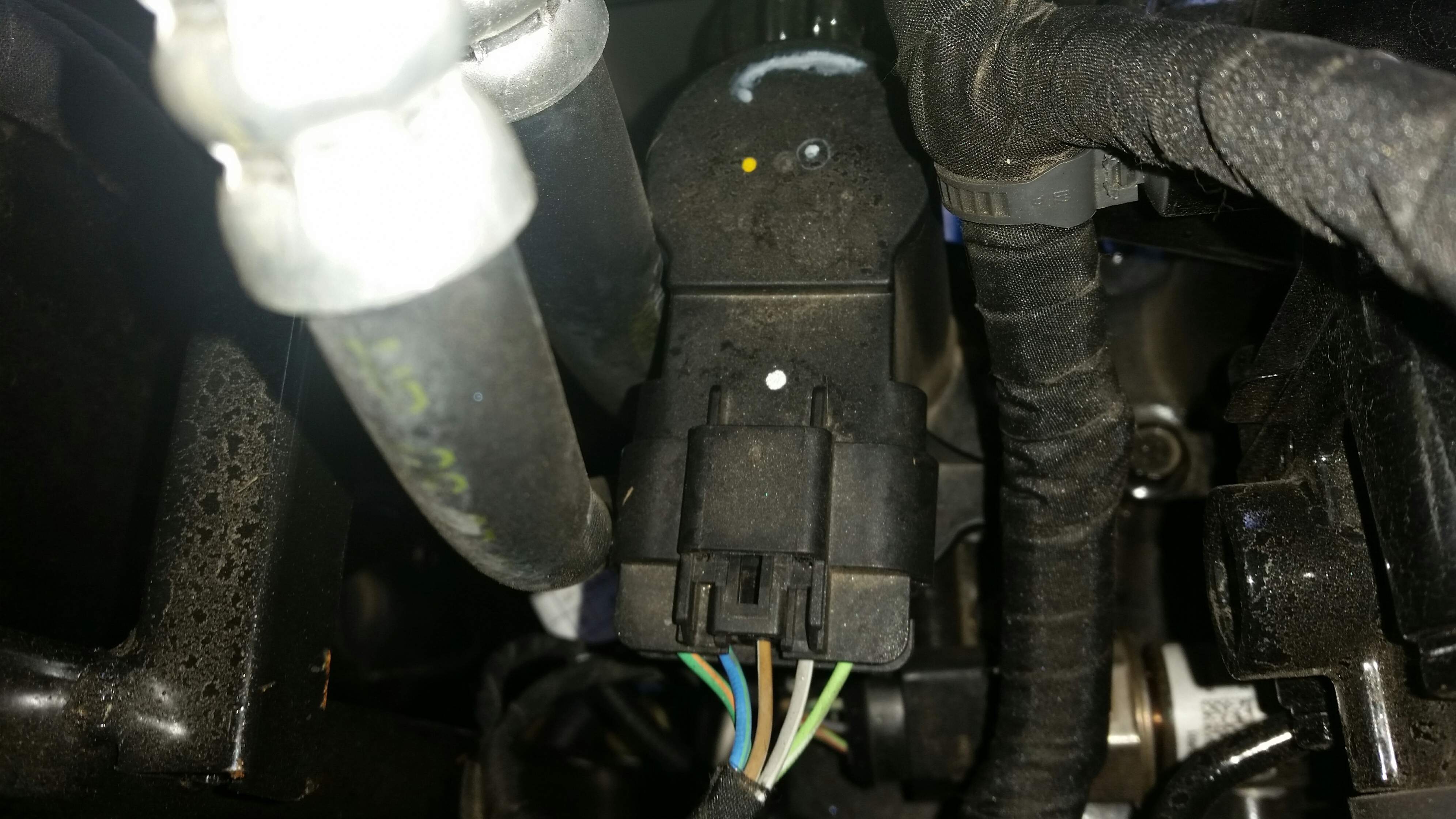

This is the top of the EGR valve.
   / LS XR4145H Losing power going uphill
#22
<img src="http://www.tractorbynet.com/forums/files/ls-tractor-owning-operating/447261-ls-xr4145h-losing-power-going-20151029_111658_resized-jpg"/> This is the top of the EGR valve.
ya. I was going to try to get a picture but haven't had a chance yet... :)

Same issue here with my XR 3135HC. Do you have a picture of the new valve compared to the old valve to show the difference in paint coverage?

Well... My problem came back. LS shipped me a new EGR valve and I swapped it out but that did not fix it like it did last time... :-(

Wound up being a fuel pressure sensor near the EGR valve.. Was reseated and works great now.
