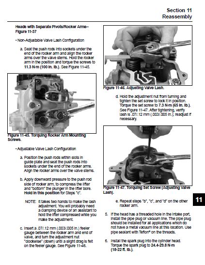

Unfortunately, these have hydraulic lifters. A failed ACR problem rests with the cam itself with a very outside chance of a lifter issue.
That maybe true, however, it depends on which head the engine has as to weather the valve lash is adjustable.
See this:
This a page from the service manual.
But I think you are mostly correct that there is an issue with the cam compression release.
Richard

Yeah, they mention that in the manual. They also refer to models w/o an ACR. I've never seen either one myself.
