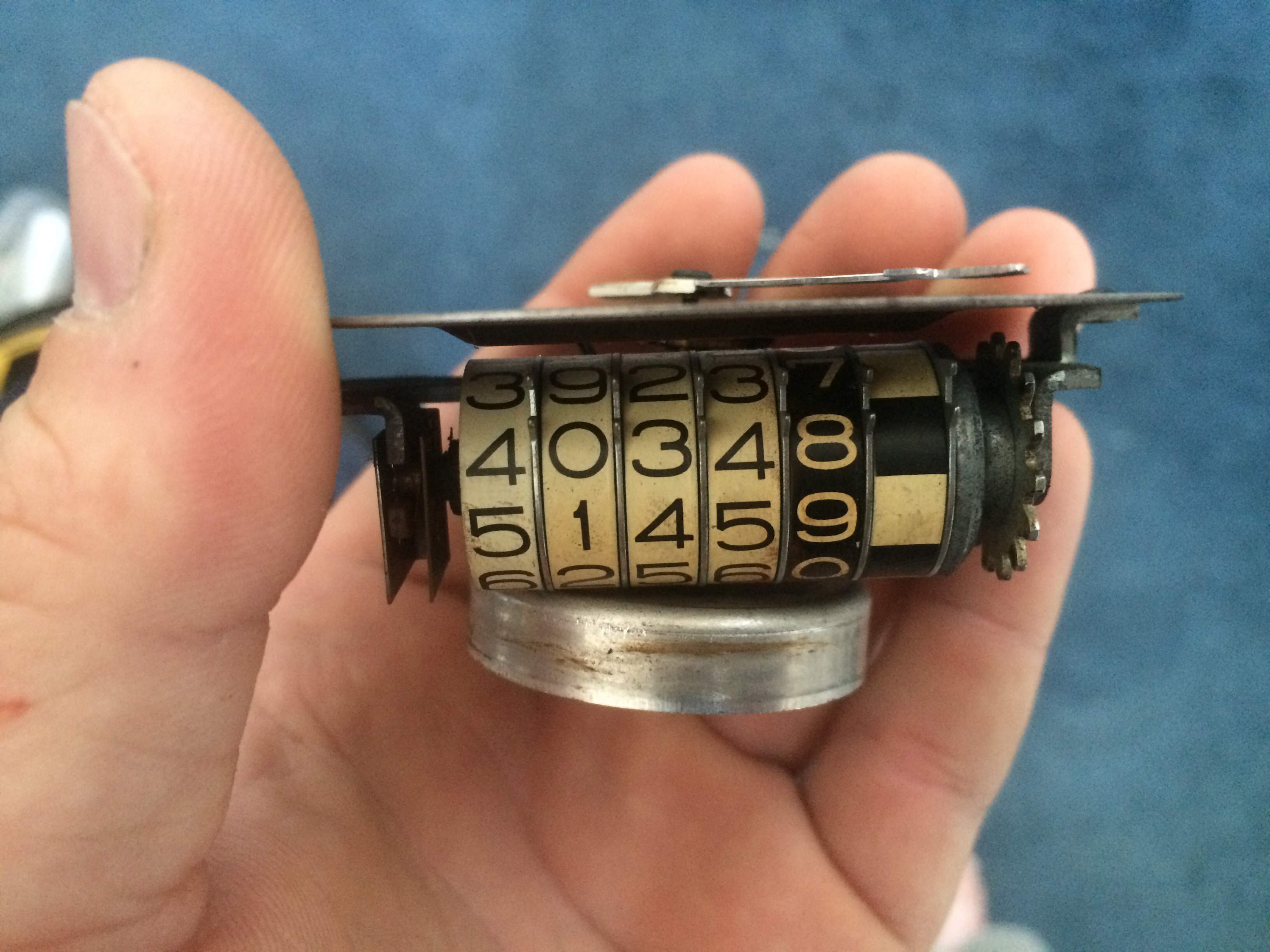

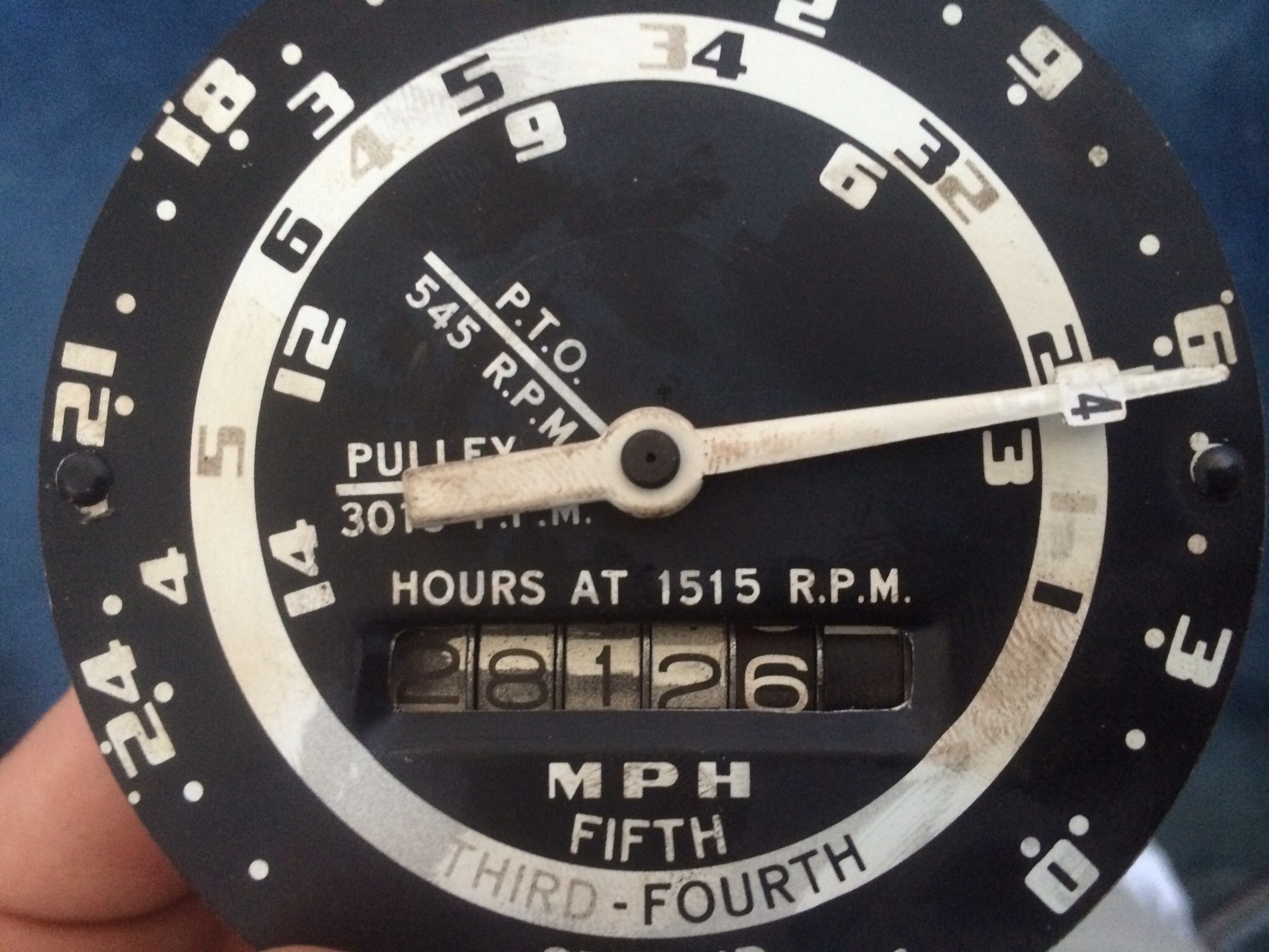

Well, the cable and meter were not working when I bought the tractor, so I'm not sure how long ago it gave up. The meter read 2812.6 hours when it stopped working, but that was apparently looooong before I purchased the tractor. You can see how dark the numbers are, but if you look closely, you can see that the number dial is white where I wiped a little of the smut off of the dial. It was only dirty on those numbers exposed, the back side was still white! The new cable was something like $20, I don't remember exactly. It's the all metal sleeve and seems pretty sturdy. It was actually fairly easy to take apart, only one little c clip on the governor side. It slid right out I lubed it up lightly with lithium grease except for the last few inches on the meter side, then slid it right back in and reinstalled the c clip. Total of about 5 minutes start to finish. Seems like minimal effort to me to do the extra step w/o cutting corners for peace of mind type of thing.

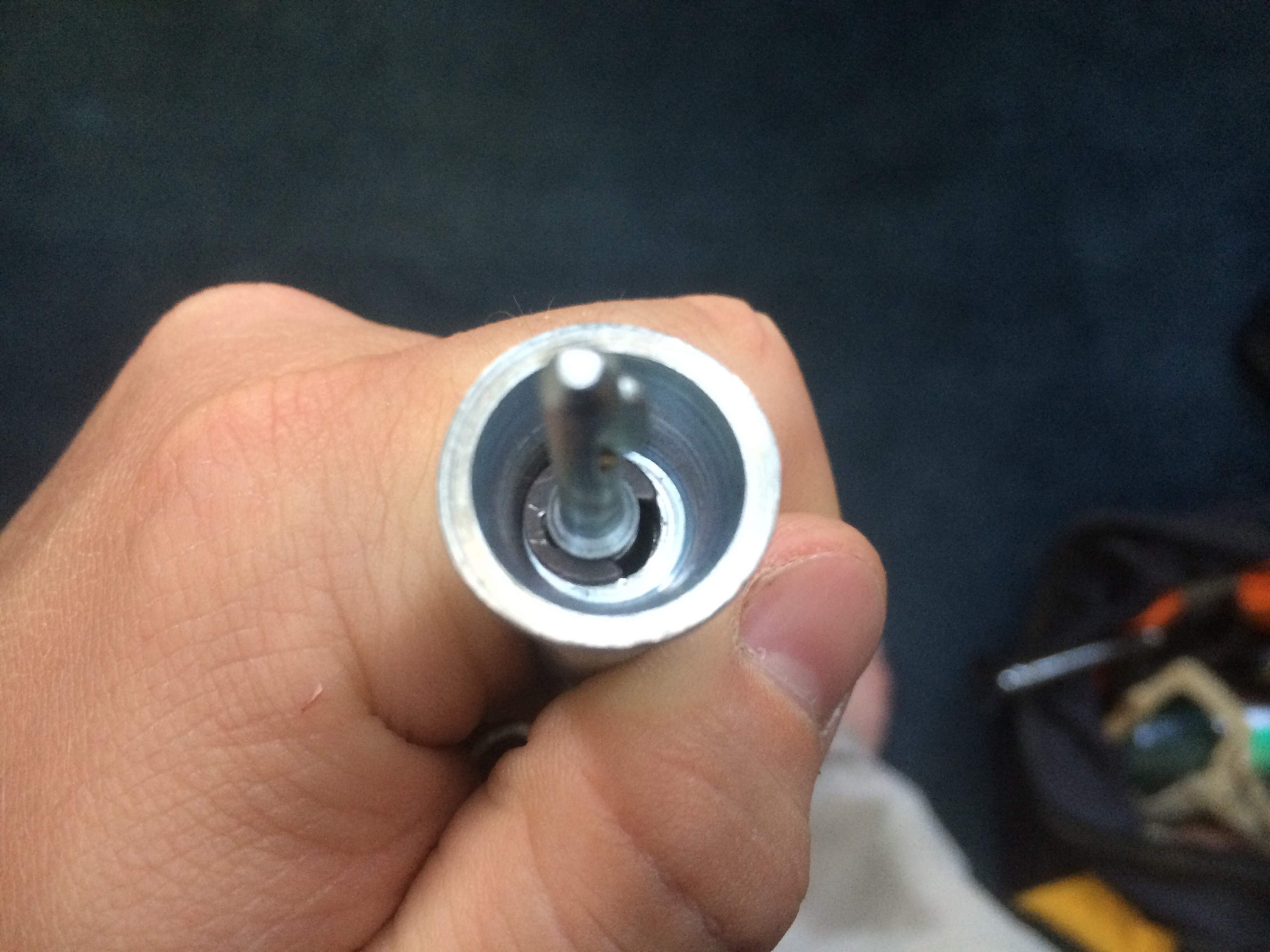

Well, I have good and bad news. The good news is that the jbweld worked wonderfully to repair the stripped out socket on th back of the meter! The bad news though is that either A: I screwed up something in the meter when I took it apart, or B:it was already no good to start. It kind of works, but I think either the spring is worn out or the magnet has lost some of its strength. They just don't seem to play well consistently together.
Before I put it back together I had the cable connected to the meter and a cordless drill on the governor end. The drill has a max rpm of around 1700 so I thought that would be a good speed to test things out. Sometimes the needle would bounce around about 900, other times it would be closer to 2400 with no rhyme or reason for one or the other. Maybe it just needs adjusting or tuning or something, but I don't see how that would be done. The gears all turn and the hour meter works, the tach is a whole different animal.
I think this one has surpassed the $50 value mark for me to try to repair, so I believe I'll be ordering a new one.
