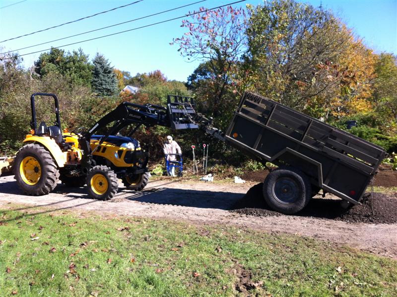

Yep, I use one with my Yanmar LX. I use a pintle hitch bolted to a box blade to hitch up to mine. That trailer is actually a M101A3 with the surge brake controller at the top of the A-frame behind the pintle. You'll want to put a pin through the hole on the side of the surge brake controller to disable the brakes when backing up with it. It should be able to handle a ton easy and a little more if you need to push it.
Here's a pic of mine dumping gravel over at my Mom's house and my 93-year-old grandmother coming out to "supervise."

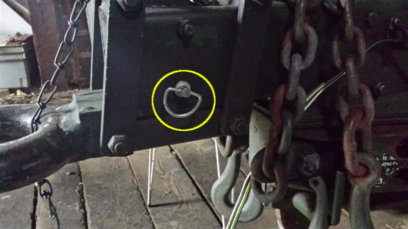

I can take a picture of the pin in the brake controller for you later this evening.

Here's pics of the pin that disables the surge brakes. This pin is not the original, just one I picked up at a hardware store. Its 3/8" and about 4.5 inches long. You may need to move the trailer forward and slowly stop in order to get the internal parts lined up before the pin will fit all the way through the controller. An abrupt stop (or reverse motion) will move the hydraulic piston forward, putting pressure to the brakes, and block the hole for the pin.
You also might be interested in the maintenance manual for this type of trailer. Steel Soldiers::Military Vehicles Supersite is also a good resource.
Forgot to add, the master cylinder will most likely have Dot5 (Silicon based) brake fluid in it. You will not want to mix that up with Dot3 fluid. Dot5 is more resilient to moisture but its more expensive.
