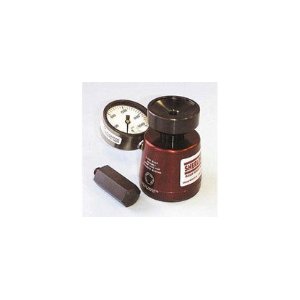

The Sherline scale was developed just for the purpose of measuring trailer tongue weight. Very simple: a pin drives into the body of the scale, which contains hydraulic oil. A gauge on the side measures the pressure. Here is a link on Amazon:
Amazon.com: Sherline LM 2000 - Trailer Tongue Weight Scale 2000lb: Home Improvement
I put this on top of a hydraulic jack and lifted the trailer tongue until it would clear the hitch ball and could then directly read out the tongue weight.

Thank you for the link to the sherlone, I need one of those! Guessing is not cutting it.
