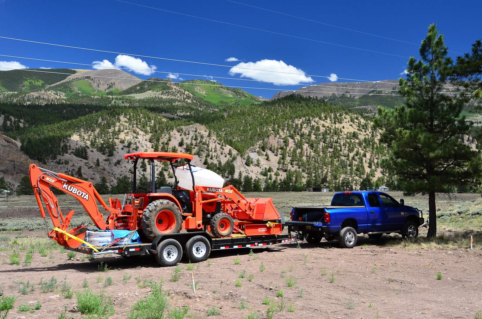

This is to followup on our earlier discussion of towing the M59. We completed our first trip with the M59 several days ago, towing it from southern NM up to SW Colorado, about 700 miles over a number of passes (the smallest ones we could find!).
It went fine and the truck performed superbly. On the steepest grades (e.g. Cochetopa pass, 10149 ft) on the main roads we were pulling at about 40mph, 2K rpm, in 2nd gear on the automatic transmission on the truck. On lesser grades (Raton pass), it was 50 mph in 3rd gear. The steepest grades were closer to our property on smaller roads, where we got down to 30mph or so. I did not find a scale to weigh the trailer, but with the M59, an 84" grading scraper and forks the loaded trailer was probably about 13.8K. The picture below shows the rig upon arrival at our place in Colorado (where it is currently exceptionally dry by the way). The tractor looks enormous loaded on a trailer behind the truck! The truck roof is 7' high for scale.
Some lessons learned:
o At 22' the trailer was barely long enough for the M59 with a couple of attachments. Balancing the load was not a problem, but the backhoe barely fit on the trailer as you can see in the picture.
o Check the trailer brakes! This was a new trailer. In my first test, unloaded, I found that it had almost no brakes. It was necessary to jack the trailer up and adjust each brake. One of the wheels had a nonfunctioning brake due to a wiring problem. After the adjustments it was fine.
o An exhaust brake on the truck is essential, for ordinary driving but especially when descending steep grades.
o Gauges on the truck are essential. EGT is the main one. As soon as it climbs above 12.5K or so I shift to a lower gear and up the RPMs. I also monitored the AT temperature and rear differential temperature, and turbo boost. I installed an aftermarket deep cover on the AT and the temp never got above 190 and was usually much cooler. The rear diff (also with an aftermarket deep cover) did get up to 225 on the steepest pulls, which is a bit high but not bad, considering.
o I used a Sherline scale to adjust the hitch weight to 1400 or so; would have been difficult to get this right otherwise. A weight distributing hitch is obviously essential for a bumper hitch towing this weight.​
I also had one of my tractor cameras mounted on the ROPS at the rear, which made it easy to monitor the back of the trailer and the hoe, and check for clearance when passing. [edit: also reprogrammed the truck ECM with a Smarty Jr., which was essential to keep the EGTs down.]
My feeling having completed this tow is that towing the M59, even in the mountains is no problem so long as one can monitor the truck and adjust speed and gearing where necessary. Avoid sharp turns - it will practically scrape the tires off a dual axle trailer. The biggest risk is probably braking, one has to keep an eagle eye ahead.
