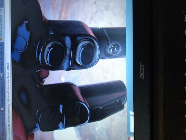

If anyone in the USA can provide me with the Kubota Part Number for this upgraded joystick handle I would be forever grateful...Kubota Australia cant help.
Thanks
R

Rorym - just installed the kit on my M59 - the stick comes with the Front 3rd valve kit TL2212.
