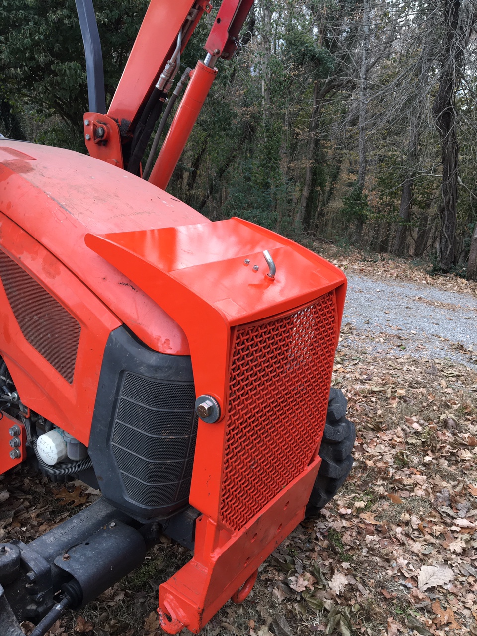

3x6” tubing, 1/2” plate, 1/2” quarry screen, 3/8” chain hooks and 1” D-ring. The original guard went from 38 to 108#’s. Boxing the original guard metal and bends adds strength. This is the fifth guard I have done.
Have had the tractor for about 2 years. Gathering materials from the scrapyard and paint. Then had a limb I didn’t see punctured the plastic grill and bent the oil cooler. Didn’t get it made in time but now ready for the next time.
Learn from my mistake. If buying a grapple or piranha bar, etc do the grill guard upgrade first.

Very nice - SmokyDog. Does your guard have to fold forward, like mine, to open your hood?View attachment 618940
Lord - look what my photo massaging software has done to the back half of the hood.

I started with a flat faced guard. Then added wings after jabbing a stick thru the grill.

The grill guard did not fold forward.
Kubota did make an interesting hood protector, no longer available, for the M59.
/ M59 grill guard
Found and installed a bonnet cover option. Offers improved brush and spillover protection.
