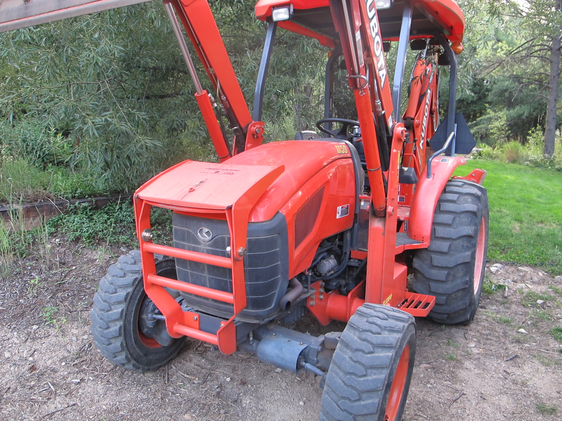

I have only seen pictures of this accessory. Heavy metal hood/nose protector that hinges to the grill guard. Unique to the M59? Useful accessory? Worth buying ($225)or fabricating? Reviews please?
Had a stump root come over the grill guard into my hood a while back. Able to bend, weld and repair the hood. Thinking this accessory would have prevented the damage.

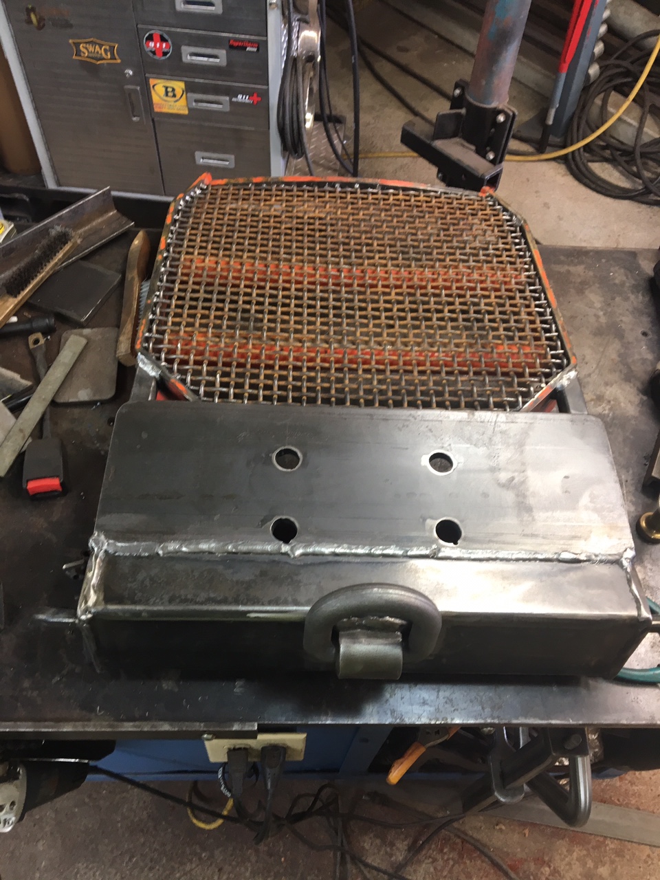

Have the grill guard on my welding bench now. Getting ready to throw the scrap pile at it to improve tree resistance. Quarry screen, tube for bumper, 1/2” plate, and D-ring for tie down are on the menu. Design to still allow use of hood protector?

Ours is one of the first M59s, back when the new model M59 was introduced new tractors tend to come as a package deal with all sorts of accessories - the hood protector was one of those introductory extras on ours - along with lights, 3pt kit, extra bucket...things like that.
But if $225 is the price, I'd say it is well worth it. It isn't just the hood protection, but the thing folds out to open the hood and when folded out it becomes a work-holding tool tray. Here's some photos. And it's hinged with special big bolts and rubber washers so that it is easy to fold out or up and yet doesn't rattle. All in all it's a well thought out piece and real rugged.
Just remember to fold it back up over the hood before lowering the FEL. No need to ask how I know this ...... but it does prove how strong it is.

Spent several hours working on the grill guard armor this morning. I wrestle some big trees so needs to be tree tough. Also push over some big stuff to bushhog. Heat gets to me more the older I get. Looking forward to cooler weather.

Well, I was thinking that even if the kit wasn't available there might still be parts for the hood protector in the parts manual. But I can't find any mention of the hood protector in the parts manual. The toolbox is there....and so is the hood-mounted extra air cleaner along with the extra lighting kits and all the 3pt pt/drawbar pieces. But nothing for the hood protector. For that matter, I couldn't even find a mention in the parts book for the brush guard that the hood protector mounts onto.
That's too bad....the hood protector is a handy piece. But it should be able to be fabricated pretty easily. It's just 3 pieces of metal welded together, two bolts, plus some grommets & washers. It's much simpler than the brush guard itself with all those fancy bends and angles.
Dog, If you can hold off for a month and then remind me, I'll take mine off and make some patterns of the three pieces. That way they can be traced on a piece of steel, laser-cut, & welded. I'd guess most any welding fab shop could do that for the price of the kit.
Here's a mystery though..... If you look at the photo below you can see that the hood protector comes with a bushed hole and and two bolts right in the middle of it. What in the world are those for? Any ideas? Is it to mount a flag? Kubota must have gone to some trouble to add that bushing and those bolts....but why?

Thanks for the very generous offer. The side arm geometry is the tricky part and the top plate position. If it was available I would have got one. Let me think on it awhile before you go to considerable effort.
Without a drawing a fab shop one-off is expensive.
The top bolts and hole are more of a mystery to me now. The bolts hold a bracket underneath? Figure the install kit instructions would make it clear. The hood protector is held down some how?
The dog and I are coffeeing up to go work on the grill guard some more. Test fitted the bumper yesterday for clearance. Screen nearly ready to weld in.

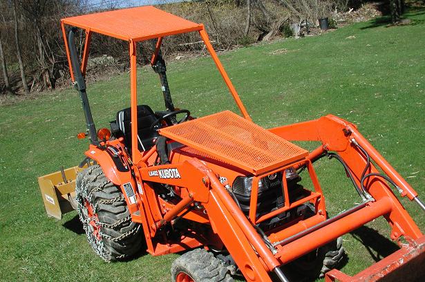

My tractor is not an M, but I would think a hood protector should cover the entire hood.
Years ago I built hood and head protectors for my little B2910. Been very happy with them.
Just for the sake of discussion, here is what I have:

Grill guard upgrade for M59. 38# to 108#s. Quarry screen tougher to work with than expanded metal. Boxing the bottom adds strength. High humidity makes paint take for ever to dry. This is the 5th grill guard I’ve built. Bush hog tough, high stuff. Rather have bumper make first contact than the front axle. Move lots of brush, push out trees, roll stumps, etc. My hillybilly trees fight back.
Just needs a hood protector hat to complement the look;-)
That looks like very nice work all around. Congrats. Nice to see good craftsmanship.
Did you ever try those cross bar links on the chains? Or was that you?
