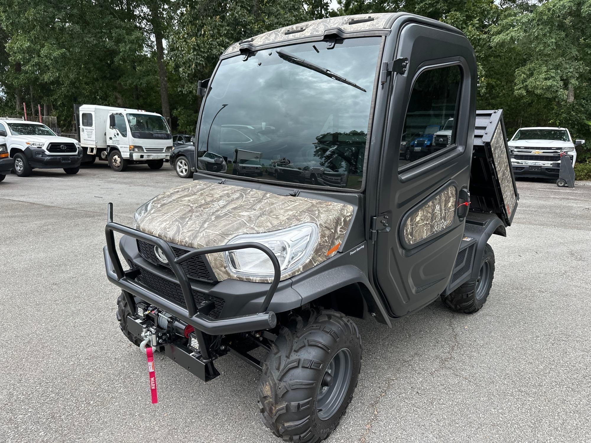

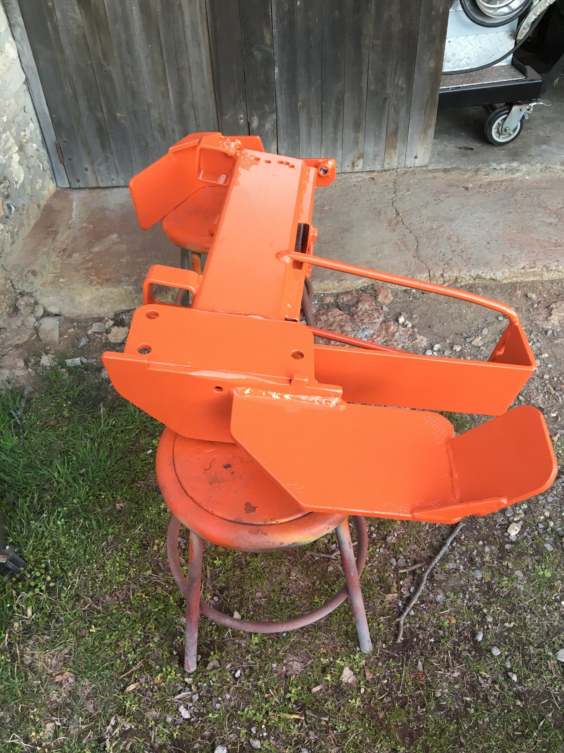

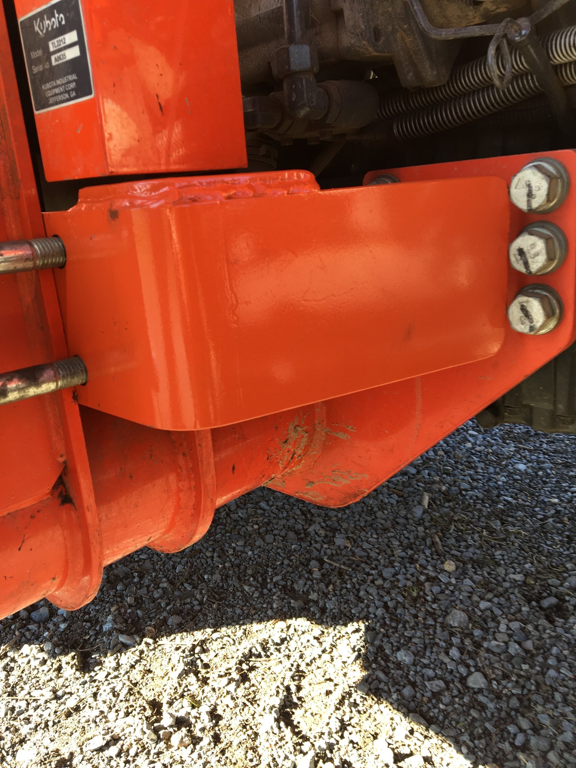

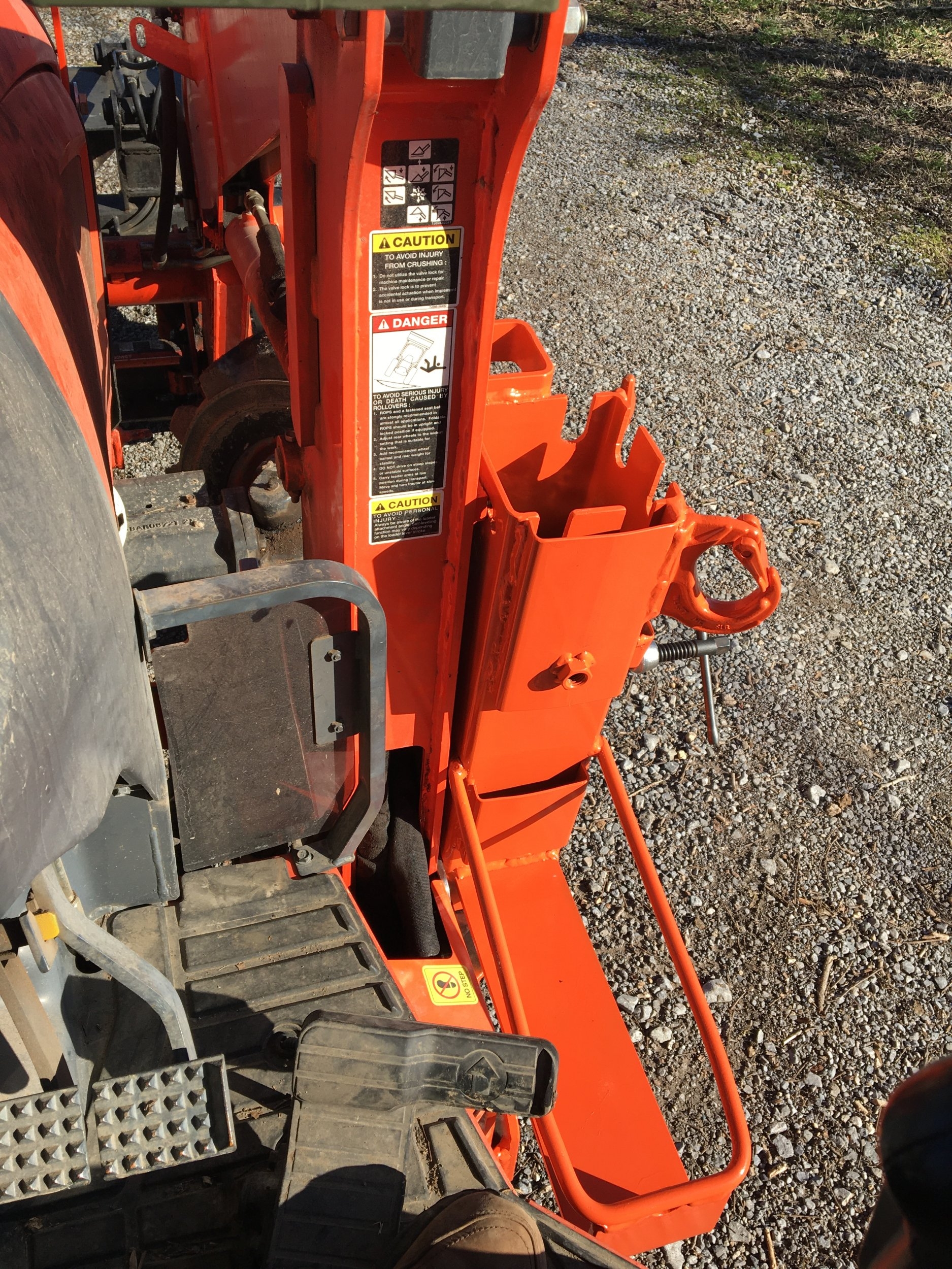

My M59 has to survive and thrive in brush infested environment. Several modifications of armor has improved survivability. One was to improve protection of the tender loader control valve innards.
Being able to safely carry chainsaw, chains, and other tools a plus. View attachment 850520View attachment 850521View attachment 850522View attachment 850523
Looks like some slick tool carriers you fabricated up! Nice:). I have to do some of that too.
The metal they use is a bit thin for brush work:(.

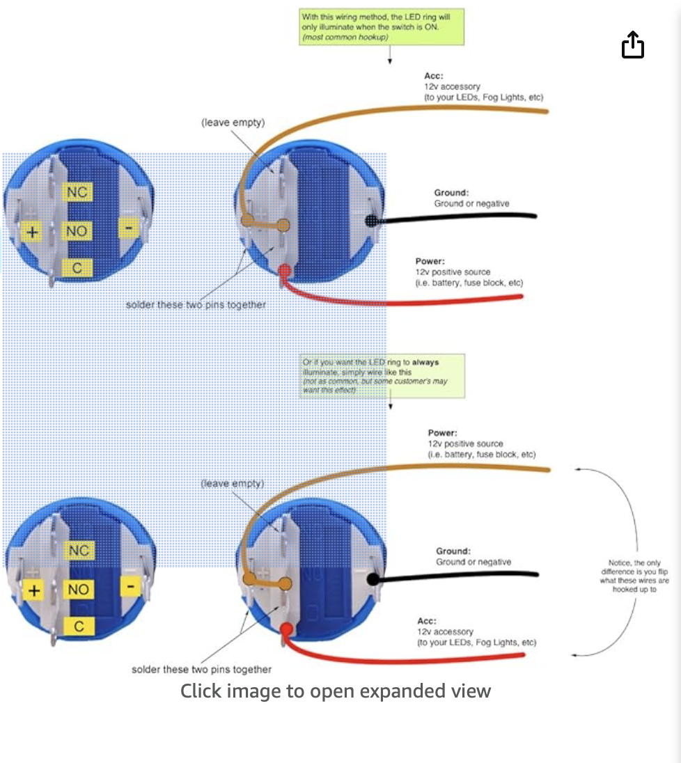

I'm glad you asked. None of this is self explanatory to an old toggle switch guy. I had the same questions.
The M59 3rd Function activation switch by the loader control valve is a third class of switch: a "clamping push button". It does works like an on/off pull switch in reverse, in that one push latches the button down and completes the primary circuit of 12V/10A to work the solenoid activating the 3rd function.
And then a second push releases the latch, opening the circuit and raising the depressed button back up to its resting state.
But that is not all that happens. You can't really say it is a true single pole, because when activated it also steals a little power for a parallel circuit to light an internal LED showing that it is activated. So internally it is a Double Pole, but to the external world it is a Single Pole.
Normally it will have 4 wires going to it, and they are arranged between the 5 connectors on the switch as shown below. I used the upper diagram so the switch only lights up when 3rd funtion is activated.
Just order one. It comes with a wiring sheet. As for which color Kubota wires goes to what terminals... I had to trace them.
rScotty
View attachment 850565View attachment 850566
Super- thanks again!
I thought maybe a couple of the wires are to power the led indicator. I’ll get one asap

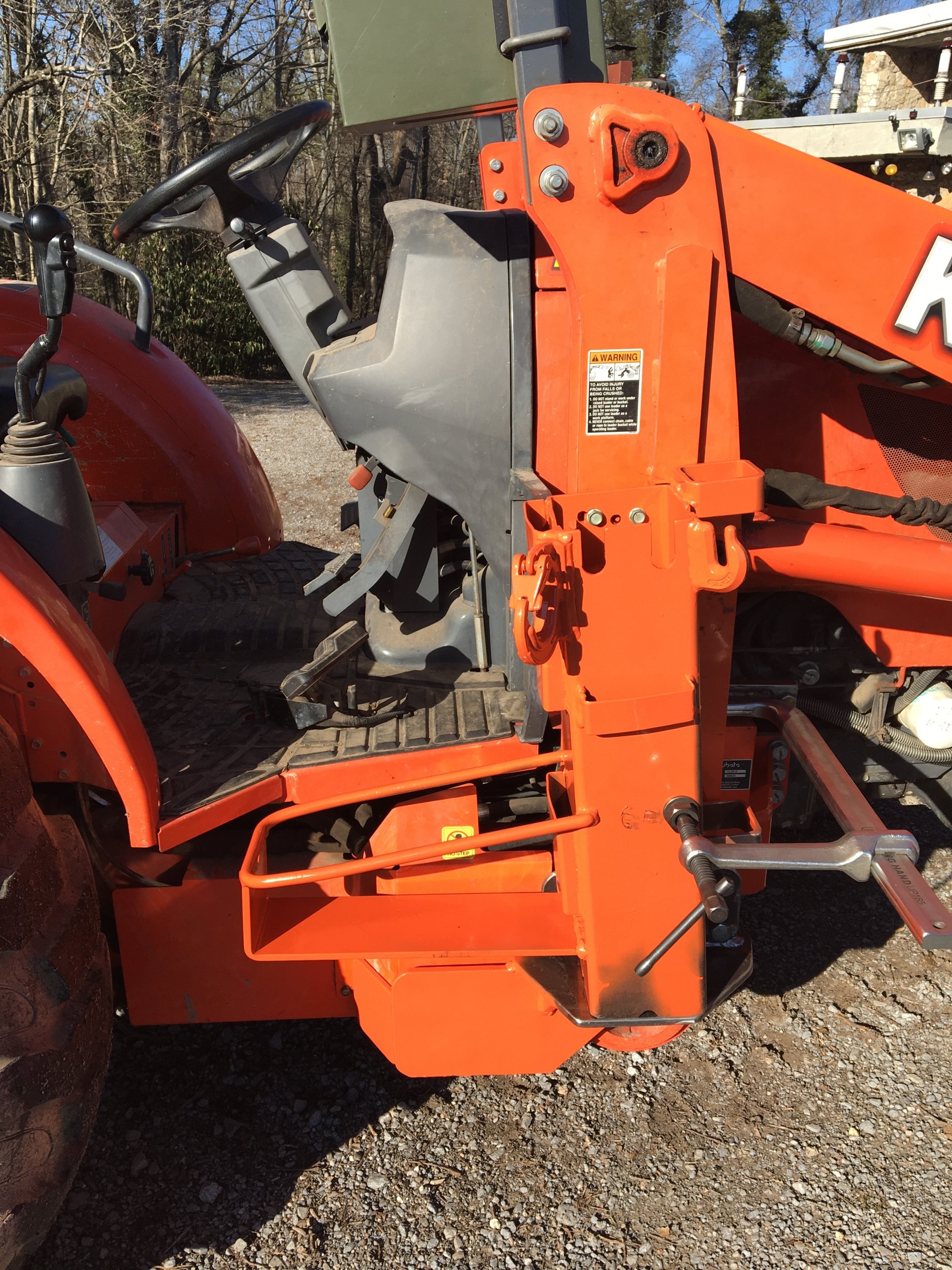

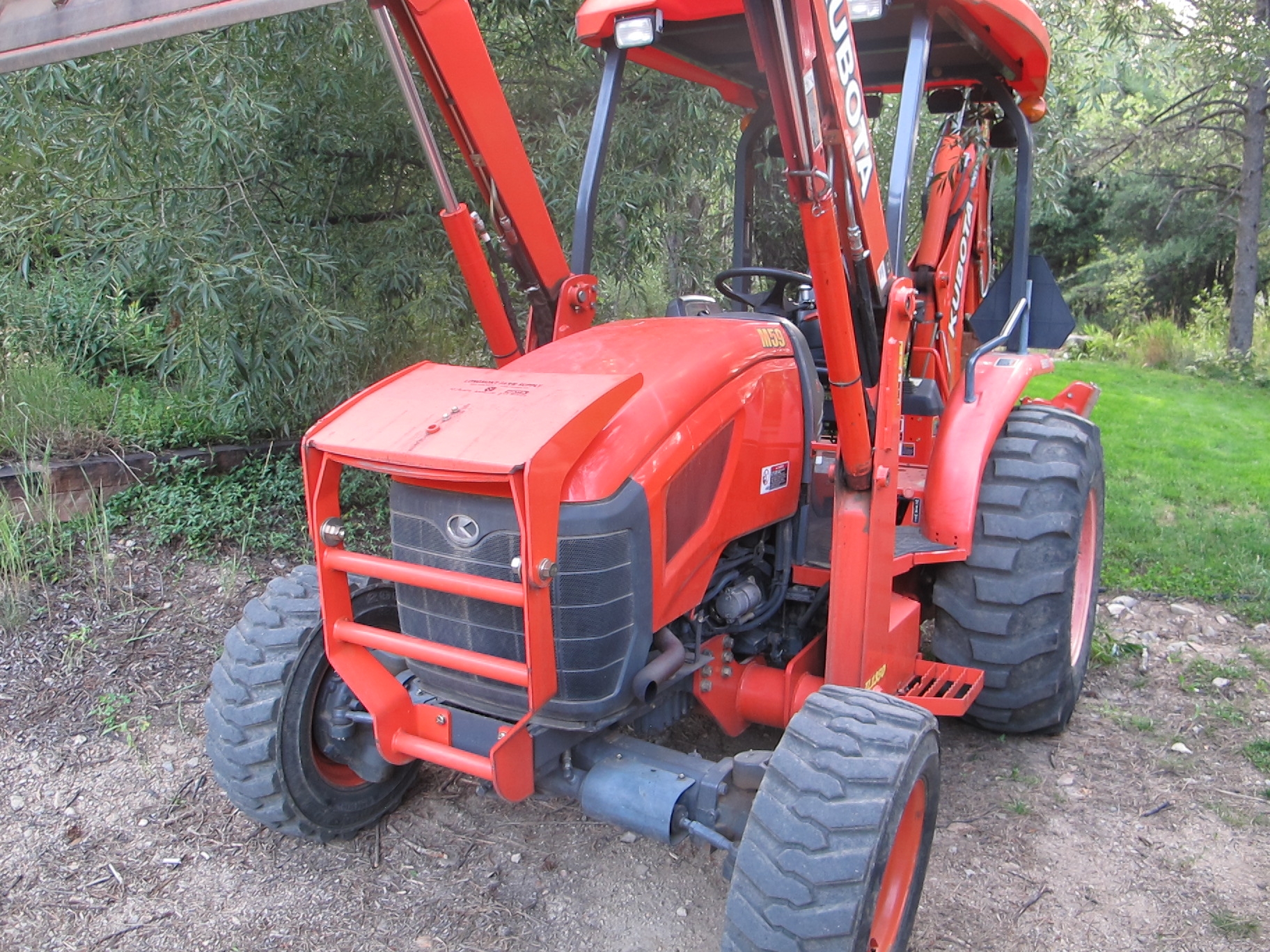

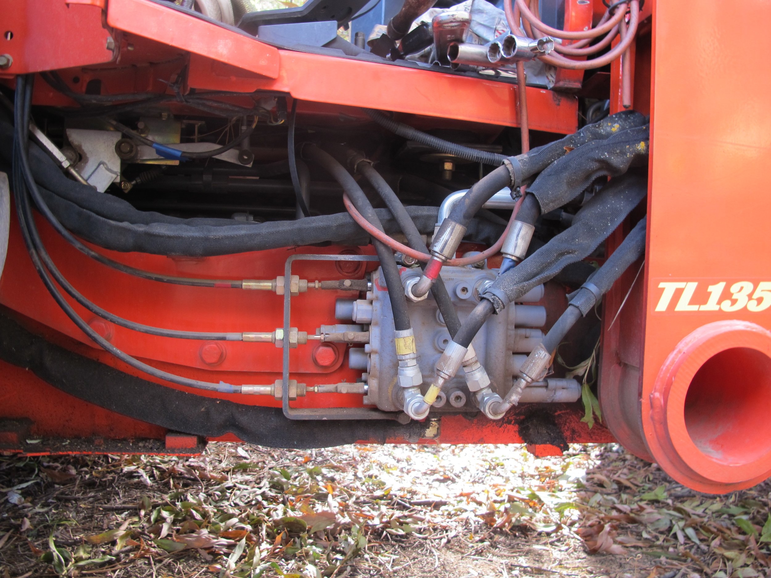

The loader valves are mounted down low almost directly below the HST foot treadle. They do have a nice cover that keeps brush from hitting them, but the cover also can allow them to become packed with mud or dirt. To access the loader control valve & 3rd function valve, begin by removing the lower cover on the right side that has the yellow warning sticker "NO STEP". After a few bolts and covers, this is what you will see. You can see why it should be a maintenance point.
I believe a bicycle cable oiler will allow lubing the cables from below - but have not done that.
rScotty
Yup, same as mine. Exposed! I had no panels on mine as they had been ripped off! I ordered new ones and when all mechanics is working good, the new panels will go on.

rScotty has been a great help to many and I as well. Very knowledgeable and articulate in explaining functions and repairs.
Had to take a second look:)
I really like the guard shield built into your mounting system! Clever.
A plan to steal🤪🤪🤪.
I often carry a chain saw along. Been electric now that they have gotten stronger:).
I carry chains all the time. I do plan on fabbing a couple of tool carriers for it.
