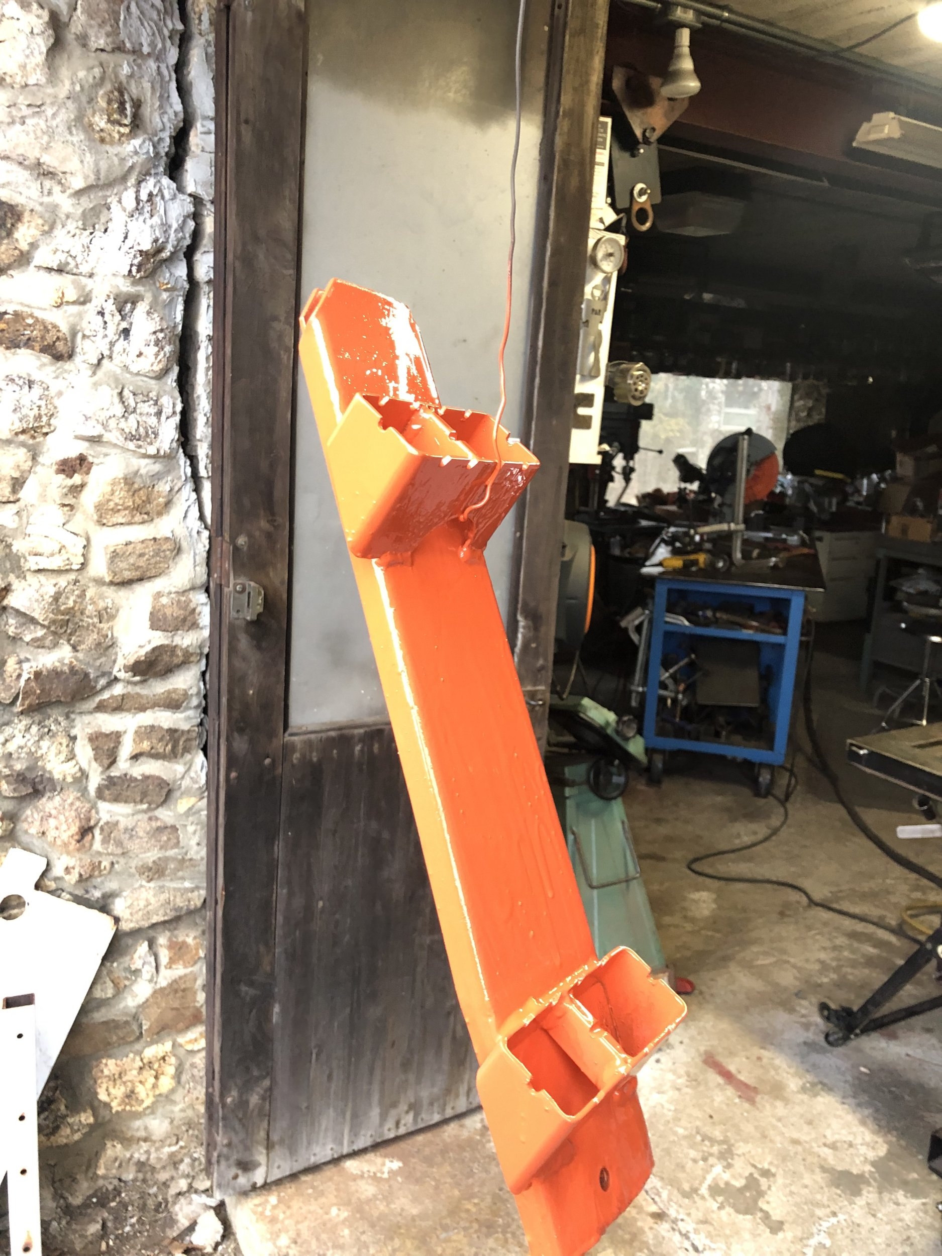

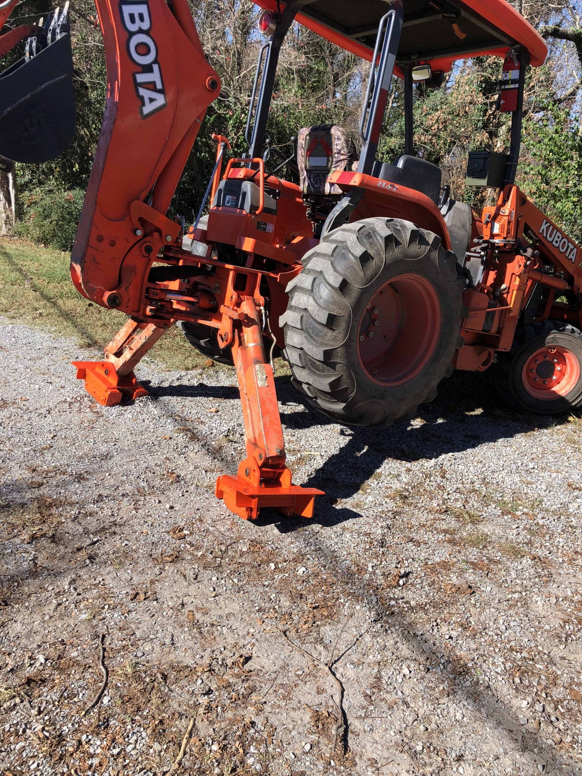

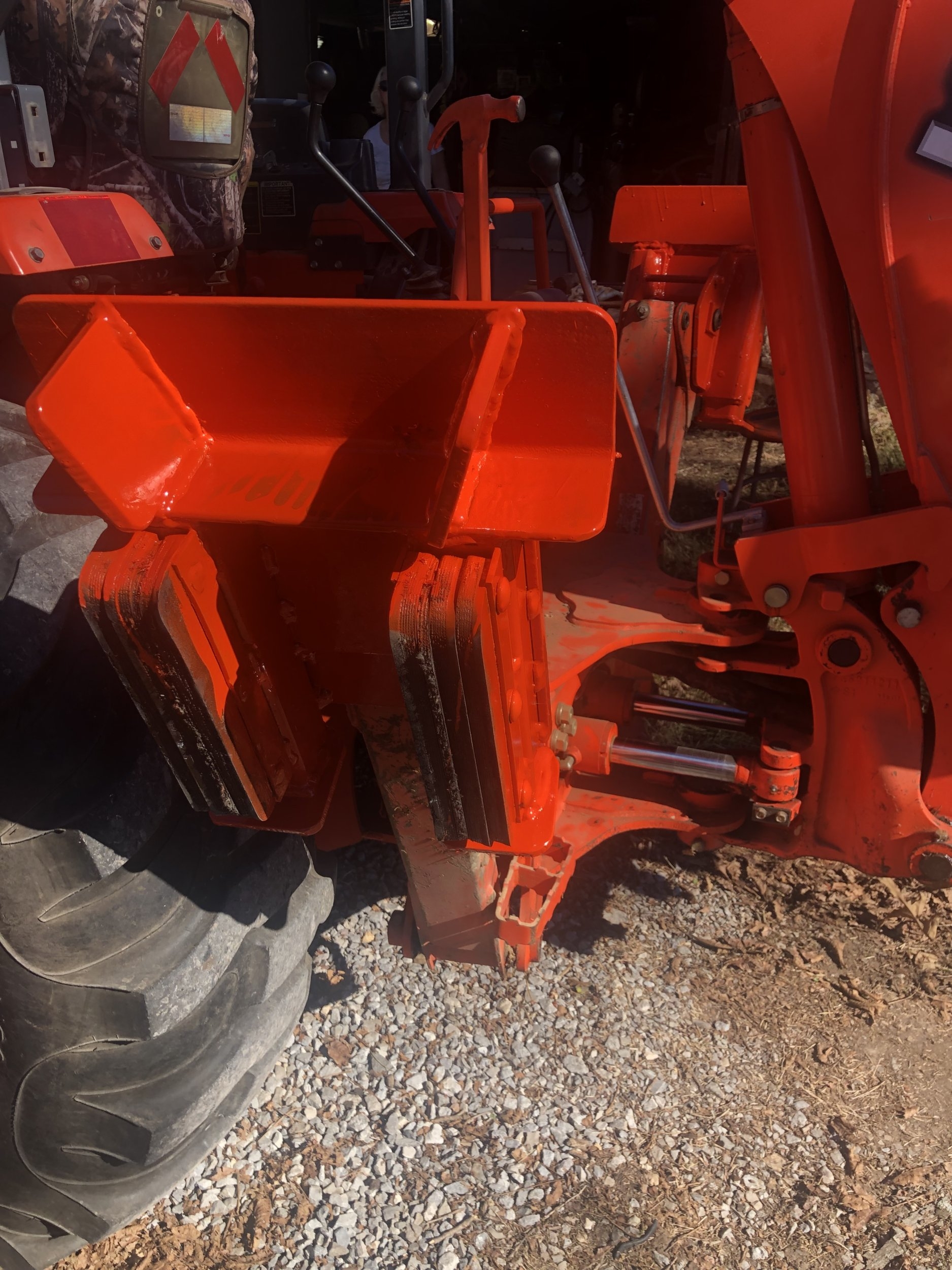

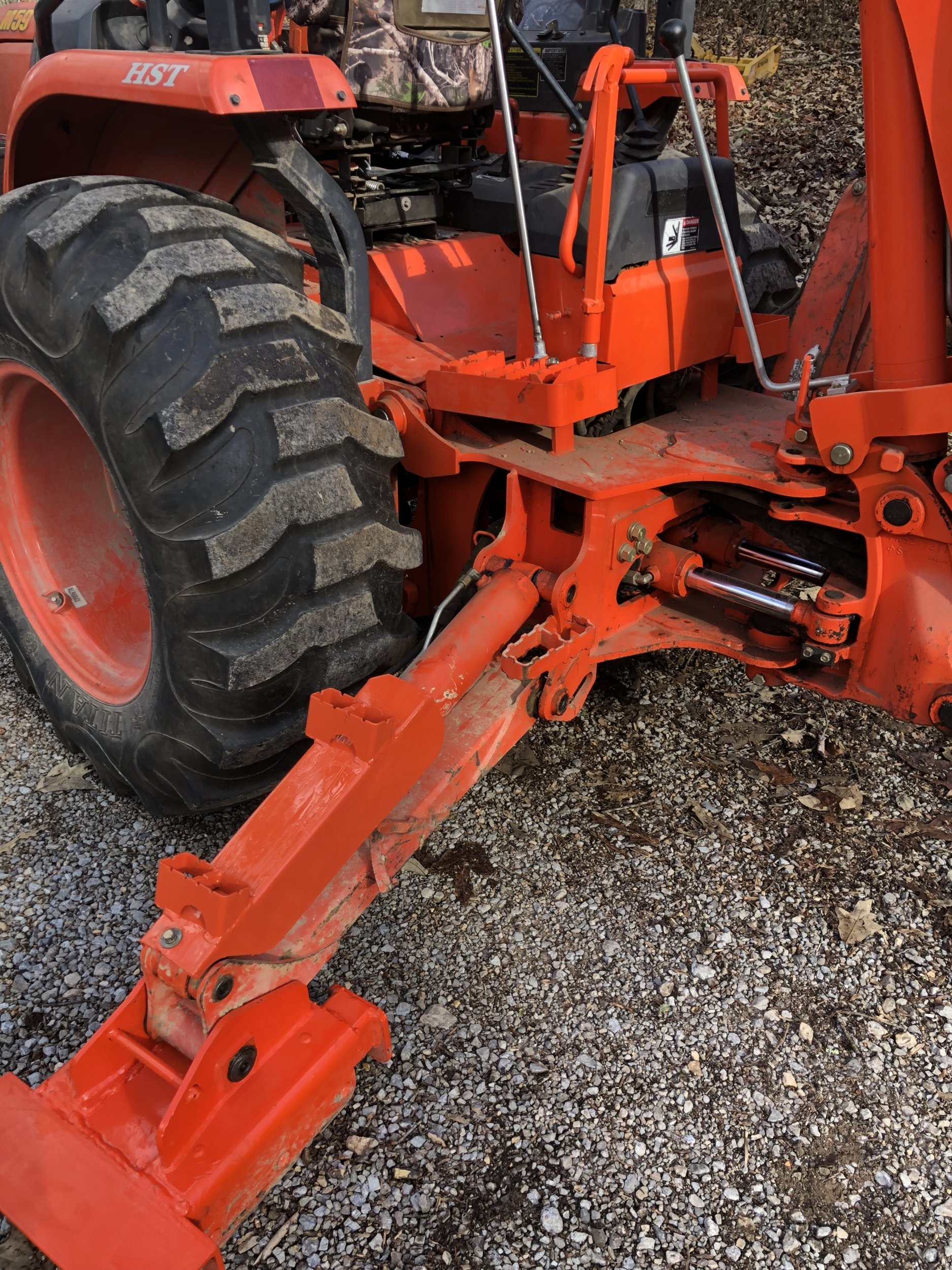

My solution for outrigger feet.
Then improved steps for climbing up and down. Unless you have a ground crew there seems to be a lot up and down.

I agree that the stabilizers could use some improvements. They do work, but could do much better. The factory steel feet have an inverted U shape that makes a pretty good ski fore and aft. In the lateral direction, they are simply too small and too close in to do what they should.
For starters, they could have a heavy corrugated rubber bottom, plus maybe some spikes at the corners, have twice the footprint, and stick out farther. The basic shoe seems sturdy enough to add those features, ...even as bolt-ons. One thing to watch is with the M59 it is possible to swing the bucket far enough to foul the stabilizers. I don't know if that is still the case with the M62.
Anyway, the stabilizer feet are an easy mod.
