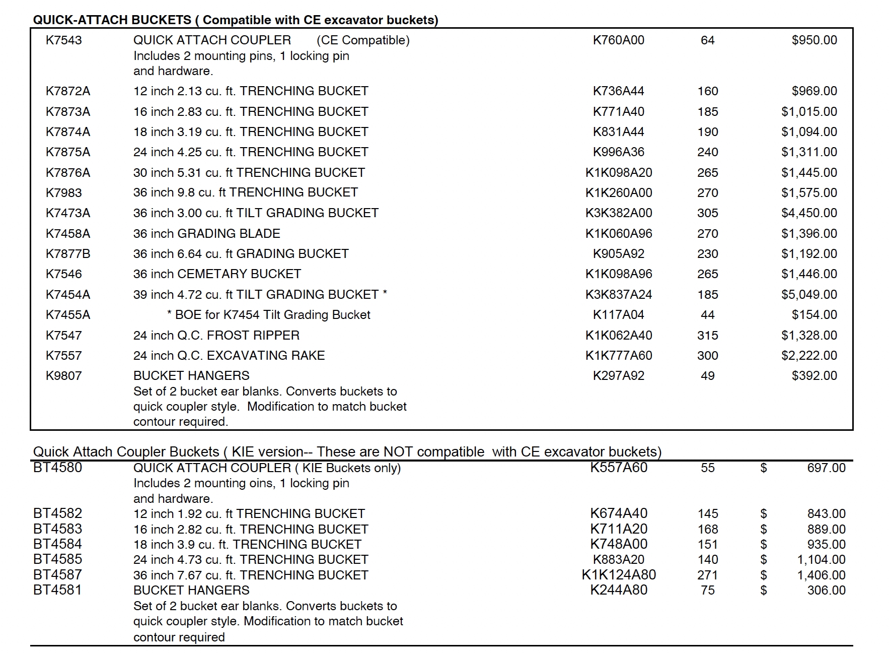

In order to compare prices and options it will pay you to go to the Kubota "Wholegoods" catalogue.
It lists the prices from Kubota for all the TLBs and all options with part numbers. For example, below is an example from the 2019 "Wholegoods" showng two different options for M62 Quick Attach backhoe buckets. I see a tilting grading bucket.... nice.
I don't see the M59 style grill guard listed, Smokey may have gotten one of the last ones in stock. But check the 2024 wholegoods to be sure.
The M59 will probably be our last tractor. It is a classic, runs like new after 16 years, and there are many options yet to be explored. Underpowered? no... not at all. I would say that the hi/hi road gear is definitely geared a touch too high. It bogs uphill and can go way too fast on the level. All the other gears seem right. Both lows gears are plenty low & powerful. Most work is done in medium range.
The "cheater" for the SSQA is just a 4 foot length of SS pipe sized to fit over the SSQA levers...I put that in as sort of a joke since I like to set the SSQA pin springs tighter than most do - (they are adjustable) - but when they are that tight I'm too old to throw them by hand without a cheater pipe.

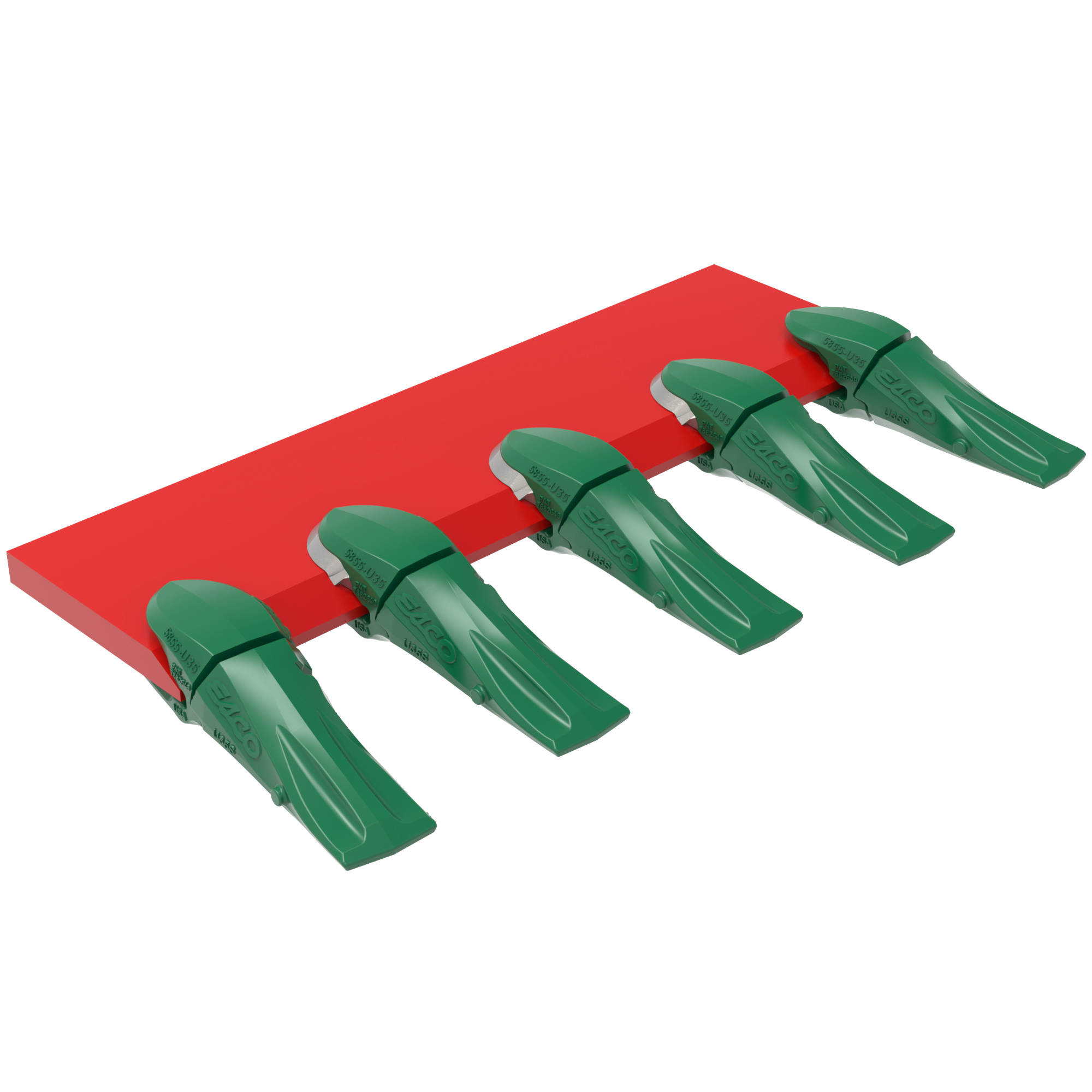

I'd also get a 6' hd Round bucket from an L47 with cutting edge, then weld on adapters for small excavator teeth for hard soil digging
Best teeth
Available from:
recommend

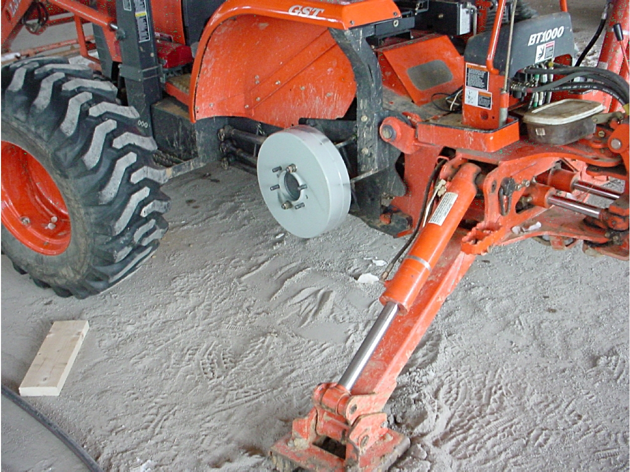

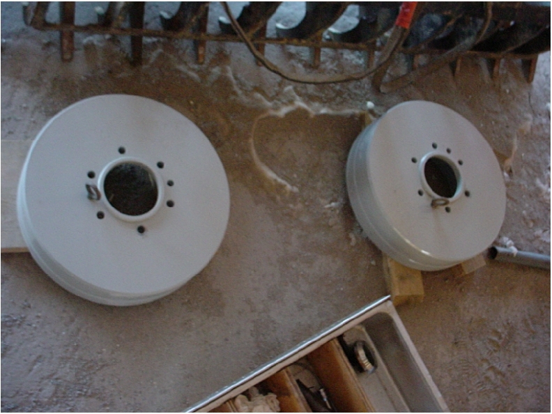

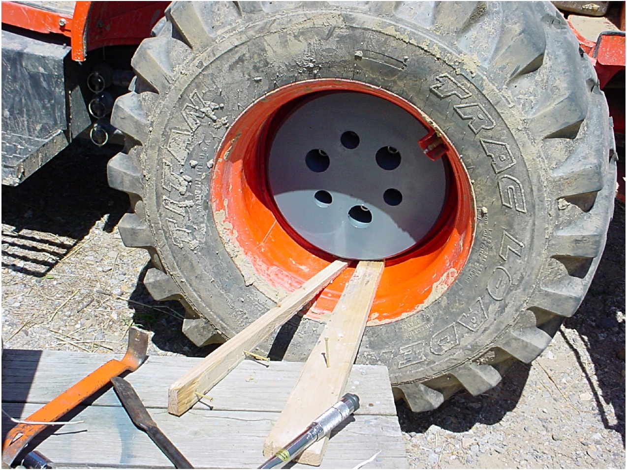

Rear wheel weights Continuous Cast Iron Bar Stock Leader and Steel Alternative and find a machine shop (weights in inside of wheel will serve as Spacers)
2" rear wheel spacers if available
