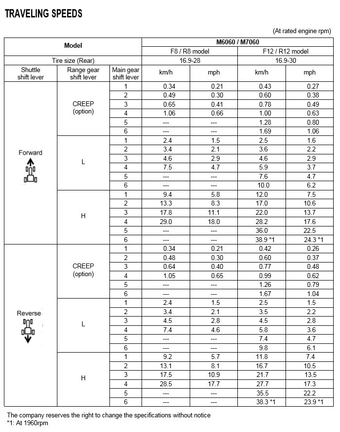

Aug 26, 2018 / M7060 ground speed #1 Bigpuddie Gold Member Joined Aug 16, 2018 Messages 457 Tractor Massey Ferguson 4707 Hello. I aim looking at a used m7060 with a 8spd. Anyone know what the top gear road speed is? I know the 12 spd is 24mph...

Aug 26, 2018 / M7060 ground speed #2 deserteagle71 Elite Member Joined Dec 30, 2017 Messages 3,022 Location northern Nevada Tractor John Deere 2020 diesel, Kubota M7060HDC12 Here's the chart from my owner's manual. Looks like the 8 speed is good for about 18 mph.
Aug 26, 2018 / M7060 ground speed Thread Starter #3 OP Bigpuddie Gold Member Joined Aug 16, 2018 Messages 457 Tractor Massey Ferguson 4707 deserteagle71 said: Here's the chart from my owner's manual. Looks like the 8 speed is good for about 18 mph. View attachment 568460 Click to expand... Very nice of you. Thanks

Aug 27, 2018 / M7060 ground speed #4 Farmer495 Veteran Member Joined Aug 18, 2014 Messages 1,691 Location Nova Scotia, Canada Tractor CaseIH / MF / Kubota It will be closer to 20 MPH since it's at "rated RPM" and the engine turns a few hundred RPM more than rated RPM.
