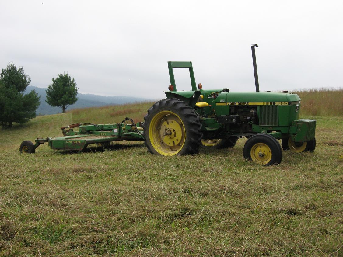

We run a Bush Hog 3008, 2 pt hitch with our M8540 and the best thing about the mower is the tires! The dealer ordered it with (used) airplane tires and those stay on top and roll easily over everything. In 5 years of hard use the tires have not been punctured.
Those tires I would suggest to anyone with a big, heavy mower behind.
Looks like the 1000rpm conversion kit is a winner, too!
Yep, as heavy as these cutters are it would be an issue in soft ground. I think the guy that owned my cutter previously did fiinish mowing and didn't want tire ruts or scalps so he added two more wheels.
