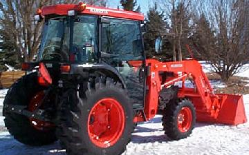

Well, the 5030 is going to get replaced or should I say upgraded so that I may purchase a discbine at a later date. I am agonizing between 2 Kubotas, the M105 and the M9000. Of course, both have cabs. I would never even consider an open station tractor of any make. I really hate to give up my hydro as it's ideal for haying but no hydro is availabe in the pto range I need.
I have lightly considered other makes but with Kubota's almost flawless record with me (5 Kubotas and one leaky and promptly fixed at no cost hydraulic cylinder), it's hard to consider another make. So, here they are:
M9000HDC3, 8x8 hydro shuttle with draft control, Ultra II cab with air, wipers, am-fm weatherband cassette, air ride seat, front and rear worklights, 3 remotes and a LA1251A1 loader with 84" quick detach bucket on R1's or R4's (my choice)
$44,500.00
or:
M105SHDC optioned the same, but 12x12 shuttle and the LA1301S self leveling loader and 1000/540 pto.
$48,500.00
I might add that the M9000 has the optional cast weight set on the rears and the 105 is without.
I realize this is probably a "little over the top" for this forum, but I thought my 5030 was over the top at first, but now I see many posters here are getting the larger L series tractors. Yes, the 5030 is for sale, though I do have an offer pending.
The 105 and the 9000 aren't surburban type tractors, but rather speciality ag. tractors. Not the kind of unit to keep in the garage, that is, unless your garage door was pretty high.
Kubota is coming out with a 125 horse to complement the 105 to agument their line of small to medium ag. tractors. The M9000 is their base model, medium sized speciality tractor.
