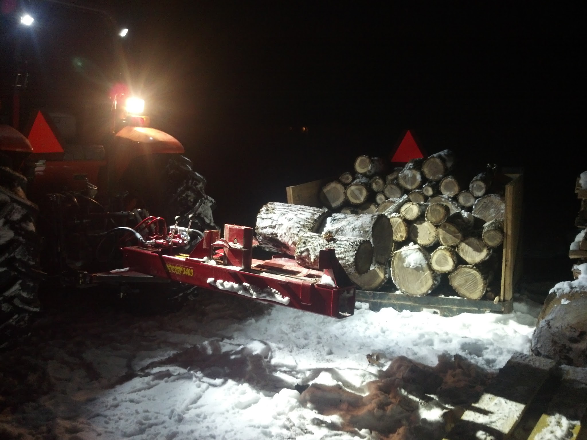

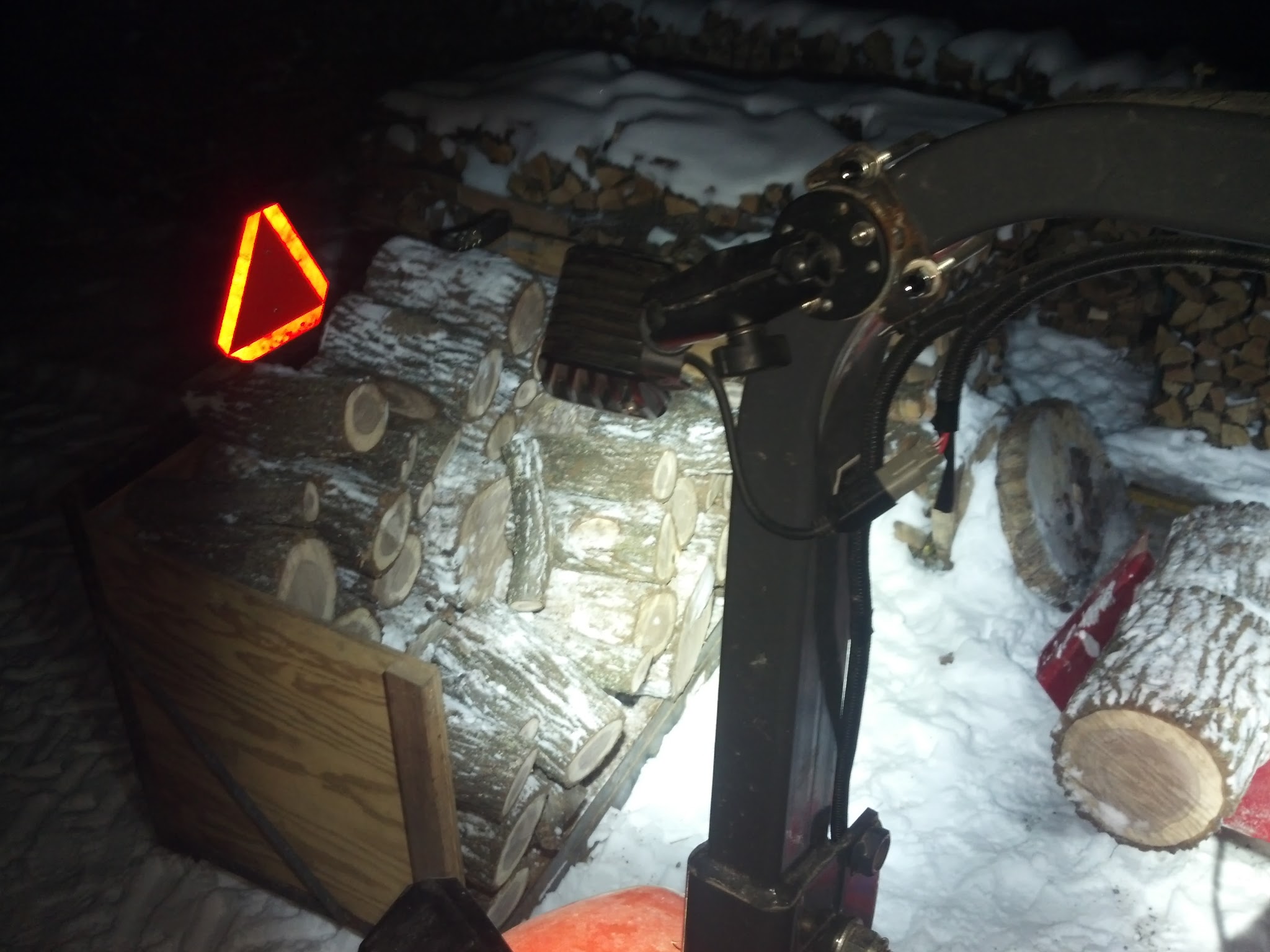

Yes their is actually factory wiring tucked away on both left and right hand sides of the tractor the power is live to both of these wires any time the ignition is on. The kubota light has a switch integral to the the back of the lamp housing. The stock kubota work light is 35 watts kind of sucks but is better than nothing i have not got around to replacing it yet. if need be the Rigid dually D2's i have can be turned to face backwards as they are mounted using Ram Mounts. Its about the equivalent of holding up a AA maglite next to a 55 watt headlamp on a car 2012-03-07_18-47-58_588.jpg2013-01-04_19-49-00_701.jpg2013-01-04_19-49-46_745.jpg
