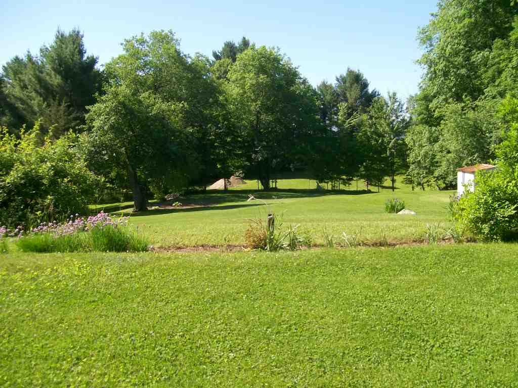

I am leaning towards a mowing attachment for my brother’s tractor. I haven’t had any trouble driving his tractor but all I have done with it so far is drive it back his house after he used it to move some root balls for me. I have found a couple local dealerships but they don’t seem to carry the machines that you have suggested. I will look a little further out but I don’t want to go to far from home, I live five miles out on a dirt road and it is very difficult and costly to get anyone to come out to make repairs. [/FONT]
[/COLOR][/QUOTE]
The rotary cutter that has been suggested mounts on the rear of the tractor, and has (usually) two knives that are free to pivot, or swing if they endcounter something that their mass, and rotational speed won't cut/break. They are usually about the width of the tractor, and a general rule is about 5 horsepower for each foot of width. One of these could be used on your brother's tractor. They can be found used, but are sometimes pretty beat up. New they run about $1000, more, or less for smaller tractors.
The "CUT" that has been mentioned stands for "compact utility tractor", and usually means tractors under 50hp or so. Some dealers are very good about transporting the tractor to, and from their dealerships for repairs, but certainly that is something to check on. Perhaps your brother could give you some input on local dealers, and brands.
I have "tamed" some of my land by first using a weedwhacker, or line trimmer with a metal blade, and then following carefully with a large garden tractor mounted mower raised all the way up. Areas that started out having chest high brambles are now clover, and grass by just keeping it mowed. I still have to go very carefully since there are many rocks, etc. but it sure is an improvement, and the deer like it too! Some of the area in the attached picture was done that way. (the area in the distance where the dirt piles can be seen) It doesn't have to be done all at once, and once the area is tamed a bit it's easier to keep it that way.
