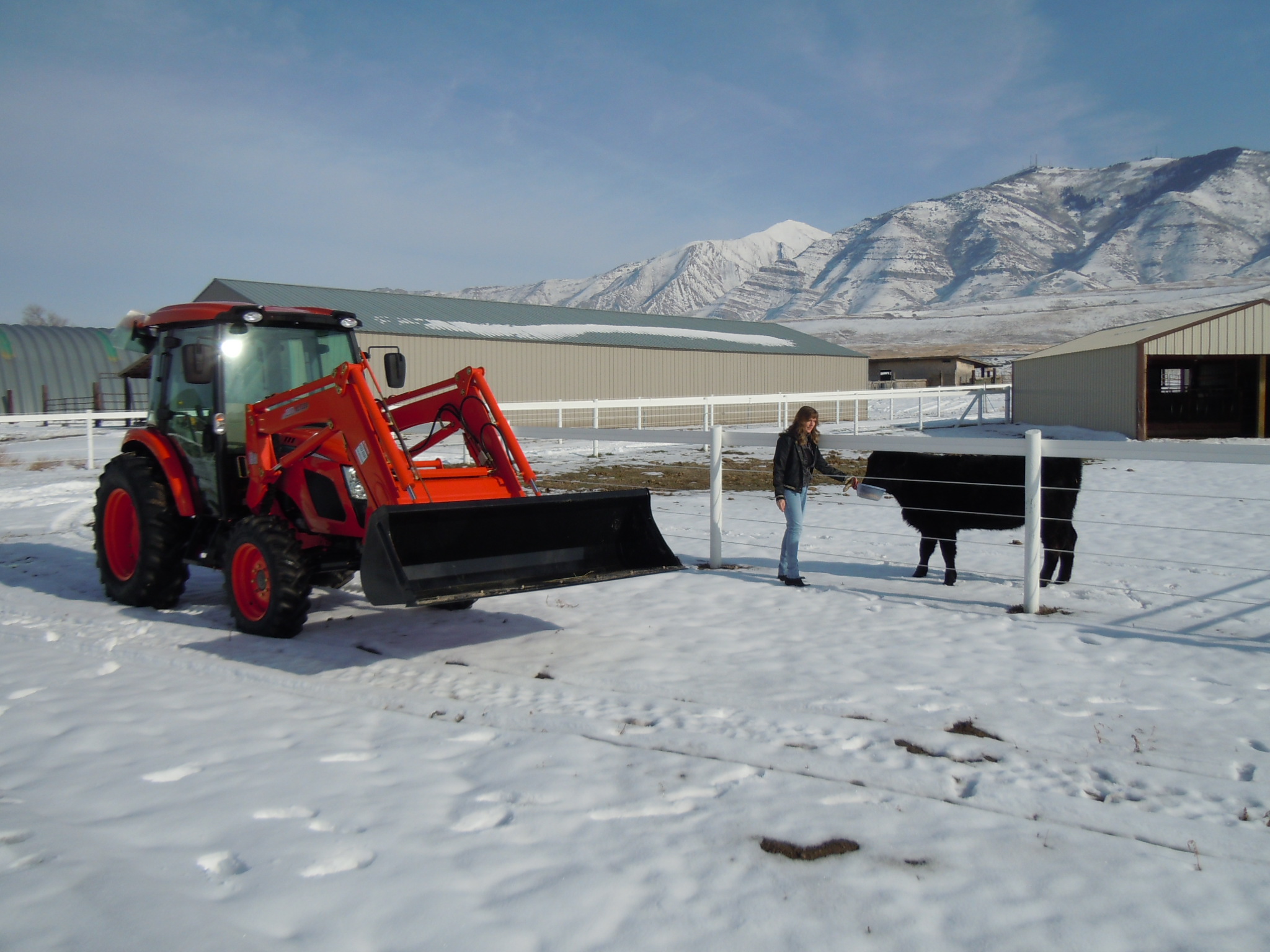

I first looked at the tractor you have, but my future plans involve more acres so I opted for a little more HP. I am sure we will both be happy for many years to come. DSCN1715.JPG

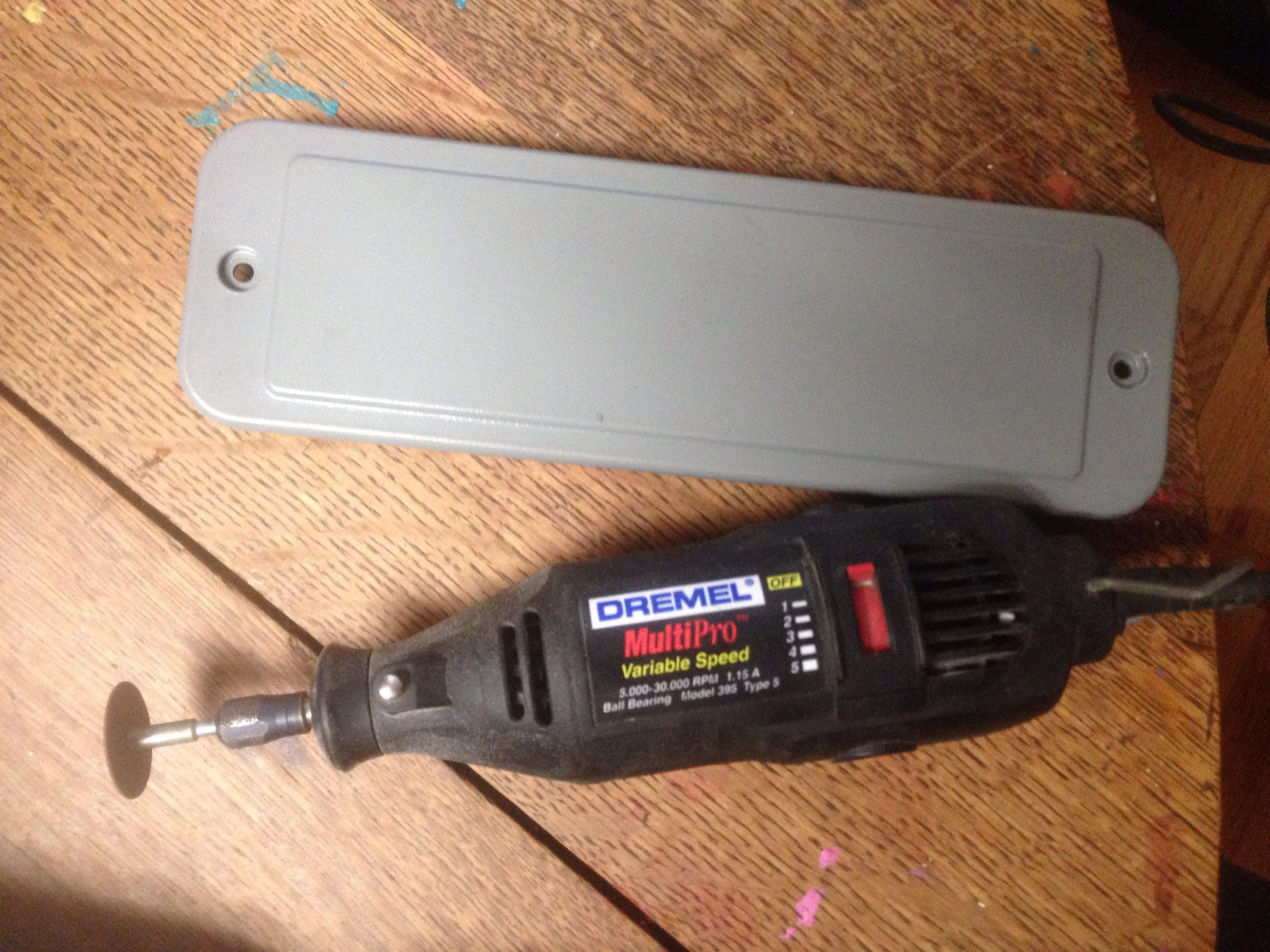

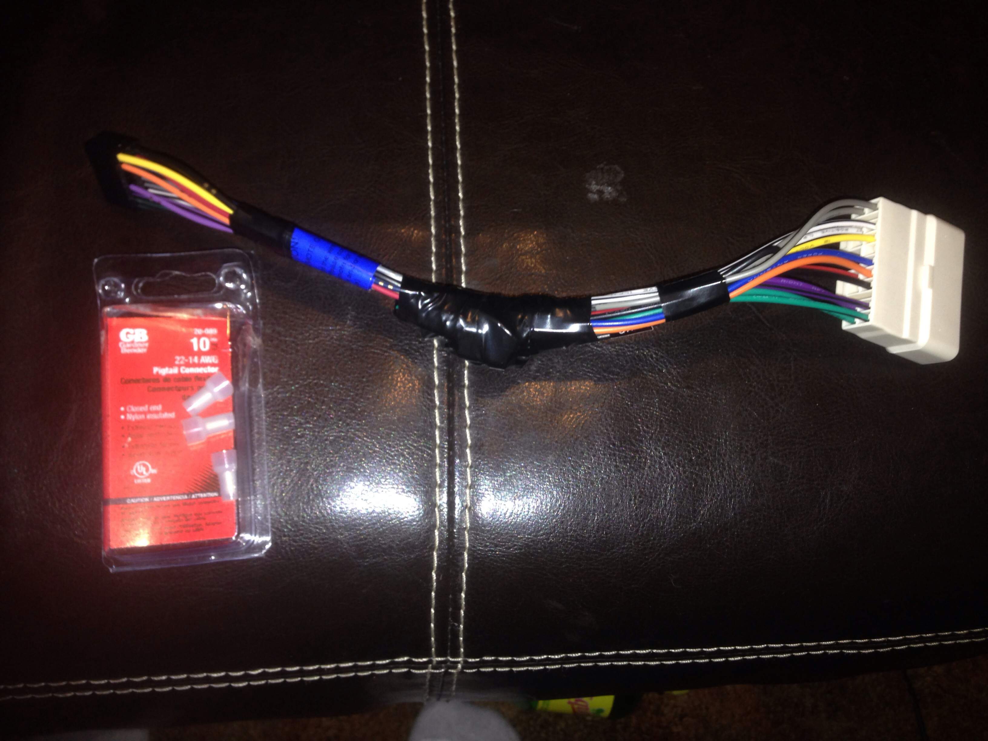

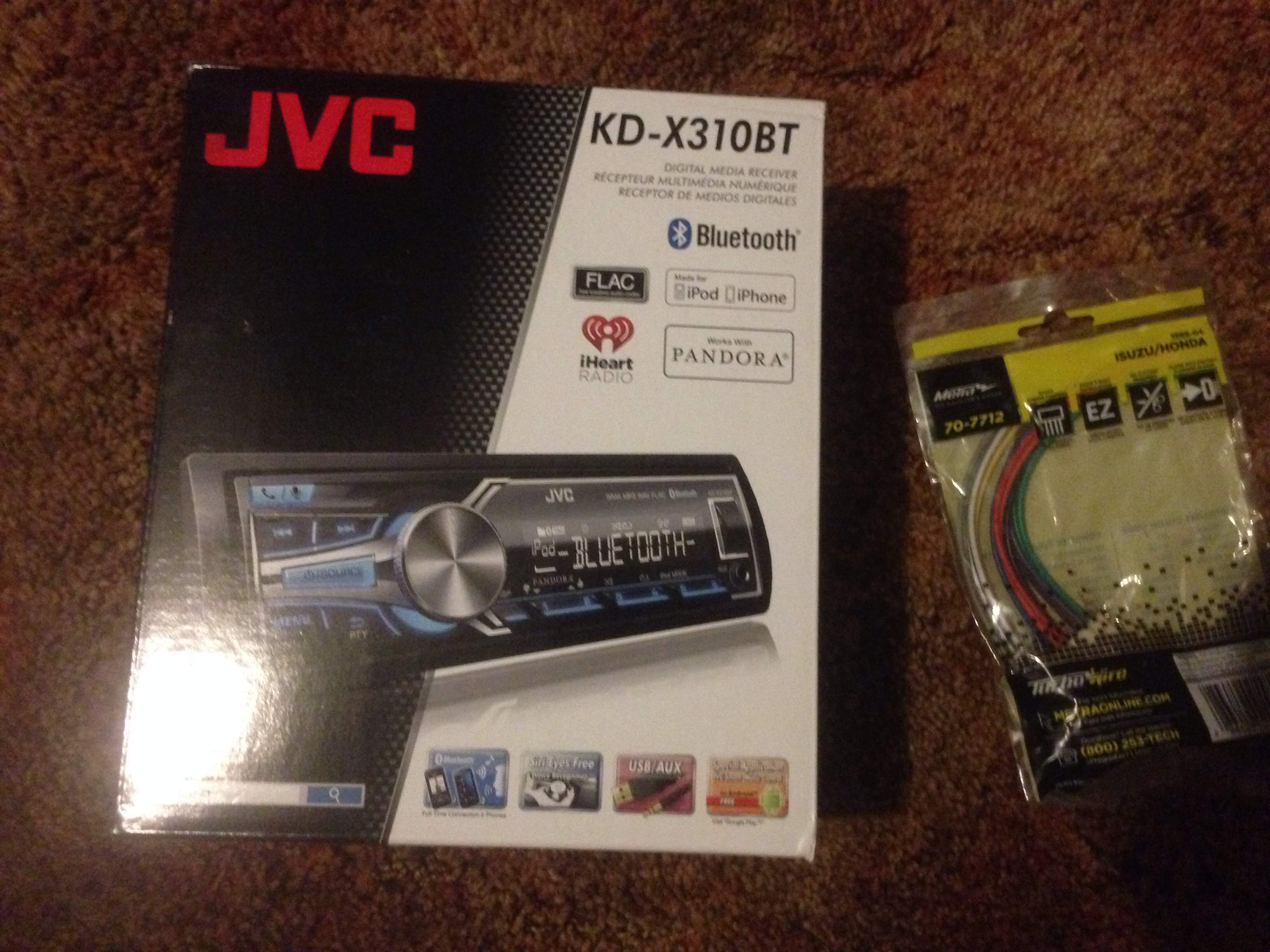

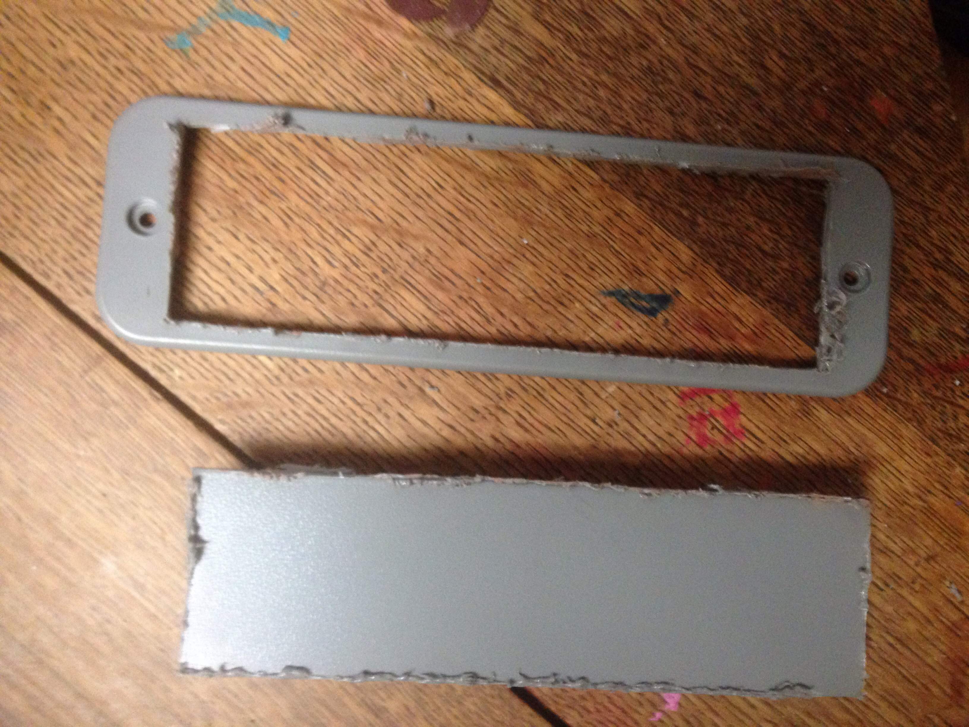

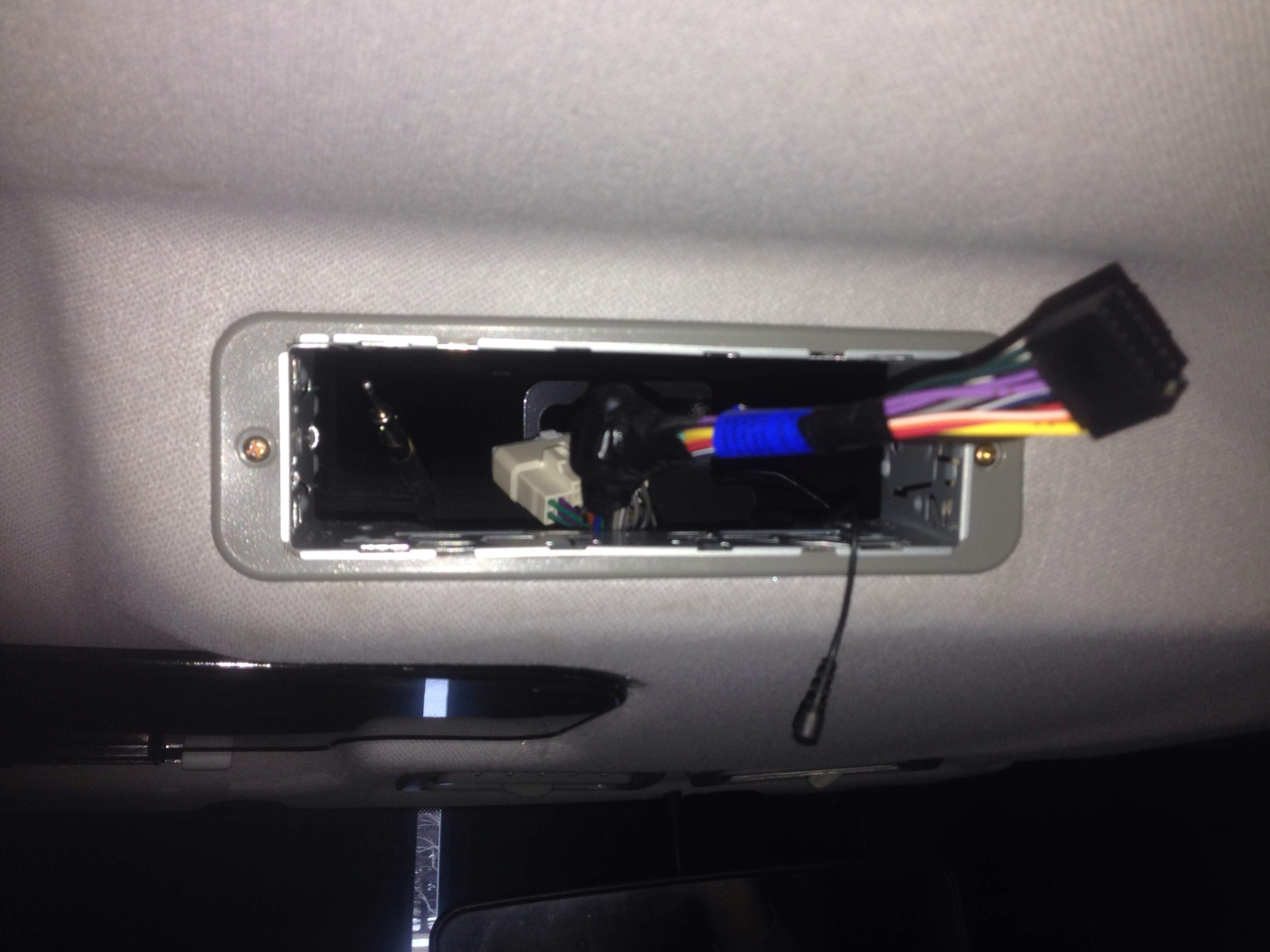

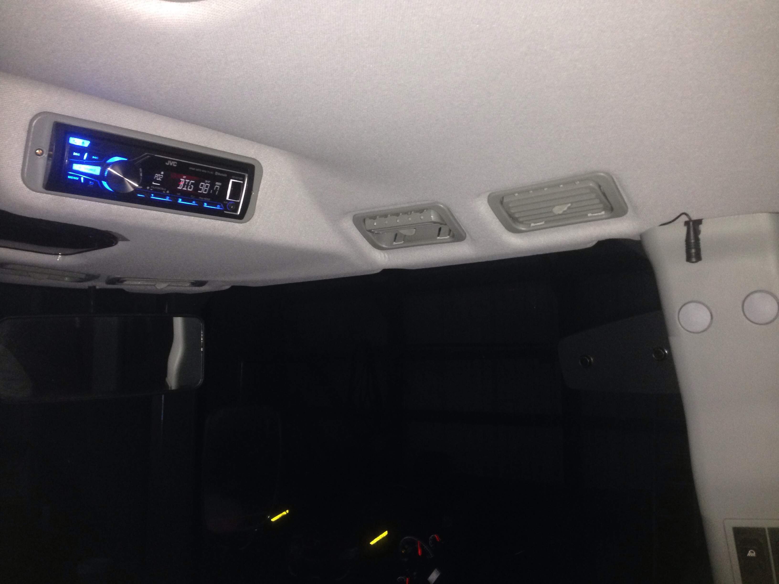

Finally got my radio put in. The harness that is mentioned in the NX radio harness thread works perfect. I chose to cut the plate that plugs the hole to fit the radio. I put the mic for the Bluetooth on the right side B pillar. image.jpgimage.jpgimage.jpgimage.jpgimage.jpgimage.jpg

Very well done! :thumbsup: How well does the mic work, with the cab noise?

My wife said there was a slight echo but there are adjustments for that. It's nice being able to control your phone through the radio. When someone calls there name pops up and the music shuts off.

That radio looks really familiar--except it got installed!
Next summer for me.
I got the idea from your thread. I didn't want a CD player and this was an inexpensive option. I did have to trim some of the fabric/headliner around the hole for the radio bracket to slid in.
   / Made my choice-NX5010 #38
Looks good, I did the same thing as you did with the factory blank cover, by cutting it out to fit the radio. I too had to trim the fabric and head liner a bit for the radio to slide in.

Forgot to mention, the one thing I did do different was hooked the factory speakers up to the rear wires on the radio. My thinking was if it wasn't loud enough or if I wanted better sound quality I would build some fiberglass enclosures to hang from the had liner up front. With the speakers where they are they are plenty loud. The sound quality is something to be desired. I'll probably start looking for replacement speakers.
