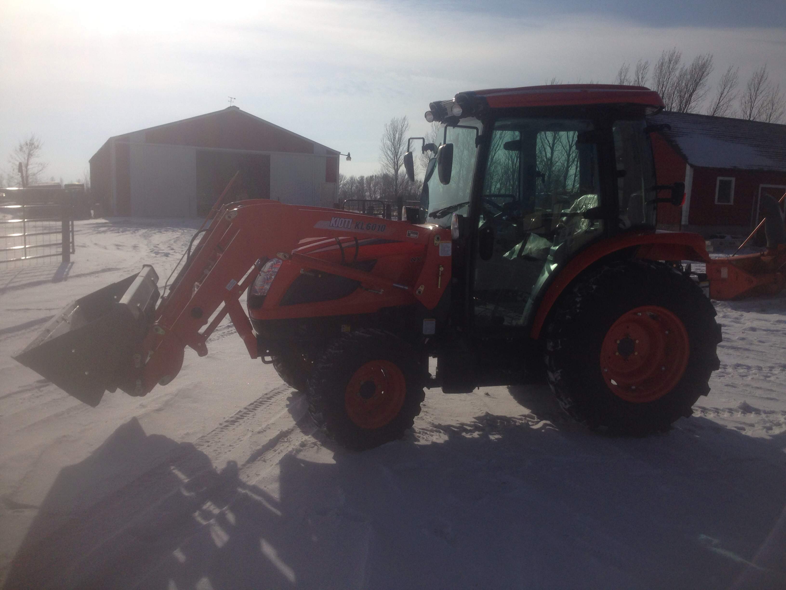

Finally got to bring it home today. And one of the little guy driving it home.
