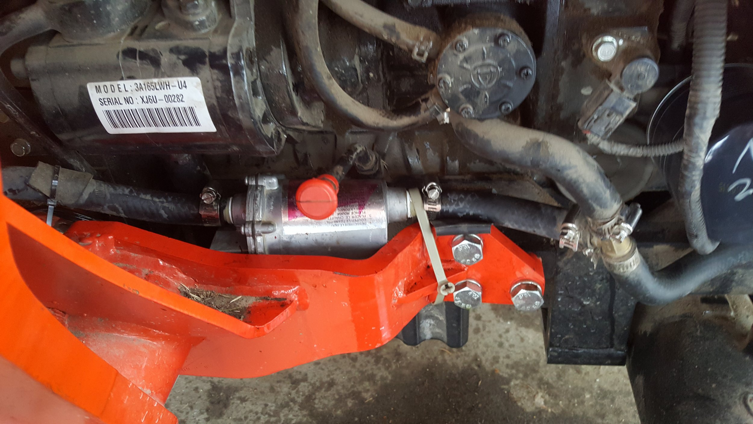

Block heater in my bachhoe melts the snow on the hood. As of this morning I seen my circulating heater in the tractor does to.
