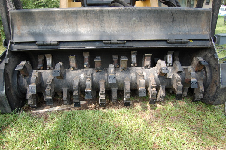

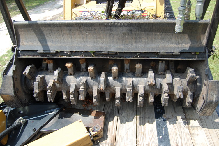

As much as I hate to dig up old posts, here is some new info... I now have 135+ hrs on the "new" mulcher and yes the teeth are starting to show. I've decided to invest in a set of the teeth (knives) from the first page for my magnum. They can be resharpened 3 or more times before replacement. So it'll be like a new sharp set of teeth every 50 or so hrs instead of continually dulling the carbide hammers to 150 hrs. and the overall cost will be cut in half. at least thats how my figures have been working out.
Will be installing them on Wed so I will let yall know!
Also I heard rumor of a way to turn up the HHP from the current @78 to the max of 99 HHP by doing some mods to the pump. anyone have any experience? was told that the pressure at the head would be over 5K psi instead of the stock 3.8K psi
That is almost Supertrak 120 numbers!!!!
