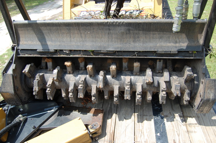

Ok boys the ones you've been waiting for ...head before...

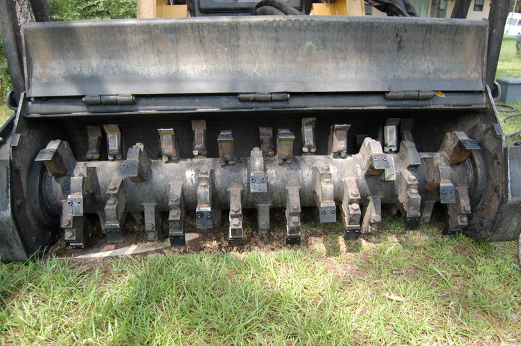

And after....

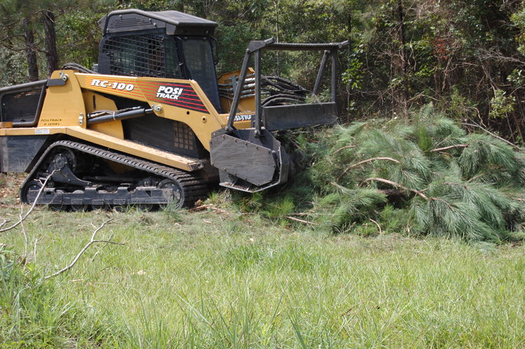

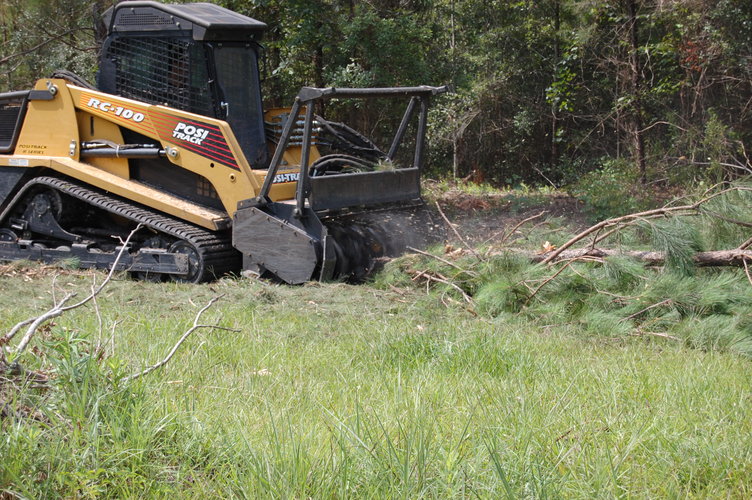

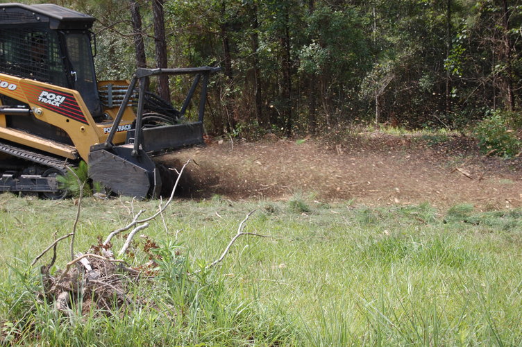

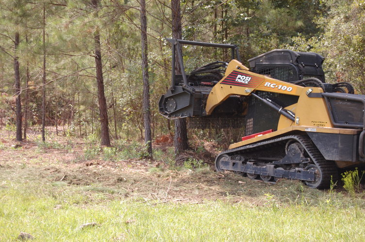

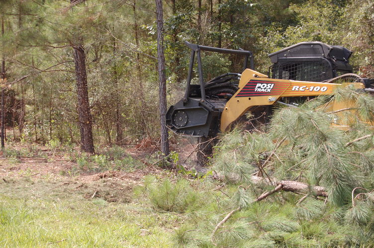

Here is some action...keep in mind the camera is quick but not as fast as the new improved Dirty-Mag:D

I am now putting out 99.8 HHP!!!!!!!!!! (Stock is only 65.8)
:D
This is one bad mutha! Today i ground alot of 20"+ pine stumps and stuff I would have normally went around. My production went up almost 2-1 and the final product is amazing!
Gyro-WHAT?:eek:
   / Magnum Mulcher Improvements? #30
Wow Dirty W, that looks good. How are those teeth holding up so far? I would think those small Allen bolts would shear after some time but I'm no engineer.
And what's the secret for more HHP? and how does it effect the engine and hyd pumps? Does it run hotter? I'm always game for a litttle tweak to my set up...;)
