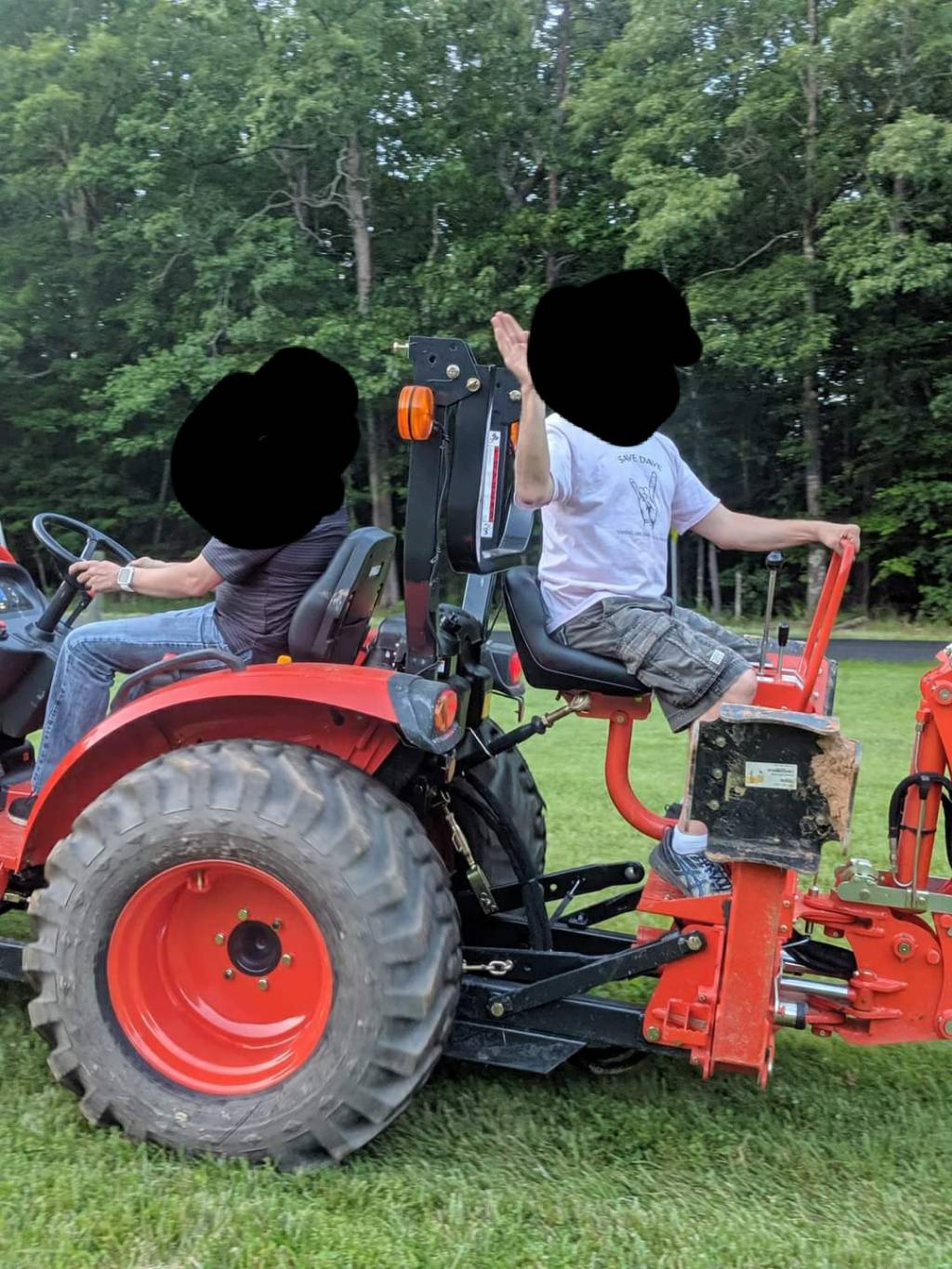

You do bring up a point that I forgot to mention about having to remove the 3pt arms on the Kubota, although this only takes a couple minutes at most, now if you're switching between BH and 3pt constantly I could see it being an issue.
The drawback to being able to leave the 3pt arms on the Kioti is that it sets the BH further back lower which reduces the ground clearance and approach angle.
Once again not an issue if you work on fairly flat areas or have a pretty low angle trailer if you need to move it with the BH on. Just something to consider while you're looking

Here's a picture of the BH mounted on my friends CK2610 just to get an idea since you might not be able to look at one in person. 20210207_194514.jpeg

I have a CK4010 with the KB2475L backhoe, have not had any issues mounting it to the subframe, and backhoe digging stress is distributed equally to all four points on the tractor frame. That tractor can really rock back and forth when your digging hard with a backhoe. Mounting takes just about 5 to 10 minutes, and the 3pt arms are not required to be removed.
