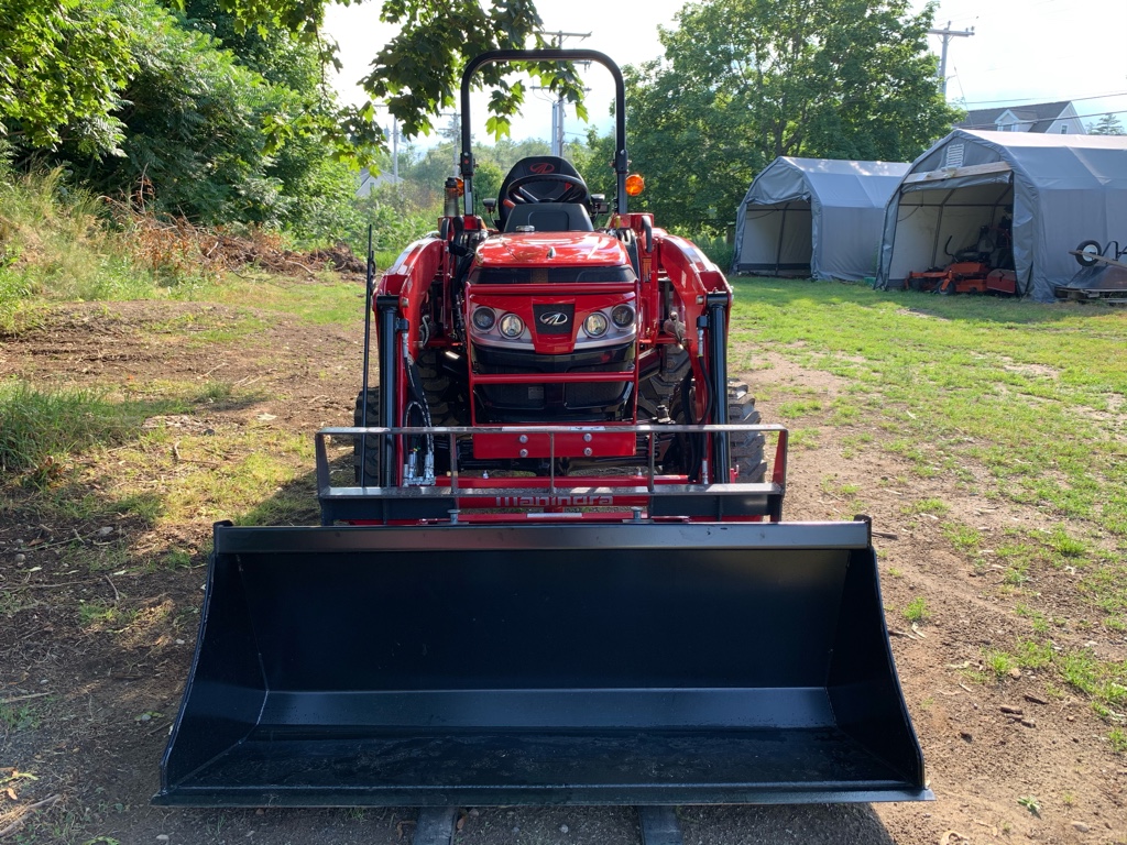

Tell me about those temporary garages in the background of your earlier photos. Are those for tractor & implement storage? What brand/style? Had 'em long? Would you do 'em again?
I'm starting to think about adding more storage. The 2k sqft man-cave with vehicle lift is not quite in the cards yet.

The Quonset Huts, those are great! Those are the “Cover-It” brand, both are 12’w 10’ h 28’ long. I store my boat, kids bikes, assorted summer fun stuff in one of them....the other has my “someday project car”, 68 Cougar XR7, all my wheelers, and my lawn mower. Any implements not on the tractor just love outside...lol. Tractor gets a nice cozy spot in my shop (I’d post a pic, but the forum limits the size to ridiculous small so that’s that).

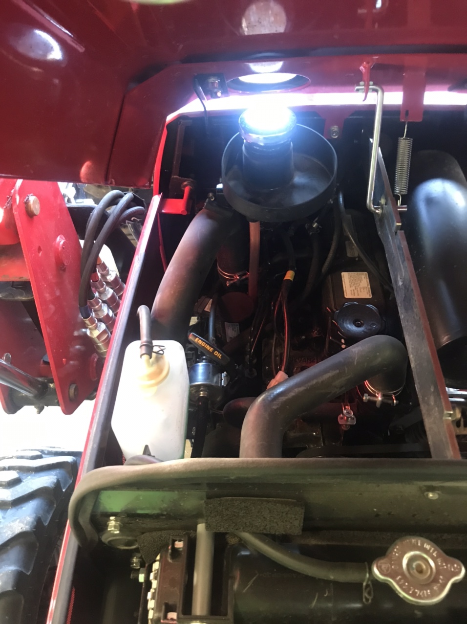

Oil dipstick access. You have to pull the right side engine cover to check the oil. Not a huge deal, but I would have thought that they would have engineered a way of doing it through the open hood.

As for the oil dipstick being hidden I used an old S10 dipstick and tube to extend mine up near coolant reservoir. About an hour with a tubing bender and now I can check just by raising hood IMG_2779.JPG

Awesome suggestion on the dip stick! I think I’ll fab something up like that too!

Lol....I’m just now getting around to this dipstick mod on the tractor. Would you possibly know what year/engine that S10 dipstick came off of? Going see what’s around/what I can find.
