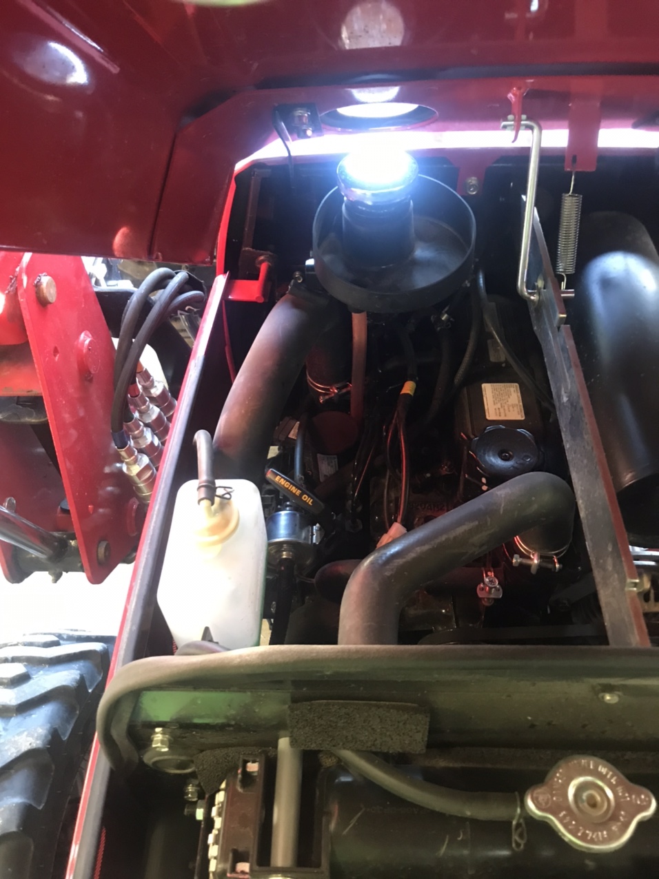

As for the oil dipstick being hidden I used an old S10 dipstick and tube to extend mine up near coolant reservoir. About an hour with a tubing bender and now I can check just by raising hood IMG_2779.JPG

Yeah, I was working the tractor back and forth when I tweaked the 4WD lever. Nothing huge, but I’ll be more cognizant of it now.
Awesome suggestion on the dip stick! I think I’ll fab something up like that too!

Lol....I’m just now getting around to this dipstick mod on the tractor. Would you possibly know what year/engine that S10 dipstick came off of? Going see what’s around/what I can find.
Thanks!
