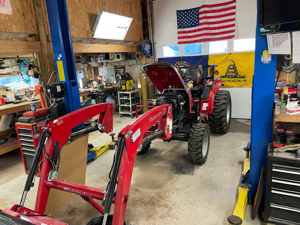

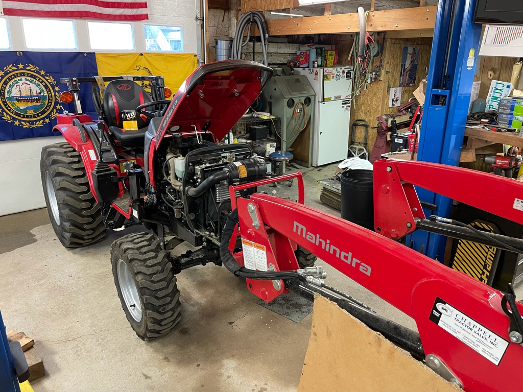

Well it’s finally time for my 50 hour service. Got all the filters and oil ordered up (~$160).
Have to wait a week before it’s all here, so in the meantime I greased everything, pulled the loader off and all engine panels off, pulled the battery (terminals were all corroded, hold-down bracket was corroded). Cleaned all of it up, painted the bracket and rods, greased all connections and put it back together.
It still running great, strong machine for its size!

Did the font axle fluid tonight. Still waiting for filters before jumping into the motor oil change.
Took the loader off, so much easier to get to everything!
