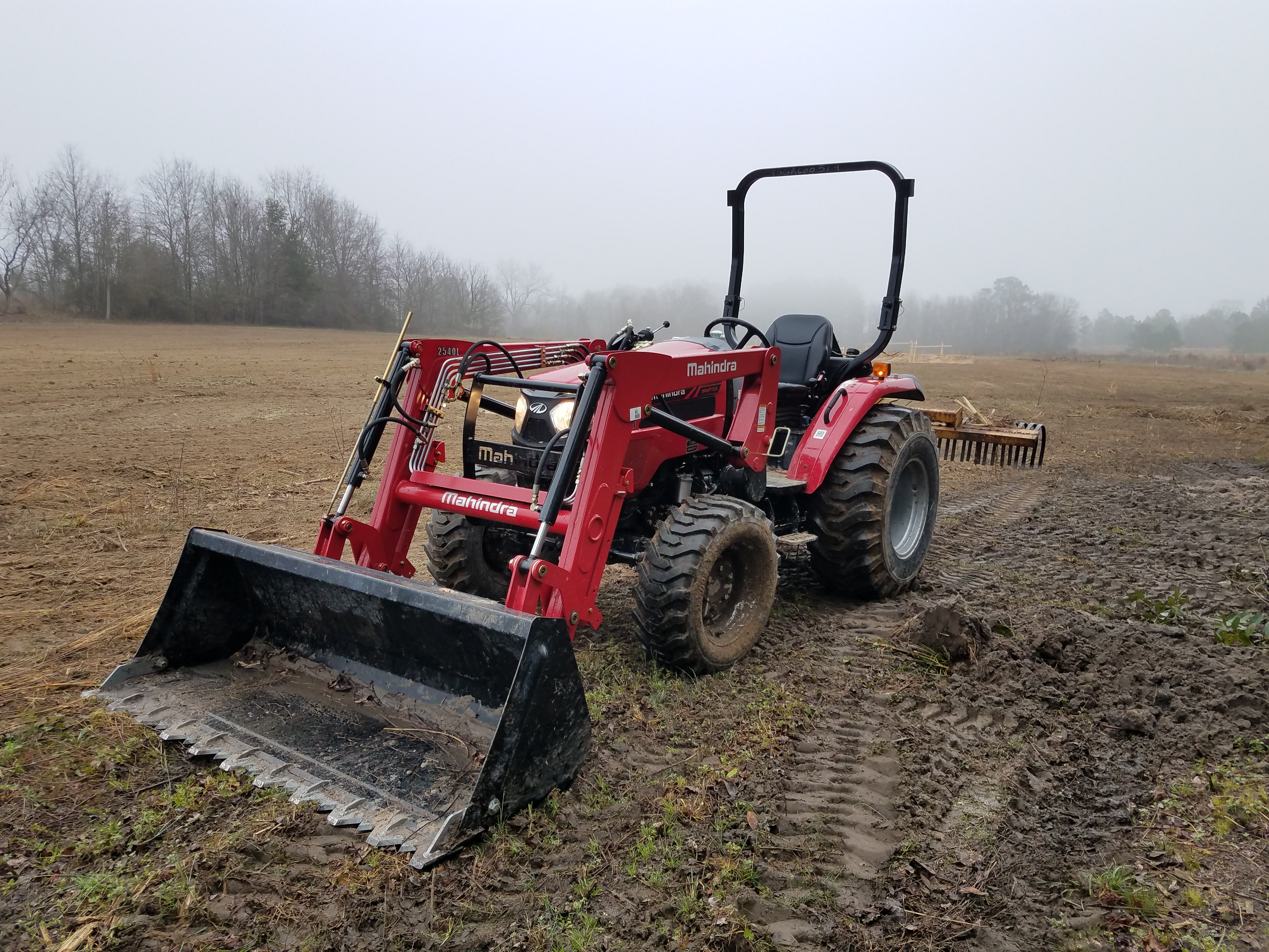

I will pick up a grapple used most likely. Whatever I can find cheap 66" wide to match the bucket width I'm used to. Up to 26 hours on the meter. Got my tooth bar installed. It's sweet on small trees, rips the larger ones right out the ground. I love it.
   / Mahindra 2545 on sand #76
Weight and toothbar are your friends for moving dirt. Helps to have a decent loader.
My L39 is about at its max weight for is power. I wish it were around 50 HP.
