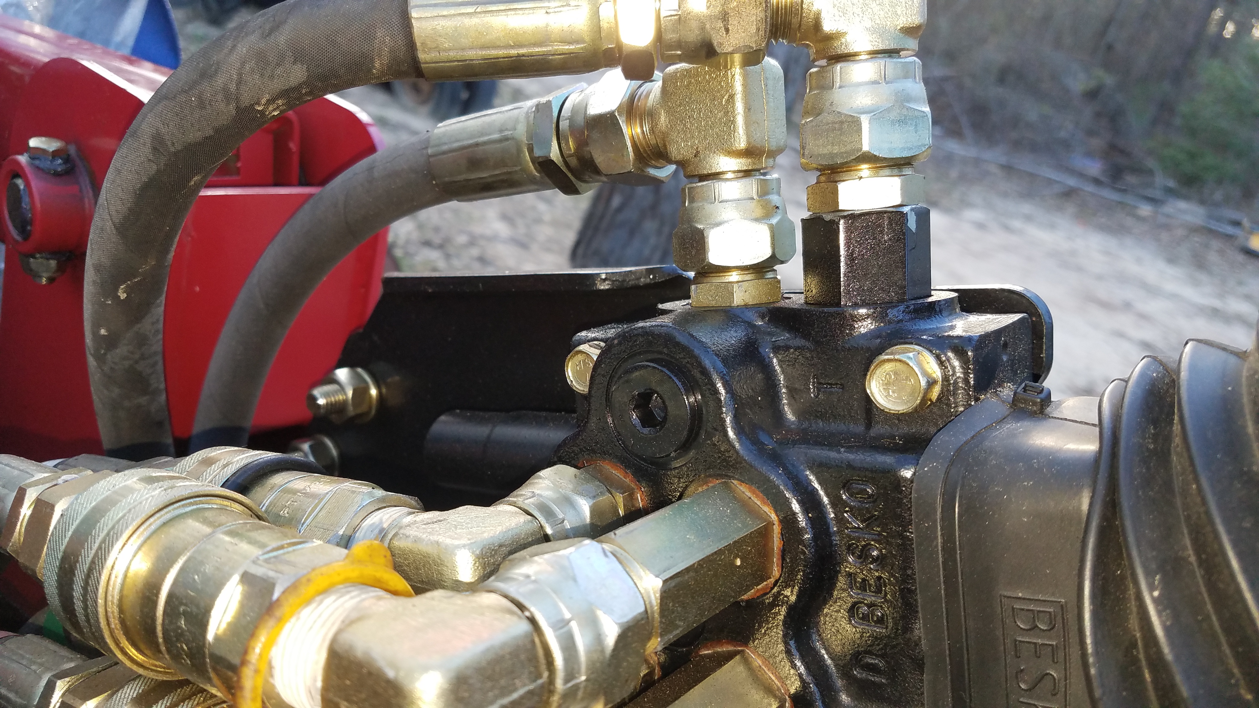

I mocked up my toolbox mount today. Drilled some holes, still need to paint the mount. Not having any storage is driving me nuts.
I bought a hydraulic hose at the local hardware store earlier today to help me figure out the correct lengths I'll need to go between my two valves. Also got a block of steel for the standoff.
Everything is in pieces but i can see the light at the end of the tunnel..

Well I can't find the manual for the factory FEL valve. There are two hoses on top, one on the bottom. One of the ones on top is labeled "T", i'm assuming this is tank. The bottom is labeled "P". I'm not sure if P would be pressure into the valve from the pump or power out to the 3pt hitch.

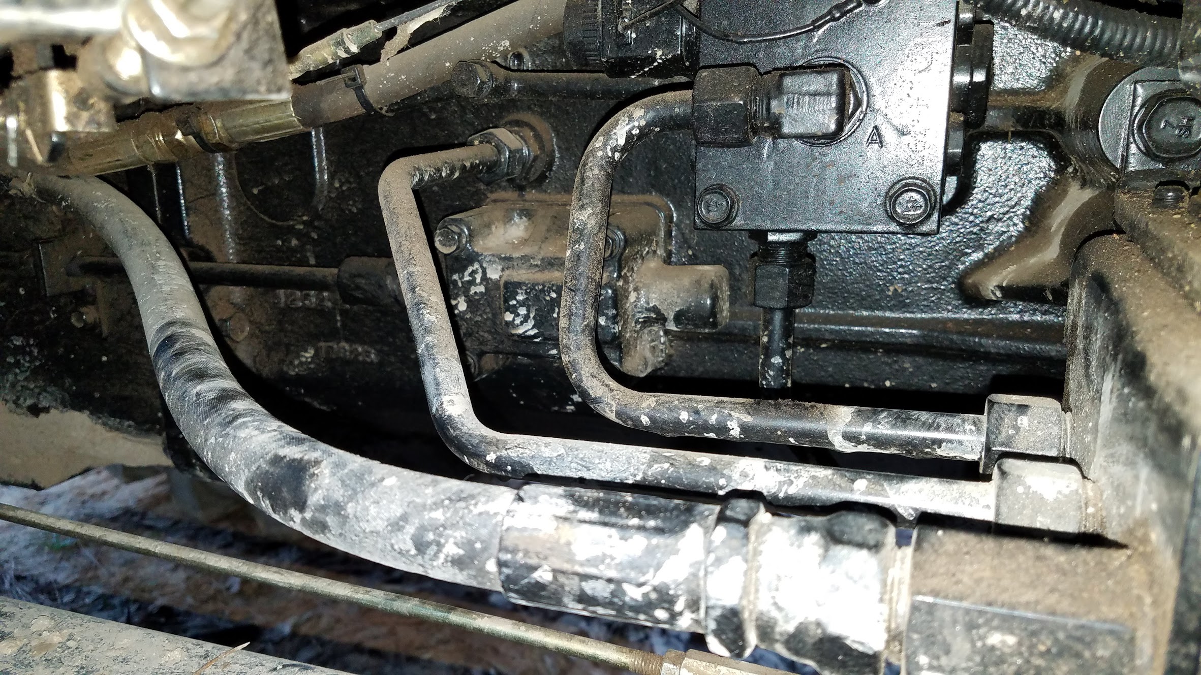

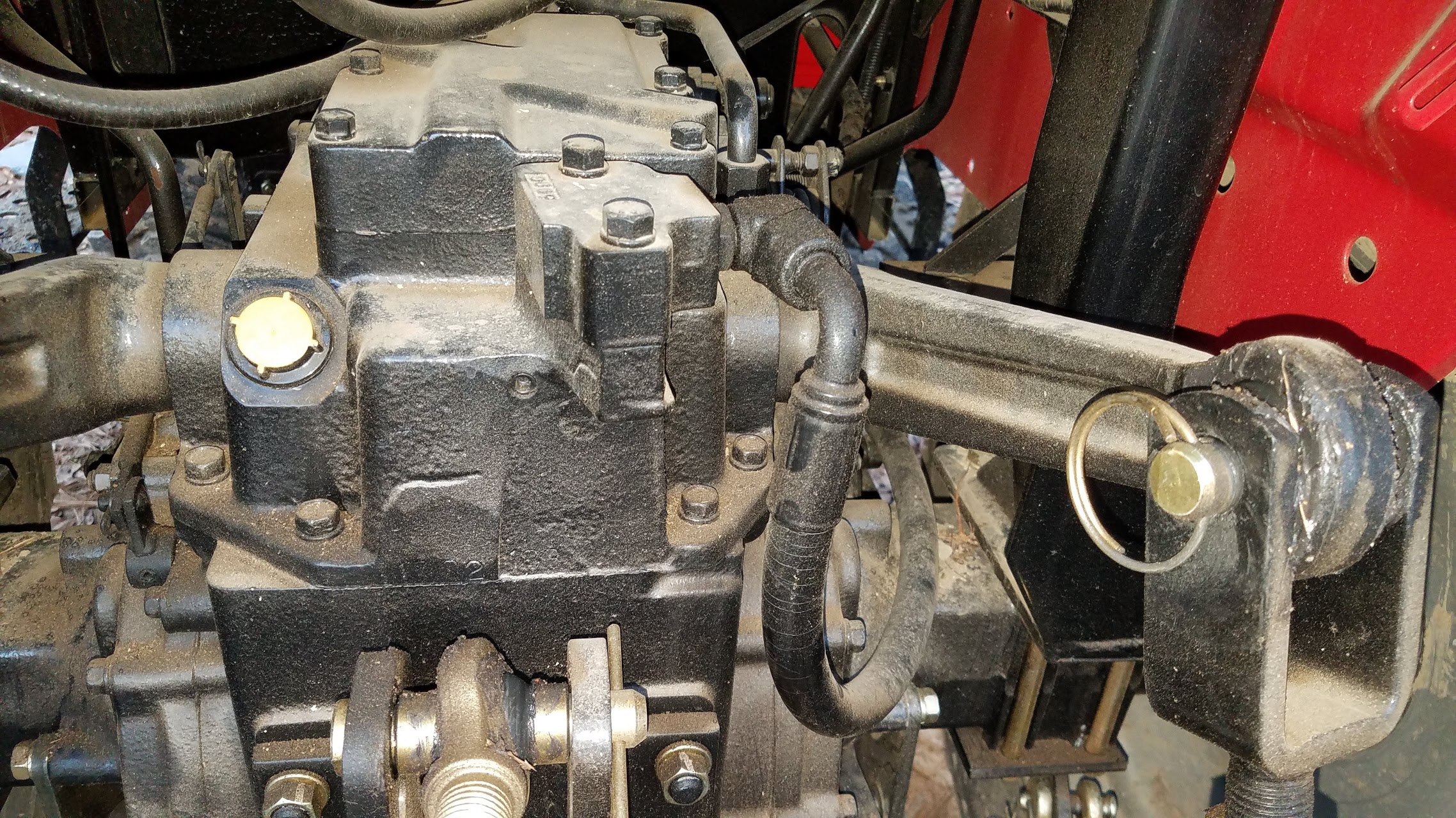

Here are the three lines that I need to identify. One of these should be output from the hyd pump, one should be tank return, and one should be power to the 3pt hitch.
The one that goes to the rear of the tractor attaches at the back.

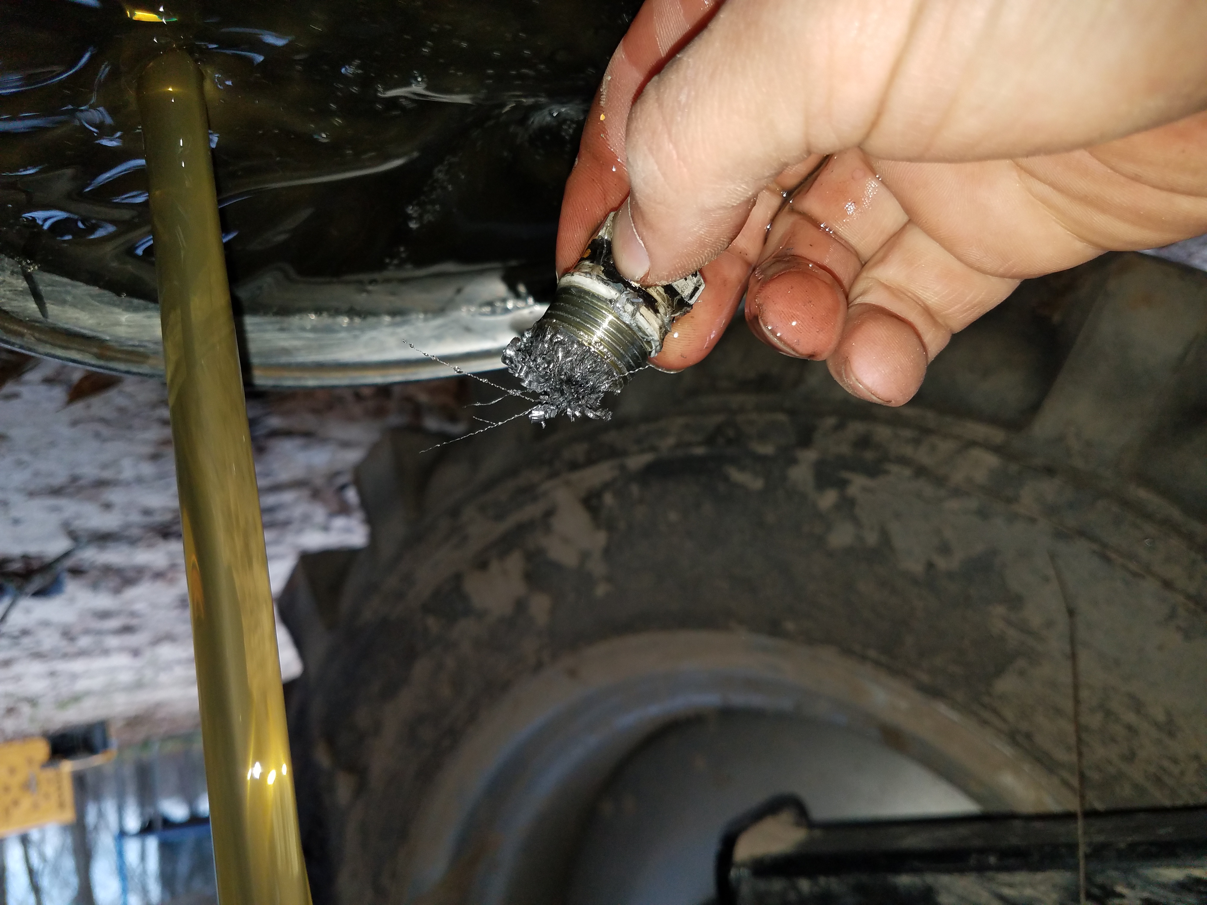

So I just drained the trans oil. Does this thing not have a filter?? It is unbelievable how much stuff is suspended in the oil fluid. I kept filling maybe 1.5gal container and dumping it into a larger bucket. Every time i could see the color difference between the fluid at the top and the fluid at the bottom of the small container. The drain plug looked like an over-fertilized chia pet.
IDK, i just didn't expect the fluid to actually have seemingly suspended media in it.

The line going to the back is ware a set of remotes would hookup. And yes you do have a hyd filter.

Fluid color difference could actually be from the 3qt of 80w oil I put in there..
Drain plug
Lol I've seen automatic transmissions with 100k on them with less steel in their filter screen.

Ew... thats a pretty gross accumulation of metal on the drain plug there. Some here might call that "normal" for a new tractor, but it sure doesn't make you feel good. You have the machine and the owners manual.... is there a hydraulic filter? Surely there must be. Might as well cut that open when you change it out and see whats inside.
The key is to see whats in your hydraulic oil next time you change it. Hopefully almost nothing.
