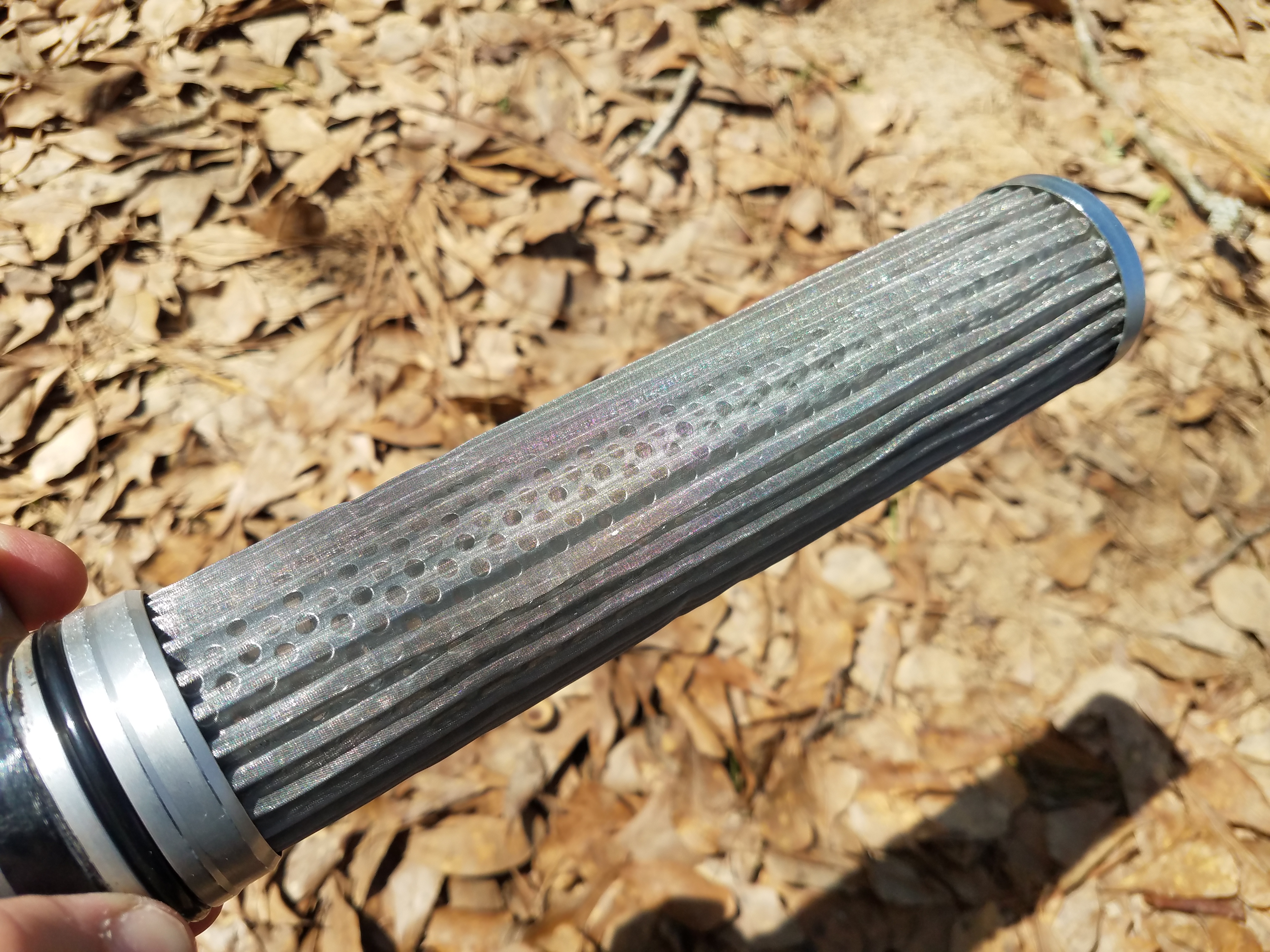

Wait.. I'm looking up the part number for the hyd filter and it appears to just be a screen?
PN: 16705105000
If that is the case, no wonder the fluid looked terrible and like it hadn't seen a decent filter. Now I'm beginning to wonder if I should make a dialysis setup to filter it further.. LOL
I will seriously make an inline filter if there isn't anything better than that screen. That seems ridiculous. I hope I'm misunderstanding something.

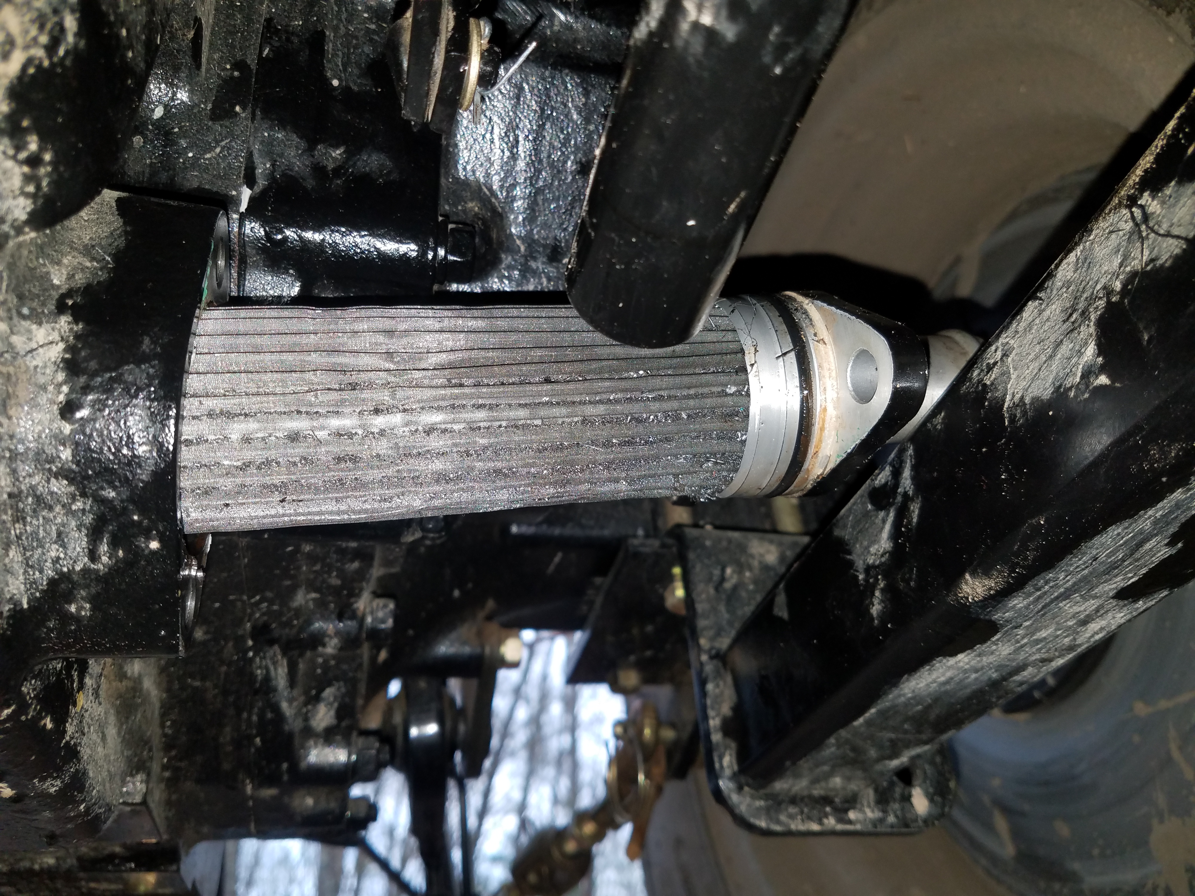

So it appears there is no transmission filter, just a pickup screen. Unless I'm missing something. I called the dealership about its location, the mechanic wasn't sure off the top of his head, he had a subordinate call me back earlier this evening. He said it was under the left floor panel. I found it and went to pull it out..
Of course you have to remove this front end loader arm thing to get it out. I removed the FEL arm thing and plan to spray it down with brake cleaner before putting it back on.
Doesnt look terrible on the inside.

that screen does require some other things to be removed before you can just pull it out, my brother is a mechanic and we had an interesting time doing all the filters and fluids the first time. I had a little bit of stuff on mine when I pulled the plug as well not as much but still some metal. I have changed the motor oil twice and still get some build up. I have been told the reason for the first 50 hour fluid and filter change is to get all these machine shavings out of the machine. The manufacturers don't spend a lot of time cleaning the machined parts like they used to and the first set of maintenance changes are to help remove these impurities and pieces.

I cleaned the screan real well and put it all back together.

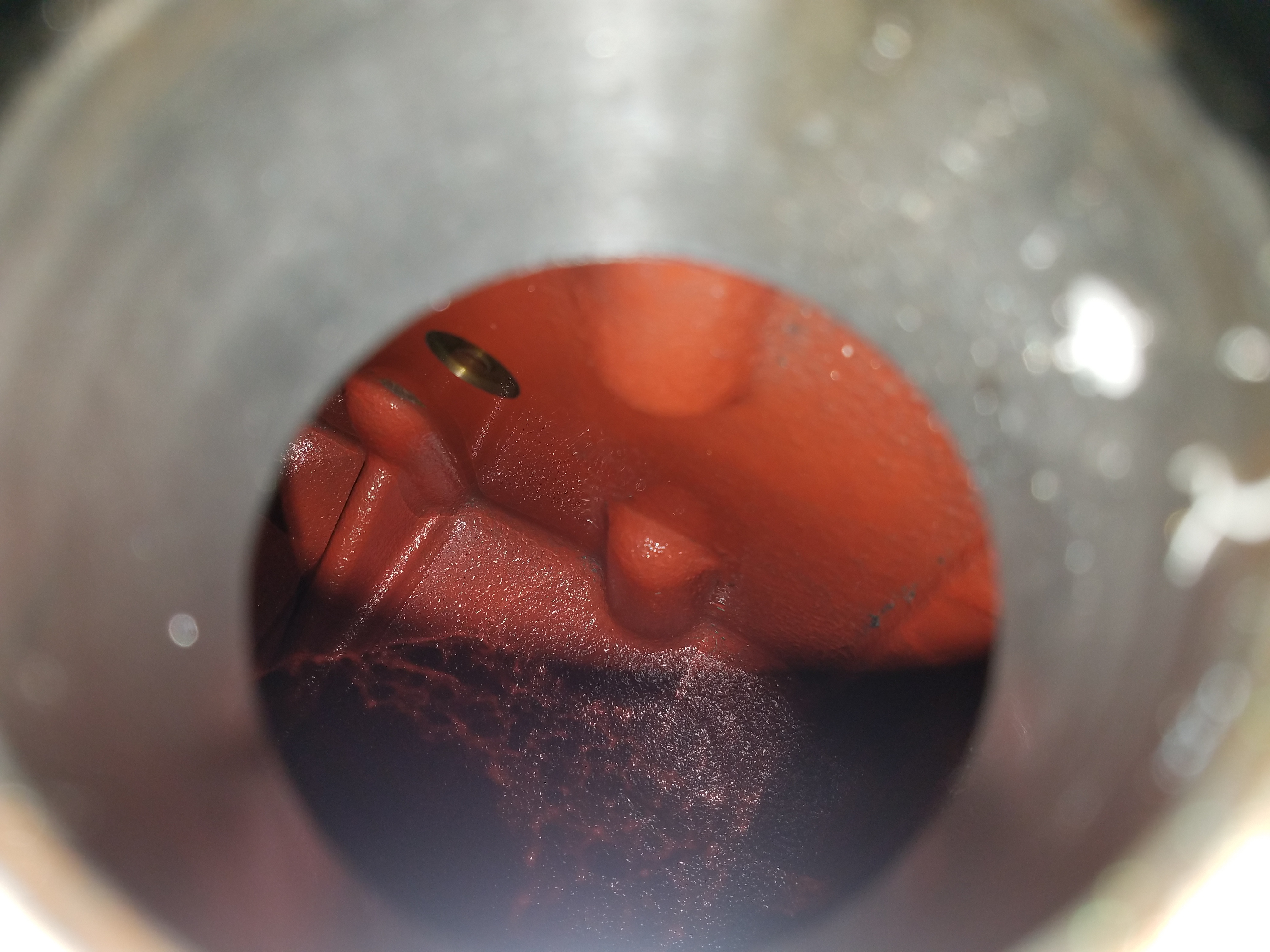

Manual says the transmission case holds 9.25gal. I ordered 12.5. One container of 2.5gal was lost in shipment somehow so I ended up with only 10 gallons of fluid. I went to order more off amazon and the price has gone up $20 per 2.5gal container. Sigh.
Anyway, adding the 10 gallons didn't even come up to the sight glass. I'm not sure how that would be the case before the tractor had been started and the hyd pump had been run.

Youre right - - Loader would have no effect on oil change level until the loader is operated afterward.
Are you absolutely sure the level is not above the window, eliminating contrast?
What does the dipstick indicate ?

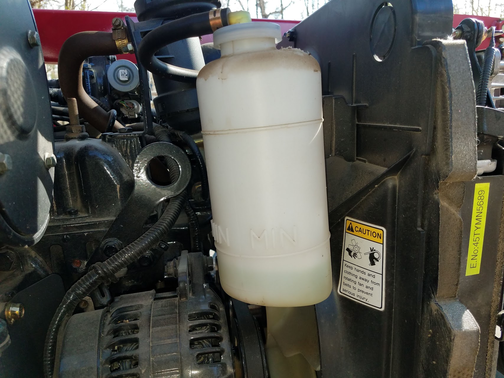

Your coolant shows almost perfect for a cold level. ... About 4oz low maybe. It should be about an inch above the bottom line. - - Check all the hose clamps.

I'm 95% certain about the hyd fluid level. I was watching the sight glass as I filled and even got my face a couple inches from the sight glass, squinting, trying to ensure I wasn't seeing through the fluid. I'll double-check this evening to be sure, though. I'll post back if I'm wrong.
