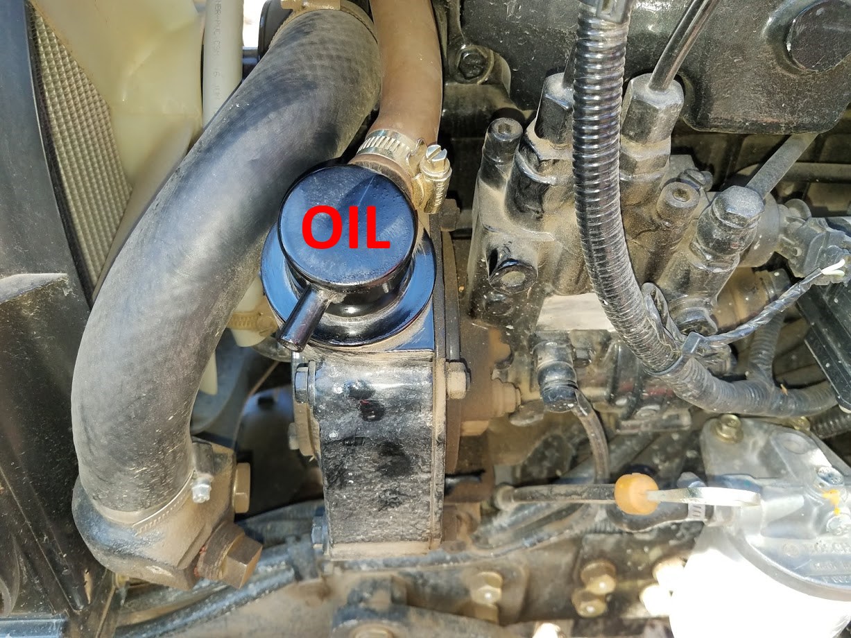

Where is the dipstick? I looked all over for it - around rear, around seat, under floormat.
Its sad that I actually had to google where to put the engine oil. I would have never figured out to pry that cap off. First cap I've ever seen that didn't say "OIL" or have an oil symbol.

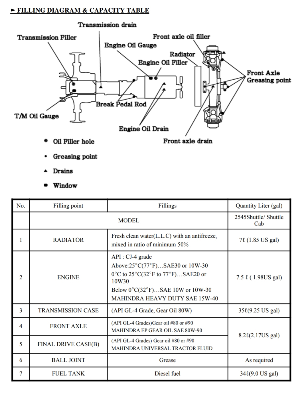

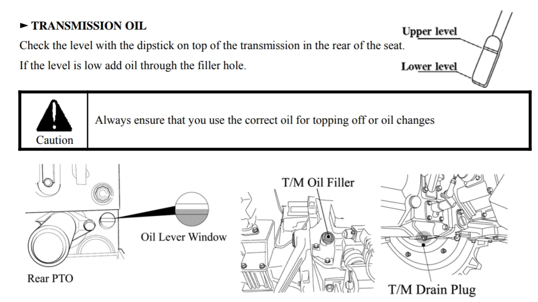

To add to the trainwreck this thread has become, here are the items in question out the manual. I wonder why you use the dipstick to check tranny fluid level if there is a sight glass?
Iv been thinking you had one due the reference in this post.​

Maybe I need to slide the seat forward to see it? It is already nearly all the way forward, I didn't see a dipstick. Heck, I even looked all on top of the housing from the left, right, and rear trying to find something resembling a dipstick. I'll look again this evening.

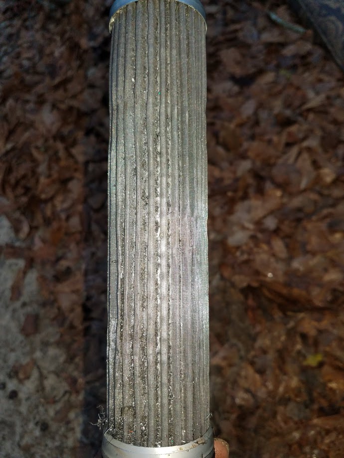

As far as the transmission screen not filtering small particles, my observation of the oil is just based on the likely 100 oil changes I've done in my lifetime between at least two dozen different vehicles. I've never seen oil out of an engine that varied color between the top and bottom of a container due to sediment that fell out after enough time passed. But, maybe trans fluid is different? I'm not sure why it would be, though. Filters are cheap compared to power steering and hyd pumps.
If anyone else following this thread doesn't know, the oil fill is on the left side and looks a lot to me like a car power steering unit. You have to take a screwdriver or the like and pry the cap off with that protruding arm. It is held closed by gravity and friction.
Lastly, I don't think I posted the worst side of the hyd screen.
If I don't add an inline filter of some sort I'll drain all the fluid, clean the magnet/screen, let the particles settle out the fluid, and refill at 100hrs.

I never found that much crap in 3 the new Kubotas I serviced? New Auto engines are very clean when assembled. That does not seem to be the case here.

There is not a dip dipstick to check the transmission fluid, at least on my 2540 I was told the only way to check it is the sight glass by the PTO. I don't think the 2545 is different but that is what my dealer and their mechanic told me.
