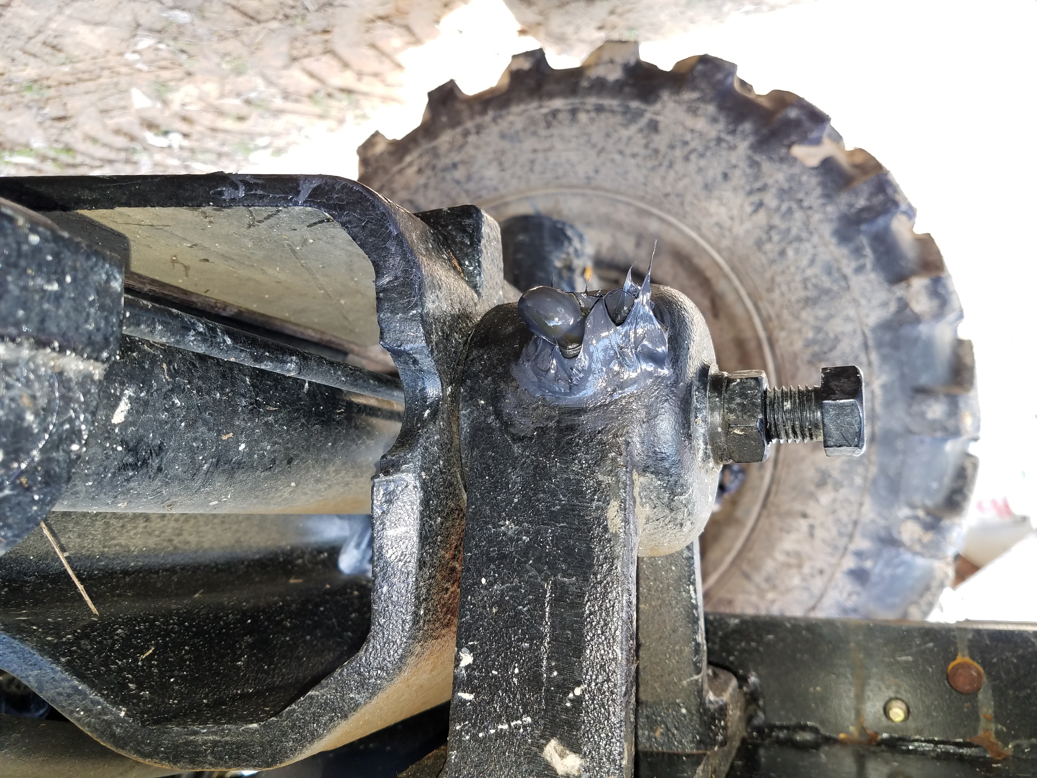

Here it is after I unscrewed the fitting..
   / Mahindra 2545 on sand #42
On the 4540 that's the front pillow block if I'm reading your pic correctly, I've never had a problem with ours. I clean all the grease fittings first and then grease everything with a locknlube.
   / Mahindra 2545 on sand #43
So I tried greasing the fitting at the axle pivot with the wheels off the ground. Same situation - wouldn't take any grease. I screwed the grease fitting off and grease shot out, clearly under pressure. Same situation as yesterday. I put the fitting back on and pressurized it again. I was expecting grease to come out from somewhere if everything was working properly.
Its good that you pressurized it again. Maybe the grease will penetrate as the pivot works during use. It seems to me that there must be an internal flow path that is blocked - perhaps by misalignment of a hole in the pivot bushing. I would want that assessed and corrected.
#44
I'm going to be really distraught if I have to carry this thing back before the 50hour service. Granted, I planned to do the 50 hour service myself..
So you guys are confirming that grease should be flowing through the pivot?
