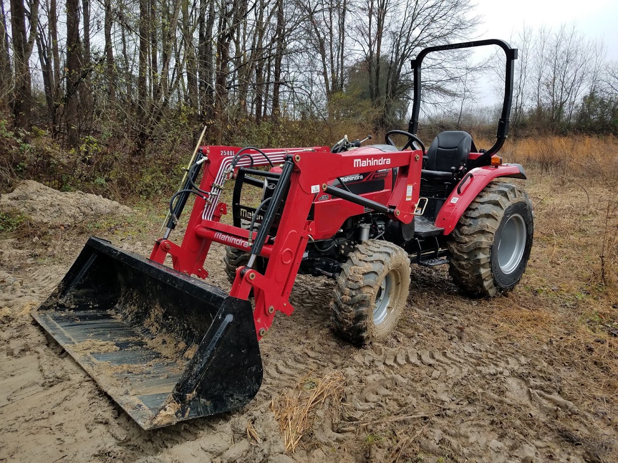

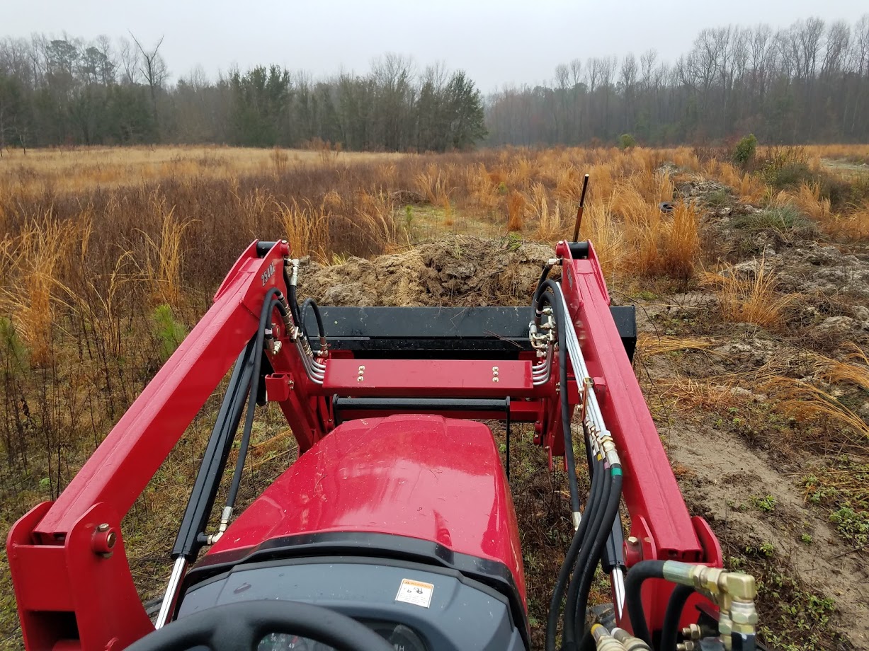

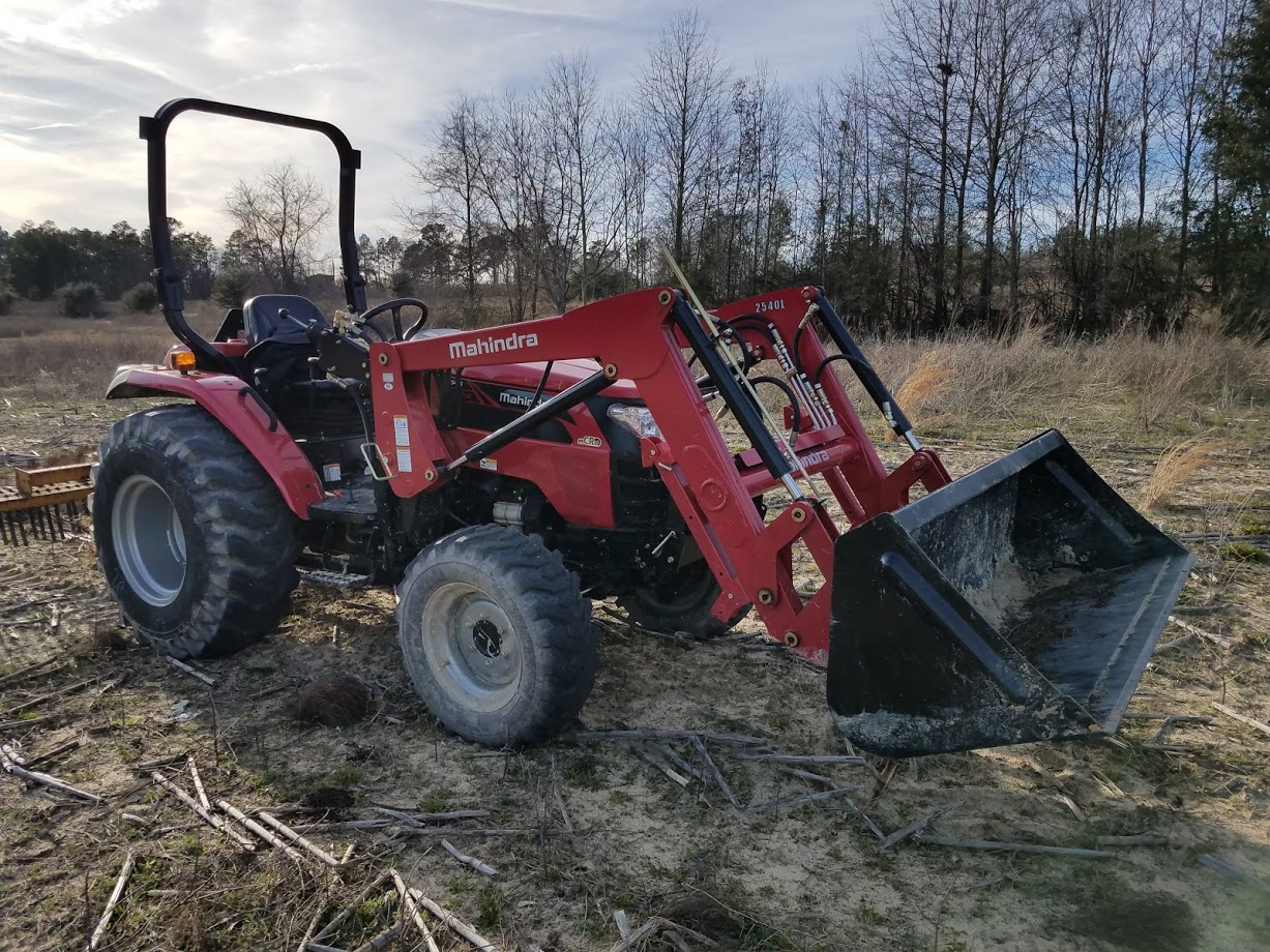

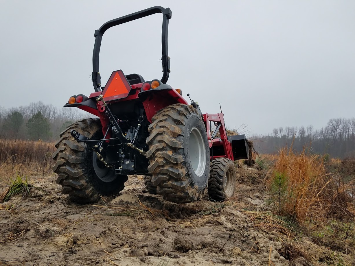

Since you guys like pics..
First hour with the machine. Digging out a little trench for drainage. Can't wait to try out the toothbar. Supposed to be here late this week.
First big load of dirt I picked up. Scared the mess out of me. I started backing up and the front left wheel dipped about 4". Rear right tire came up off the ground. Absolute panic for a moment there.
Had to see how far the wheel came up relative to what I felt on the machine. Since I filled the tires I've had larger loads in the bucket with no issue.
10 hours in. Raking up dead corn and leveling out what will be our yard.

You are breaking the #1 rule when using a loader!
USE PROPER BALLAST ON THE REAR OF THE TRACTOR!
Your loader manual will specify how much weight that is. Most just use a heavy Box Blade for ballast.
With no ballast, you risk damaging the front axle, and worse, rolling the tractor over and being crushed.
Please get some ballast on that machine.

Nice!
Hard to tell in the case of the ground compliance, but in the pics it looks as though the rears are overly hard for the application. Fronts have to be on the hard side unless theyve got a lot of water in them. The loads of various work with the overhung position of the bucket causes the fronts to often support huge loads - up to almost the full weight of tractor and bucket load (as in pic 3). The rears can vary a lot too, but the comparatively huge tire doesnt need near as much pressure to sustain a good profile. ... And there, soft enuf to provide some compliance with the surface will buy added traction and better ride.
Water fill gives you the opportunity to experiment all over the place.​
