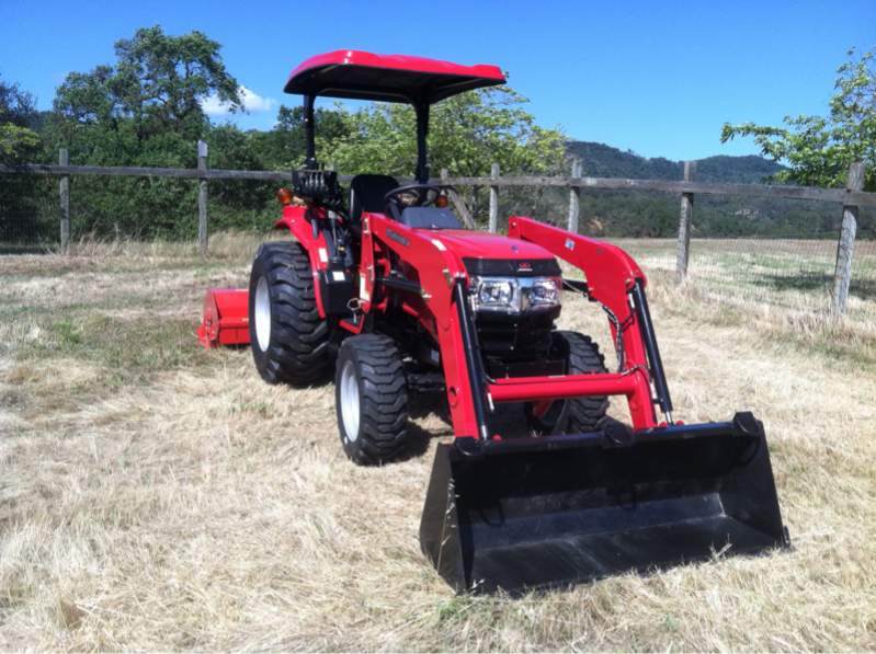

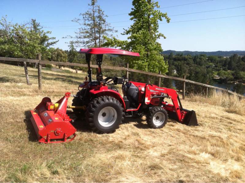

MtnViewRanch. Yep I'll get some pictures posted of my new equipment. I've got a couple pics here following my first two hours ever on a tractor. I thought I'd start with something simple like flail mowing the inside of an unused horse paddock. the grasses were about five feet tall and my first impression of the whole operation was how simple it was.
I don't have pix of the backhoe yet but I'll post those later. I'm really impressed with the layout and simplicity of the backhoe. My first time I was able to un-mount the BH from the tractor in a few minutes. Couldn't be easier. I'm very happy with the decision to buy the BH.
I made the purchase from Truck Tops USA (aka Campways) Santa Rosa. CA. They have been in business for as long as I can remember but are new to tractors. They went out of their way to make me happy and I believe I'll get good service from them going forward. What they may lack in tractor experience they make up for in customer service. I figure by supporting them and encouraging others to do so as well will ultimately serve my interests in the future. I want them to be successful as a Mahindra dealer which will add to the value of my tractor later.
The other, much larger tractor dealers in the area do lots of ongoing business with the vineyards and vineyard management companies. I'm just one person. And while the other dealers were accommodating to me I didn't get the feeling that my purchase made much of a difference to them. Going with the little guy I feel like my purchase makes more of a difference to their business. Hopefully that will equal more personalized service later.

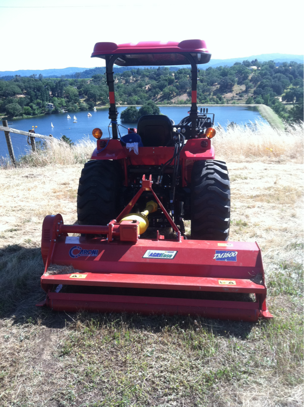

MtnViewRanch. I spent three and a half hours on my new rig mowing today. Tach now says 8.5 hrs. It doesn't get much newer than this. I can say that having top link hydraulics with the flail mower is really nice. I can make fine adjustments to the flail to get it to ride over an irregular surface perfectly.
