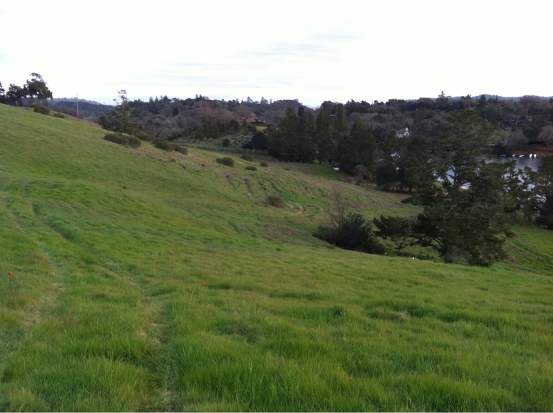

I'm attaching a photo of the acreage I will be mowing with flail mower. If you zoom into the photo look for the power pole in the distance as this will offer a good perspective on our slope which is up to 30 percent. This pic was taken a couple months ago. This grass is all 4 to 5 feet tall now.
The Mahindra 3016 has 28 hp from the motor and 23 hp at the PTO. I've been told the rule of thumb is 5 hp per foot for a flail. So is that engine hp or PTO hp? I'd like use a 6 ft flail but am concerned that it might be a size too large. Can anyone offer a comment on matching flail size to hp??

In my dumb days I used to look at engine horsepower more. Now I place emphasis on the PTO hp. My first impression, I think that a 6ft flail mower is a bit much for 23 PTO hp. If the grass isn't too high, I think the tractor could possibly handle it. I don't have a flail mower, but I can say the 2816 can handle a 5ft rotary cutter just fine.

Tires get filled to cover the rims which is about 75%. The only reason to not get them filled now is so that you yourself will know first hand what a HUGE difference it makes. You need PTO horse power for the mower, if you really want that 6' mower, I really feel that you should make the jump up to a 3616. Better to have to much than to be short on power and have to make smaller cuts. Either machine will work for you, but you will be happier with the 3616 IMO.

The 3016 and a 5 foot mower should be fine. I understand the over budget thing, but if by chance you are financing, how much more a month would it cost so that you would be able to use that 6 foot? That is a 20% jump in mowing width which equals 20% less time spent mowing. It sounds like fun right now, but after hours on in of mowing you sure wish that you could get done faster.

Here's some hp info for various size flail mowers. The power refers to pto hp, not engine hp.
