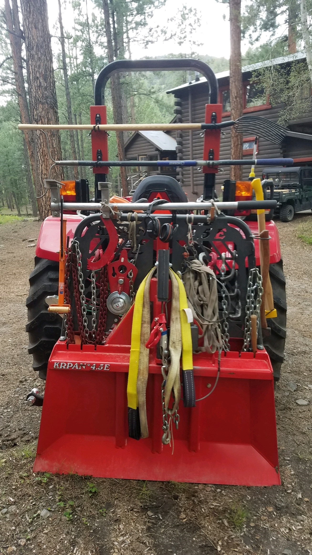

I had a 4550 for a couple years with no problems. But, for my use, I make mostly short moves - loader, firewood, etc., and the manual, non-sync gearbox was a total pain. Two years ago I sold the 4550 and brought a 5155 with the shuttle shift plus other improvements and it has been great. The capabilities are similar to the 4550 but the ease of use is so much better! It is a well thought out tractor. Highly recommend. For prices, look at Red Dirt Tractors.
