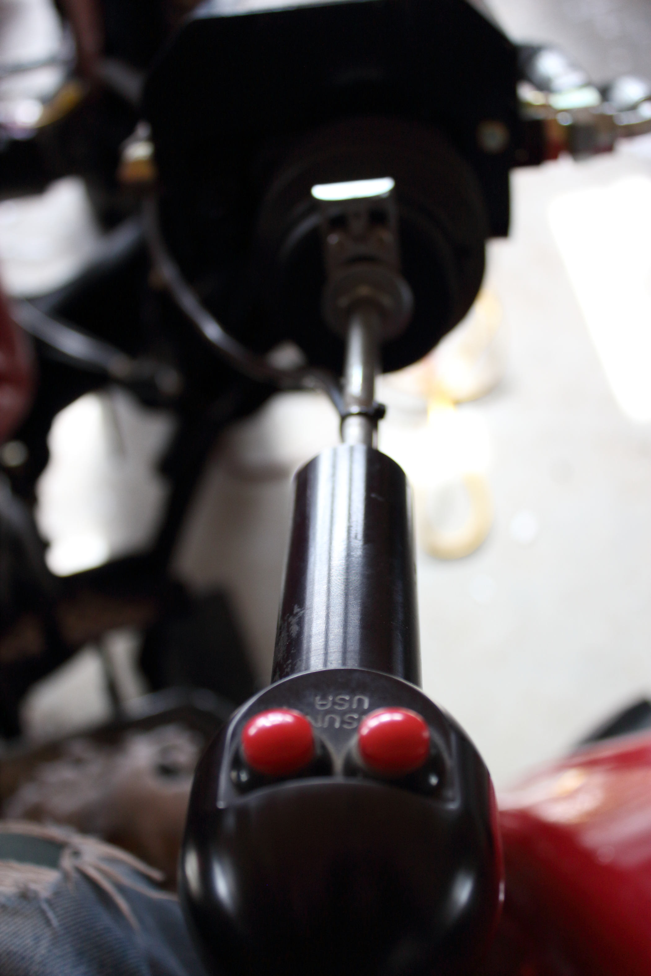

We had one installed on our 4540, from talking with the guy who installed it, the third function kit can be different depending on your model of tractor. Ours has two red buttons on it that we use when plowing snow, they angle the plow left or right.
Just some pictures of our setup, the last picture is the battery maintainer hooked up so you don't have to take off the grill.
