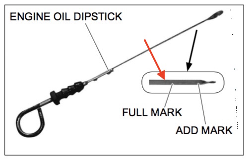

Day three.
Doing my duty.....going through all the pre-operation checks. Congrats Mahindra on the placement of the engine oil dipstick--not! Anyhow, after wrestling the side panel off, checked the oil 5 times (COLD) and the level is definitely a half-inch ABOVE the full mark. The red arrow shows the oil line:
Is this a problem? (I know with a car, this would be bad.)

it's bad only if you want the tractor to last a long time..

Looks like day 3 is a bust while I try to figure out if I need to do something about the excess oil. Saw quite a bit of difference of opinion on the many older threads about this issue.

Yep, this is what I meant by going around the tractor... although to find excess oil/fluid is (IMHO) unusual, especially as you've already been running/using the rig and the oil has had time to circulate into all of those internal nooks & crannies. Draining a bit off, then checking the level (cold and ensure that the tractor is on a level surface) won't be that much of a bother..

drain the excess oil, you never want to go over the fill mark!. the oil can foam up, and get air in it, which don't lubricate properly.. you can notice this effect quicker on an automatic transmission, overfilling that quickly makes it slip, as it quickly wears out..

Removing the oil:
Remove drain plug. Won't a lot of oil come pouring out?
Remove oil filter, dump oil and replace. Same concern as above.
Couldn't I just unscrew the oil fill cap and use a clean, new turkey baster to suck out the extra oil?
Also, given it takes 4.4 quarts of oil total, given the 1/2 inch extra, are we looking at around 1/2 quart extra?

Yes it had run for about an hour the first day. But was cold and level when checked, 2 days later.
Just talked to dealer and he says they normally fill 1/4 inch above full line because new diesels will burn a little oil during break-in. He is going to call me back.
