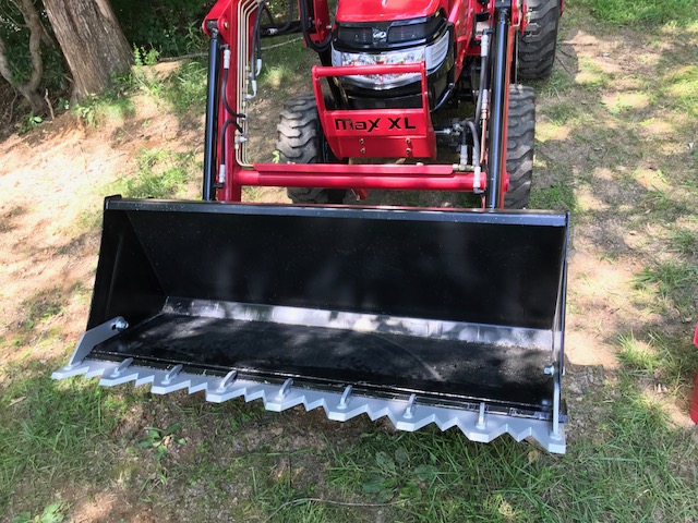

Day 9. Fun with the FEL
My Piranha Tooth Bar (PTB) came 3 days ago, and today was the day to put it on. I opted for the stepped drill bit too and was glad I did. Pretty easy job really. So here he is with a new toothy grin:
So time to try it out on my mess of a fallow garden full of random compost piles, and very happy weeds. Goal was to move the piles and scrape the surface all into one nice neat compost pile. I've never operated a FEL before so it's a steep learning curve so far.
The tooth bar cuts through dirt like butter. In fact I accidentally sliced about the top 10" of soil off and had to put some back. :) They ought to be OEM.
With moving materials, just like with fixing a driveway, you need to have a plan. So AFTER randomly moving stuff around and making a worse mess than before, decided to move the compost pile to the side so I can drive in one end of the long, narrow garden and drive straight through, then turn to the left, dump stuff, and then circle around back to the beginning.
It is shocking the amount of materials this tractor will push with the FEL in float, or pull behind it. SO FAR it has never failed to have enough power. Sometimes it feels like too much. :)
Fluid Film was much in use today. Really good stuff; makes pins and everything move so much easier. Was pleased to see it actually gets rid of the existing rust too, which I didn't expect. Also non-toxic: win-win-win.
Def will have to concoct some kind of bucket level indicator. That will be a fun project.
