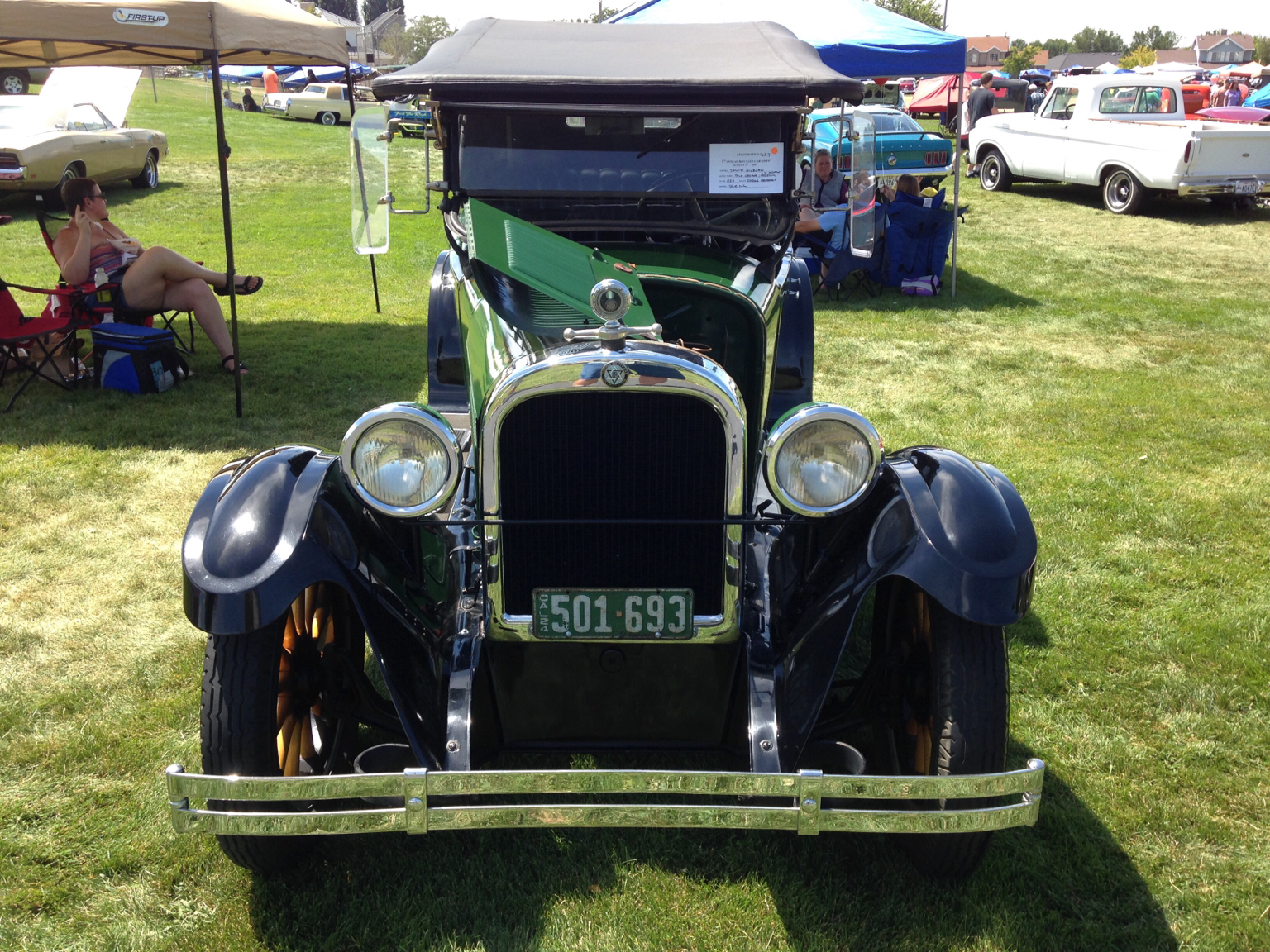

You probably need to post a picture here of that 24 Dodge Brothers rig. Those are cool.

Here it is at Arches NP.
A random car show.
