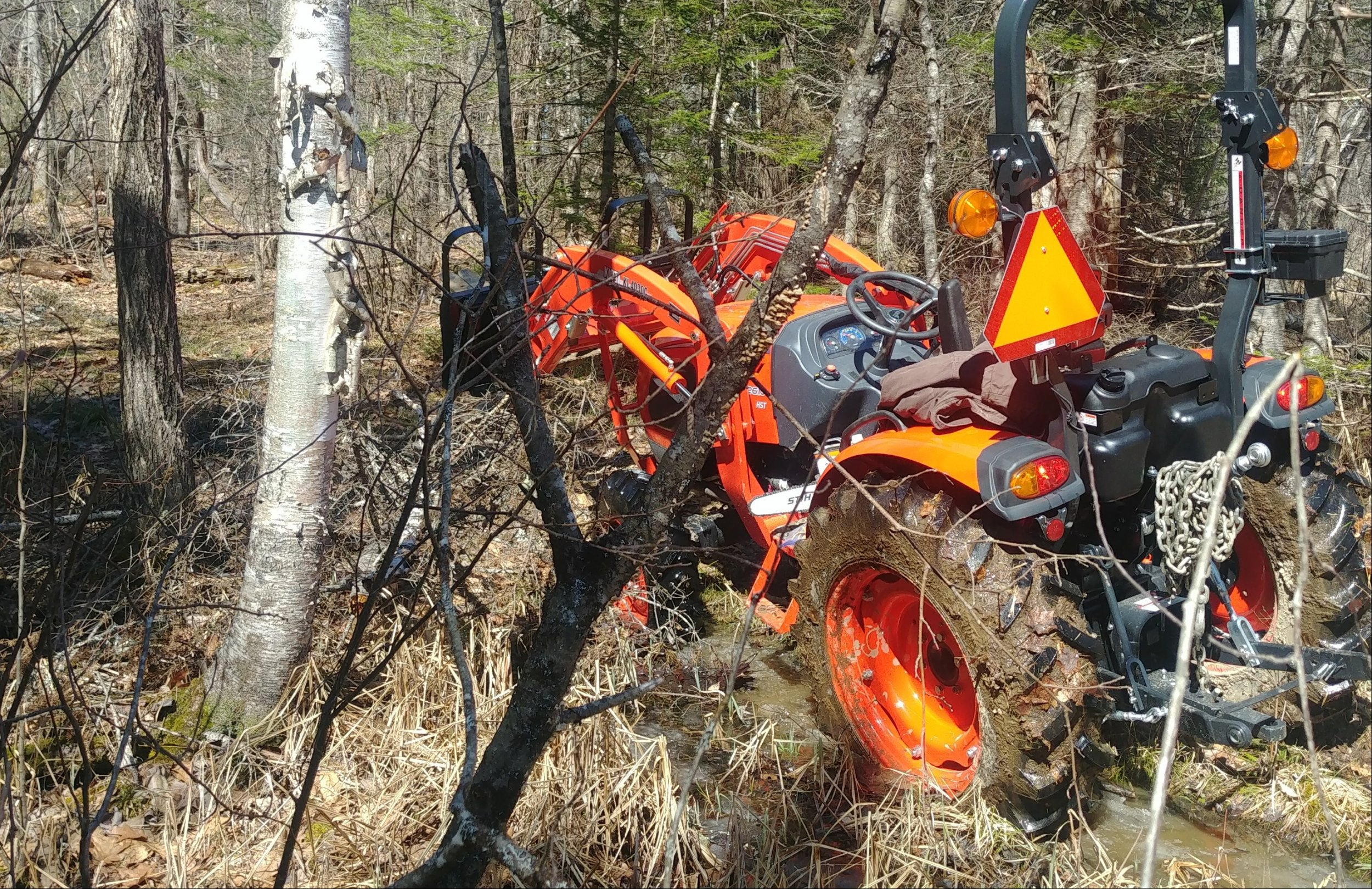

I discovered something else to have in the toolbox today... Tire plugs/rubber cement. The three inch nail was in about a half inch, give or take.... No leak. And they are loaded. Can you plug a loaded tire?
Got 20hrs as of today. The only issue I'm having is keeping the back tires on the ground. It's very uneven where I'm working.
