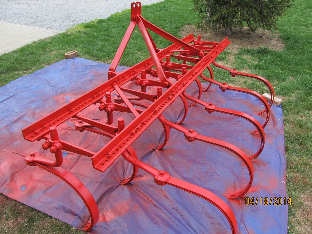

Here's a photo of New Holland Red--1950's red--acrylic enamel on an old beat up piece of farm equipment. Look at the depth of that color and the shine. And it will stay shiny.

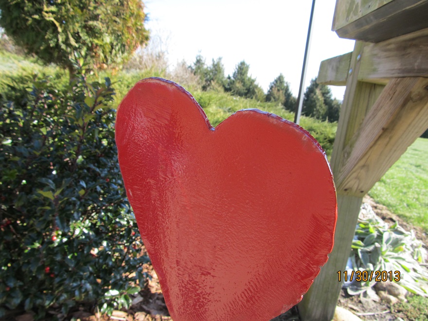

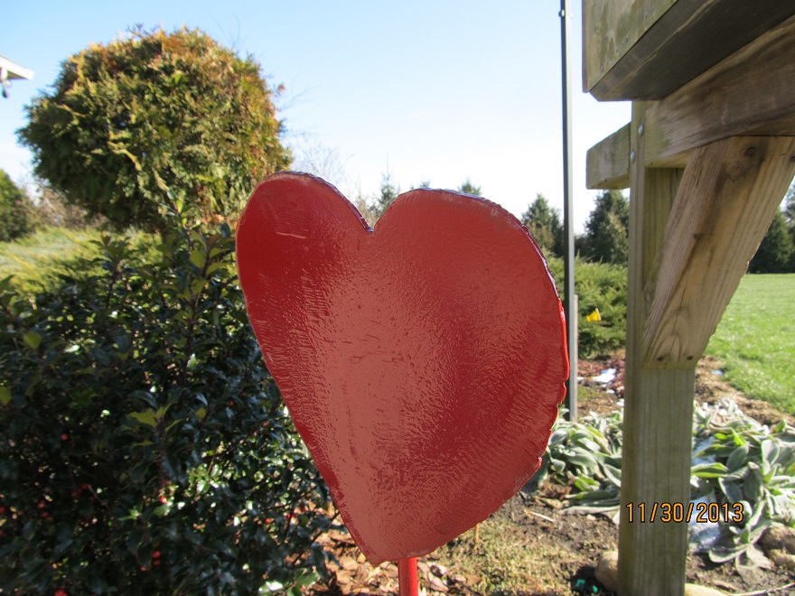

I cut out a piece of plate steel and painted--no primer--it about six or seven years ago. It almost looks like the day I painted it and remains shiny and perky.

I'm not sure how long ago I painted this with the Case IH Red but it was probably five or more years ago and has been outside in the sun and elements ever since. It looks almost like the day I painted it and whatever it is it's great paint and stays glossy and hard.
