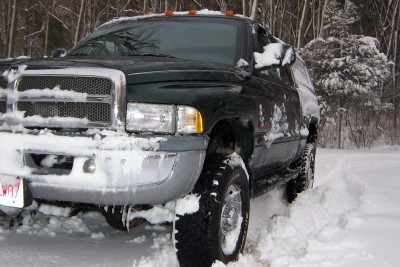

An update... After a lot of great advice here, I had the truck fixed. Thanks all for the input. It definitely made me think about what I had and whether or not I should fix the truck. Anyway, I had the axle work done, about 3-400 cheaper than the original shop too! While the truck was at this new shop, I also had the dowel pin secured and a new exhaust (already had in possesion) installed. Truck came home two nights ago and runs as good as ever...
Here's a picture of the truck, having just finished rolling up the driveway thru about a foot of snow, with no problem... (we had a storm today, yea!).
Thanks again for all the feedback! -Art
p.s. The exhaust is a new 4" mbrp. Very good, I recommend....
p.p.s. if anyone needs a good diesel truck mechanic in eastern MA, send me a PM, I have a great recommendation.

Sounds like it might be a keeper. /forums/images/graemlins/wink.gif

Congratulations Art,
Sounds like you got things straight.... Enjoy....

Thanks, guys! Yea, it's good to have the "truck of your choice" back. I had a lot of stress trying to figure out if I was going to get another vehicle, and what exactly that would be ! /forums/images/graemlins/blush.gif But, now I don't have that worry /forums/images/graemlins/cool.gif
